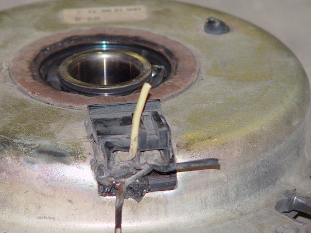

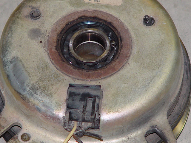

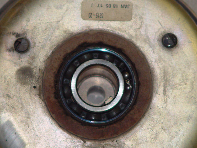

With that in mind, I'm in a quandry as to the best method for mowing my property. My 5' rotary cutter is too cumbersome to work around these obstacles, so I have a JD L130 lawn tractor that is more maneuverable than my CUT and brush cutter. However the L130 (Box store grade rig) or "L"emon 130 as I call it has been a disappointment. I don't expect CUT durability; but geez I only have 56-hours on the clock and I'm on my third mower deck belt, third set of blades (can't blame Deere on this), replaced a broken idler pulley bracket on the deck, and now I just put in a new PTO switch and clutch. The clutch fried itself and the PTO switch when the ball bearing retainer cage mangled itself causing the clutch to seize while mowing. The bearing dirt seal fell off when I removed the clutch (see pictures).

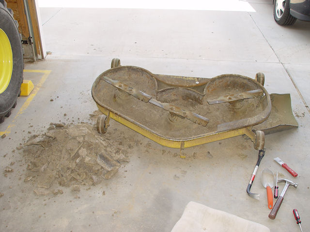

The other picture shows the underside of the mower deck and the last batch of claycrete/vegetation mix I chipped out of the thing. The ground cover isn't lush like a lawn, so a lot of the talcum powder fine clay dust gets sucked up into the deck and mixes with the vegetation and moisture to form a poor quality peat like mess. Green tumbleweeds are highly efficient at storing water, so they add a lot of moisture to the mix. Putting in a lawn is out of the question due to our climate and high water rates. A friend of mine says the deck looks like it saw battle at Normandy on D-day.
How often do you clean the machine and under the deck? And how do you usually clean it?
Personally, I clean both top and bottom of any mower I use with either compressed air or water after every use. If I use water, I then run the machine long enough afterwards for it to dry itself.
I hose it down after each mowing that gets the easy to get areas. This year I put three of Deere's wash ports on the deck, one for each blade. Deere recommends one-minute of water through the wash port with the blades running at full throttle. I usually do 2-minutes per port at full throttle with the deck in the lowest position to get maximum pressure differential. I then run the blades at full throttle for a couple more minutes to dry out the underside.
I do this routine half-way through the mowing job, and once again at the end. The wash ports work better than expected; but it would be nice if they would hook up to a pressure washer, which I think would help more than anemic 65-PSI house pressure.
Also I keep the discharge chute open to get as much debris out during the mowing session.
