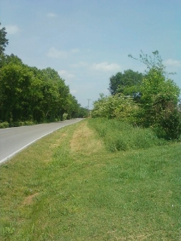

Thanks for the response. Below is a pic of the ditch. The county cuts the left side of the ditch (by the road), and you can see where I made one pass on the right side of the ditch. You can also see where I need to make another pass or two up to the fence line.
Maybe it just feels steeper than it really is.

From the picture, it doesn't look all that steep. I assume your 8N has no ROPS or seat belt, that takes away from your safety.
If you go at it again, just remember to turn downhill if you think it is feeling tippy.
Better safe than busted up.

The 8N is about the best there is for slopes. I'd take it on that slope in the pic no problem. Still follow your seat instincts. Keep some 3 ph lift on the deck to take advantage of the mower weight and you will be fine. And the "turn downhill" is good to keep in mind. Using the individual brakes at the right time for traction works as the uphill wheel will slip/spin if there is too much tilt. Just if you have to use the uphill brake to stop a wheel, it is time to turn downhill (and it can be done) on the slope. If you keep traction, you don't have to worry about tipping over.

From your pic, and assuming the angle doesn't appreciably steepen anymore than that, then I'd be fine with it.
I've done a lot of shredding on the 8n or NAA over the years and more often when cutting on a slope I've experienced a sensation of lateral, downhill slippage more than a concern about reaching a point at which the tractor might tip over.
My rule of thumb is that, when on a slope or angle, the point at which I don't feel I can control the tractor completely is the moment I know I'm working on something too steep or angled. With that said, as stated above everyone's internal danger meter is a little different so if you're not kosher with it then maybe it's not a good idea to force it.

Most states declare 3:1 slope as the limit for wheeled equipment to mow.
2:1 is the preferred design slope for new installations that mowed.
if its a 2:1 or less, you may just need some time to get used to some side slope work. If it is closer to 3:1 you might want to find another way to maintain it....
perhaps a sickle bar mower, or other kind of offsetting mower... perhaps a string trimmer if its not 1000's of feet.

That slope looks ok to me. However I agree that if you feel spooked, it is better to step back, and regroup. Being to nervous can get you into trouble. I teach new Locomotive Engineers how to run trains from time to time, and the ones who are too nervous are the ones that scare me the most. If I were you, I would keep mowing your place with the 9N, and at some point you will get more experience, and feel much more comfortable trying that slope.:thumbsup:

It doesn't seem that bad from what I am looking at , but its you not me::::::::)))))))))
Try cutting on a long angle instead of cutting with the slope. it may help get over the "spooks"
Sure hop you have some sorta of roll over bar , an or seat belt.Weighted tires will help alot.

THat slope looks easy to mow, but if you are concerned, straddle the center and make a pass then mow the rest. Unless there is some deep wash right in the center where the grass is hidding the bottom, it should not be a problem to mow. You might also try mowing it with a riding lawnmower with less wheelbase, the amount of tilt wont be as bad.
As suggested to measure the part with the deepest trench by laying a straight edge in the ditch then pulling a level line across it. Measure the full width of your tractor wheelbase and then if you have 2 feet of travel across for every 1 foot down you will be good> That should equate to 22.5 degrees slope which is easily mowed if you take it easy.
