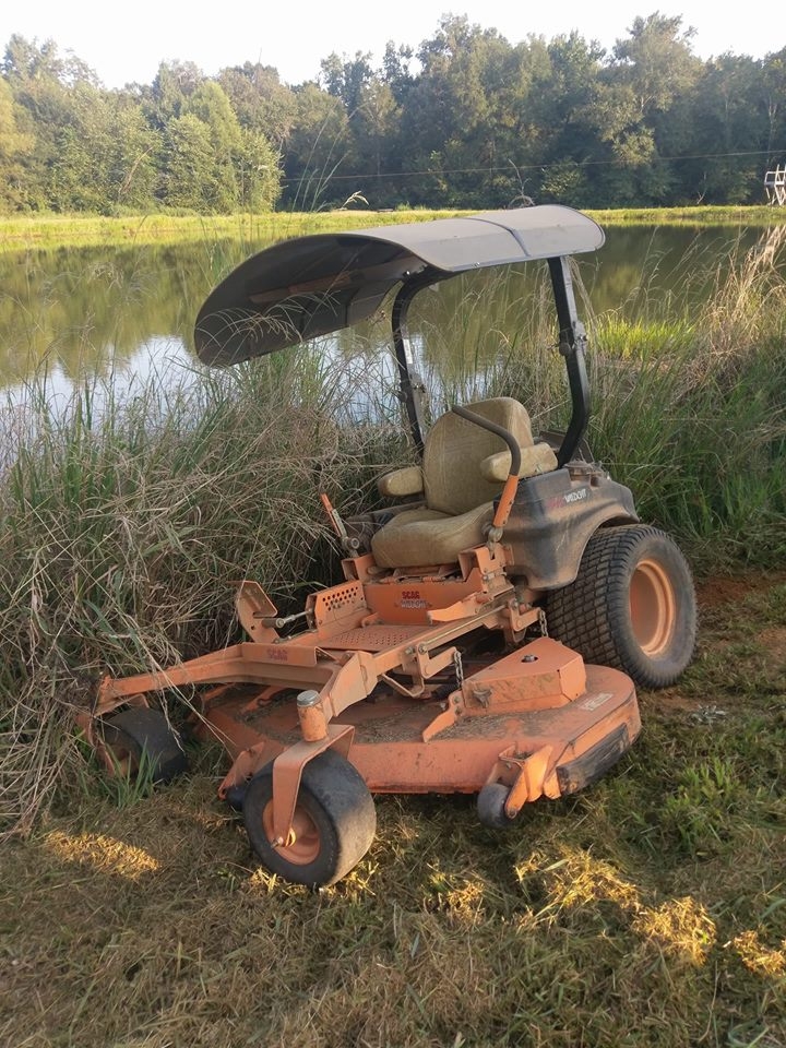

For the past ~10 years I have been using my Ford 1620 HST 4x4 with 60" 914 deck to mow about 7 acres. I'm at the point now where I don't look forward to mowing due to many mower deck breakdowns (tractor is great) along with the the time required to mow all 7 acres. It basically kills one whole day of my weekend. I think the top speed of the 1620 in MED gear (fastest I can go due to blade speed and cutting) is something like 1.5 mph.
I have been hesitant to get a zero turn due to the fact I have a decent strech of mowing along ditches & pond banks (~1200ft of pond banks, ~ 1000ft of ditches), where sometimes it can be a bit wet. I have never gotten my 1620 stuck to the point I needed another piece of equipment to pull it out. The rest of the mowing is very flat.
I have been looking at thie Ferris mower: Ferris 5902073
I assume my cutting time will decrease, but it also seems like I am going to not be able to cut some areas, especially on the steep ditches?
Look into a flail mower. You can get one that tilts, so its easier to mow banks. Also, you can go faster if terain permits.
