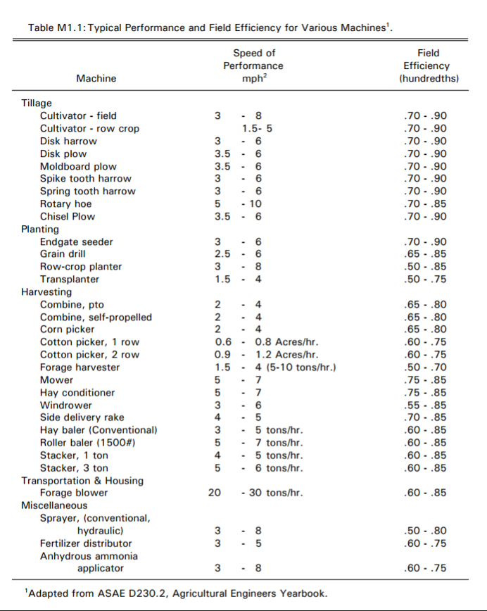

Don't know how accurate it is but this is what I used Mowing Calcuator | How many acres can I mow in an hour
Theoretical field capacity (acres/hour) is calculated as width (feet)*average ground speed (mph)/8.25. This assumes 100% efficiency and does not allow for overlap, turning, refueling, etc.
The linked calculator assumes 90% efficiency. That's too high IMO. https://www.exmark.com/Exmark-Advantage/Mower-Productivity-Chart assumes 80% efficiency and is more in line with real-world situations.
A quick-and-dirty calculation for actual capacity (acres/hour) = width (feet)*average ground speed (mph)/10 assumes 82.5% efficiency.
For reference purposes, here's a listing of estimated efficiency factors for various machines from http://caes2.caes.uga.edu/engineering/handbook/documents/capacity.pdf.
Steve
Thank you Steve. I used the calculator as a reference. Then I went out and mowed with the Exmark. Every time the blades were spinning and I was actually cutting I turned the timer on. When I stopped, for fuel, water, etc, I turned it off. It was exactly 5 hrs 12 minutes. Then I went to Findmylotsize.com and used this to calculate the exact (as close as possible) number of acres I just cut. This is a great tool for those of you not familiar with that website. Using the two variables I had, time and acreage cut, I was able to determine the approximate speed.
