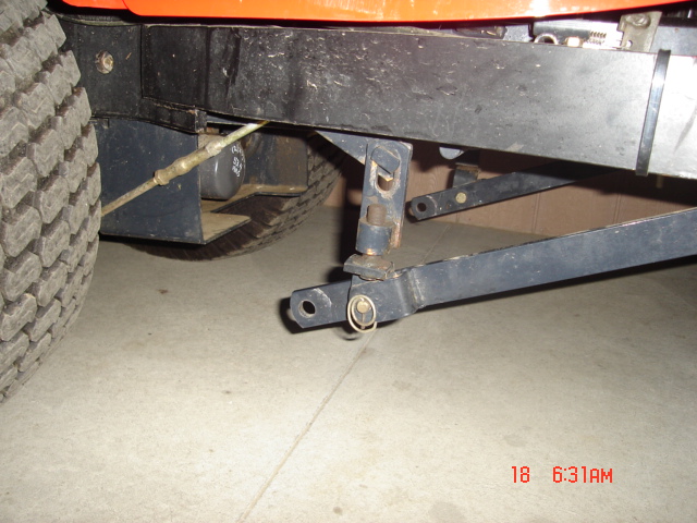

Don't know for sure, but mine pitches somewhat as well. Still have the snow blower on so I can't check! Grass is beginning to turn green, but hasn't started growing yet.
Here's a pic of that adjustment point, though it sounds like you've got that set up now (couldn't find it earlier)--View attachment 602378
Yes I started there but then had to do the main adjusting for the stop bar because when my deck was at lockout I still had about 3/4" between the deck and the stop bar.
So I went over all the adjustments I thought we needed.
