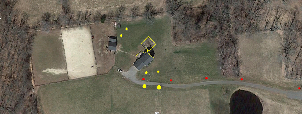

Here is a picture of the property...the yellow dots are the small trees and the red dots are light posts.... The only thing I thought of really was that maybe I am able to carry a string trimmer on the ROPS so when I get to a tree or something, it is quick/easy to hop off, trim around it close and then mow as opposed to trying to do it all with the mower. The only tight area I have really is between the garden (yellow outline) and the house and the porch. Other than that its the trees/lights that I need to get close to (they are all small trees) and going along the garden's fence.

Doesn't look all that bad. I mow with a 62" deck and have trees and tight spots I can't mow. I have a push mower and go out and trim after I mow. More work than I'd like but I don't want to spend additional money on a zero turn.

My father spent years working on the landscaping, all the while making sure that everything he did made mowing easier. By the end, he could mow the entire lawn without getting off the tractor, barely any backing up, and he gave away his push mower and string trimmer. Make sure that you have at least a mower's width everywhere you need to go (you may need to adjust the landscape to make that happen), then border all the landscaping with rock (or whatever you like) and spray the edges with roundup. It will look really clean and the little roundup'd border means no trimming.
