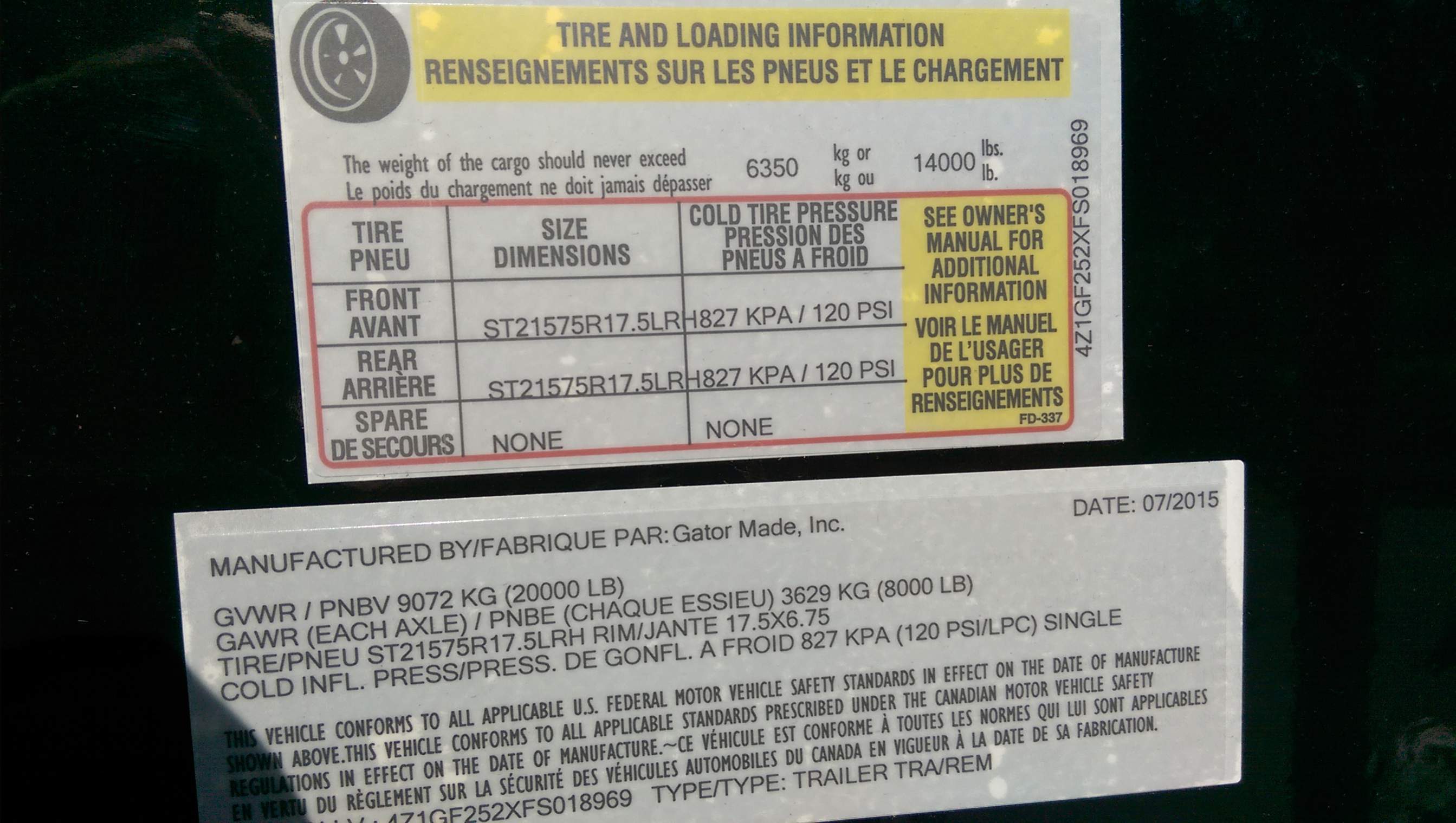

#12
BobG...
Tires are loaded putting tractor, loader, and cutter in the 12,000 lb range... This is a 20k treated trailer... I'm not over and I have almost 2k lb cushion right now.
Trailer weighs about 6,200... It's states on trailer I can put about 14,200 on trailer somehow... Not sure of their math.
   / mPower 75 delivered today
#13
How much does your tractor weigh? I'm guessing you were right at the upper reaches of the trailer's weight capacity. Do you have the rears on the tractor loaded? BobG in VA
I know everything doesn't weigh 14,000 lbs so I feel good about it.
   / mPower 75 delivered today #14
I didn't realize you had 8K axles...I've got a 24ft GN (Delta trailer) with 14K gross....the trailer weighs 4500 lbs so I can only (safely) haul about 9500 lbs... my 6000 with FEL and rear loaded tires weighs right at 9200 or so... I've also got a 511 BackHoe..which, by the way, you should look into... great units....I pull mine with a '99 F350 with the 7.3L diesel. I like my trailer....but I love my truck. BobG in VA
   / mPower 75 delivered today #16
You can put that much on the trailer because some of the weight is transferred to the towing vehicle axles. Nice looking set up!
