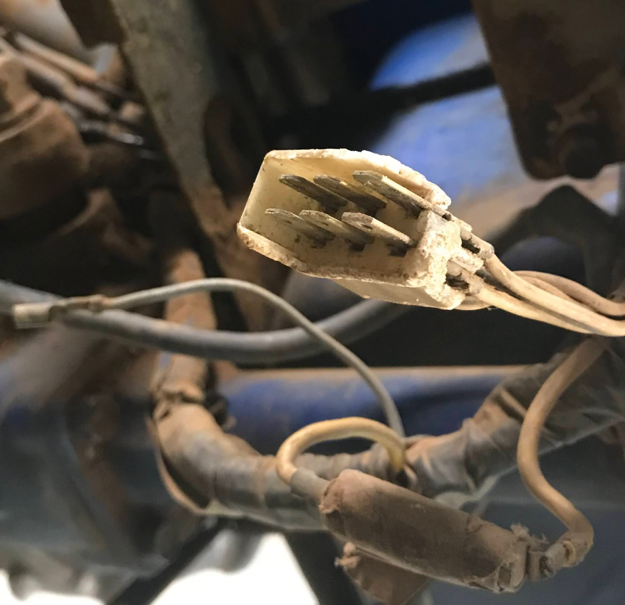

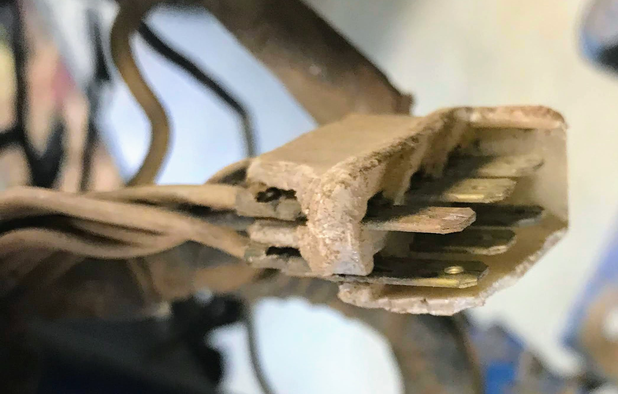

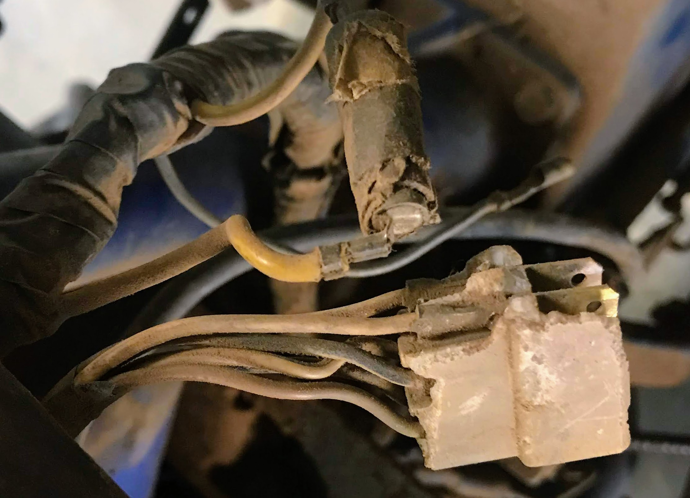

well I guess I will have a spare regulator. 😆 The light would come on when the key got turned on and went off when the engine started. It did come back on when the key was turned to off with the engine running. Could it be a burnt contact? Doesn't really look like it. I know the connectors at the alternator and the regulator don't look good. I could check the wires for a break I guess. I know it is boiling the battery if I leave the key on when it is running and lugs the engine horribly. So what would keep that from being energized?
"the connectors at the alternator and the regulator don't look good"
Had to replace my connectors, too.
Wish I had replaced them before they shorted and burned.
   / MT 372 dummy lights #53
the wires were broken at the connectors and this is the first I have noticed the problem with the lights and charging. I will give this a try tonight when I get home from work. Is there an easy way to get the female spade out of the plug? I had a hard time with this on the one I replaced.
Had to replace mine, too. 40+ years old.
Wish could have fixed before they shorted out and smoked.
