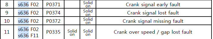

Well fellas. Looks like my good streak just ran out. Was plowing and got the beep. Caution and stop displayed. Error code f02 s636
   / MT 573 Issues #42
That appears to be a Crank Signal Early fault, lost fault, missing fault, or over speed fault. I've attached some screen shots from the service manual. Hopefully its just a loose wire or sensor, or bad sensor.

Crank sensor failing is pretty common. Part # 40511370. Easy fix and falls under 5 year emissions warranty.

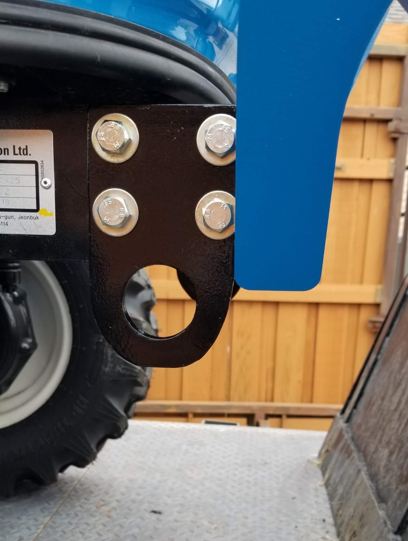

A while back I took some 1/2" plate (I think its half inch, don't really remember) scrap I had, cut it so it would hang down a bit from the frame, drilled some holes in the plate to match the ones already on the frame, and then welded some D-rings to the bottom portion. I did this on both sides. This is where I typically keep a chain, and where I tie the tractor down to a trailer.
I did similar, I made these out of some scrap 3/8" steel I had. I have ratcheting straps with safety hooks that snap right on quick and easy.
