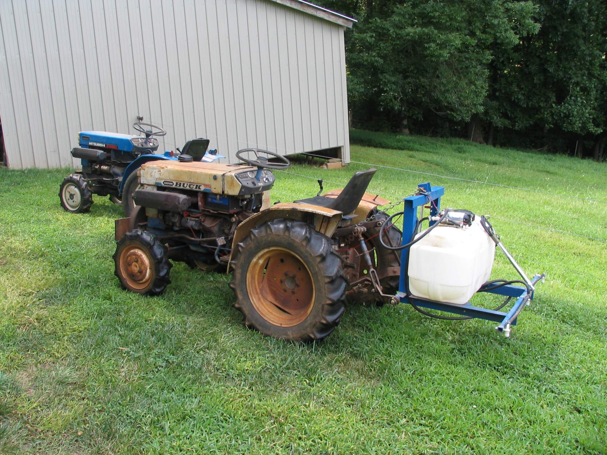

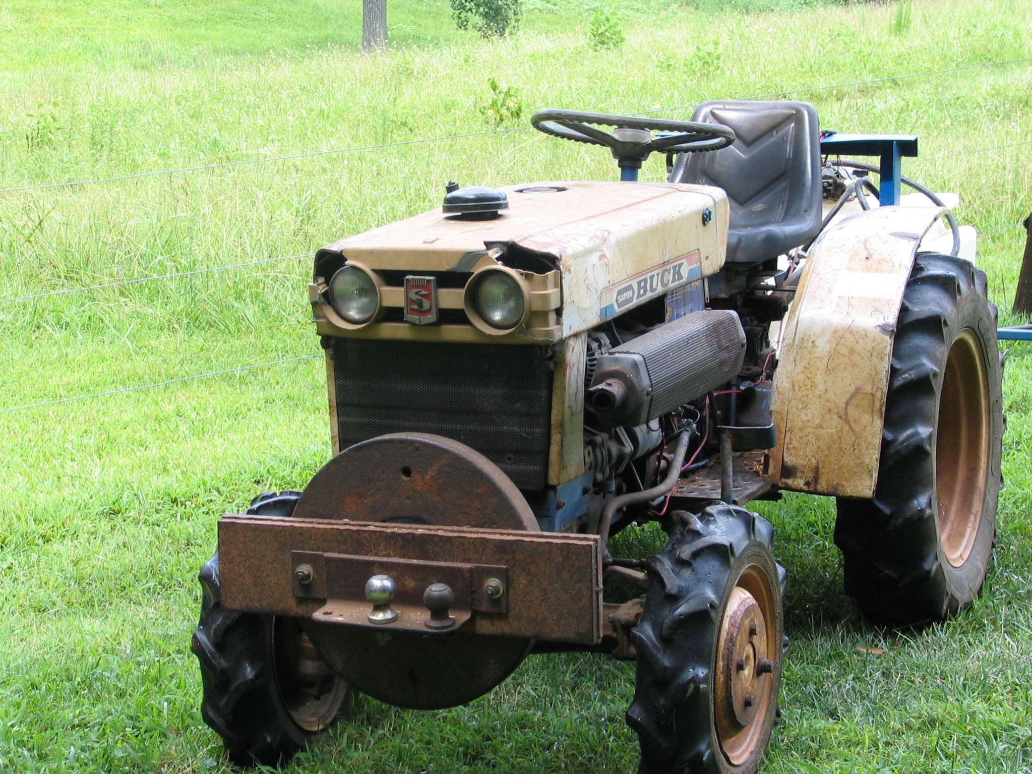

You may need a bigger tractor, but I never cease to be amazed what my little Beaver can do. Even though I've abused it for 30+ years and haven't always maintained it as I ought to...
Having a second tractor with some ability is always a plus. So buy that larger machine and keep the little Mitsubishi. :D
