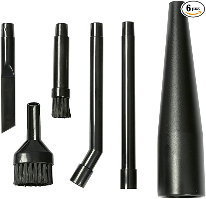

Amazon.com: WORKSHOP Wet/Dry Vacs Multi-Fit Wet Dry Vacuum Accessories VT1215 Vacuum Micro Cleaning Kit Vacuum Attachments For Compact Wet Dry Shop Vacuum, Black, 1-(Pack),6: Home Improvement
I bought this and use the cone shaped adapter, worked great, it doesn't go in far enough to suck any oil out, and it fits the filler hole nicely!

In my case my shop vac hose was larger diameter than the fill port and went around the outside of it, it wasn't down inside the reservoir and it still managed to draw fluid out. Not sure what the perfect solution is. Maybe some sort of vacuum limiter port on the shop vac hose or maybe I need to do it when the filter is much dirtier and it has less vacuum. :)
