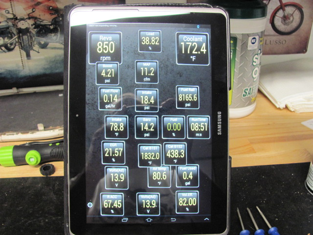

Mine pretty always stayed at 176 no matter what I was doing. If it were to get hotter I'd check your radiator screen.
I found OBDLink to be a great app for the LS but you need their connector I believe. You must be using Torque?
Is your boost reading at 2400 with no load? It will be higher with a load. Also your true boost won't be discovered until you go into regen because your EGR is contributing to the boost under normal operations.

Good to know about the coolant temp since it seemed a little low.
Yep, using Torque Pro. Use it on my automotive vehicles for troubleshooting error codes. I've got a generic ELM bluetooth device to talk to it. Boost reading was at PTO 2400rpm speed no load. I was just looking at what parameters were being output. I've attached a screenshot of everything that it output on my device.
