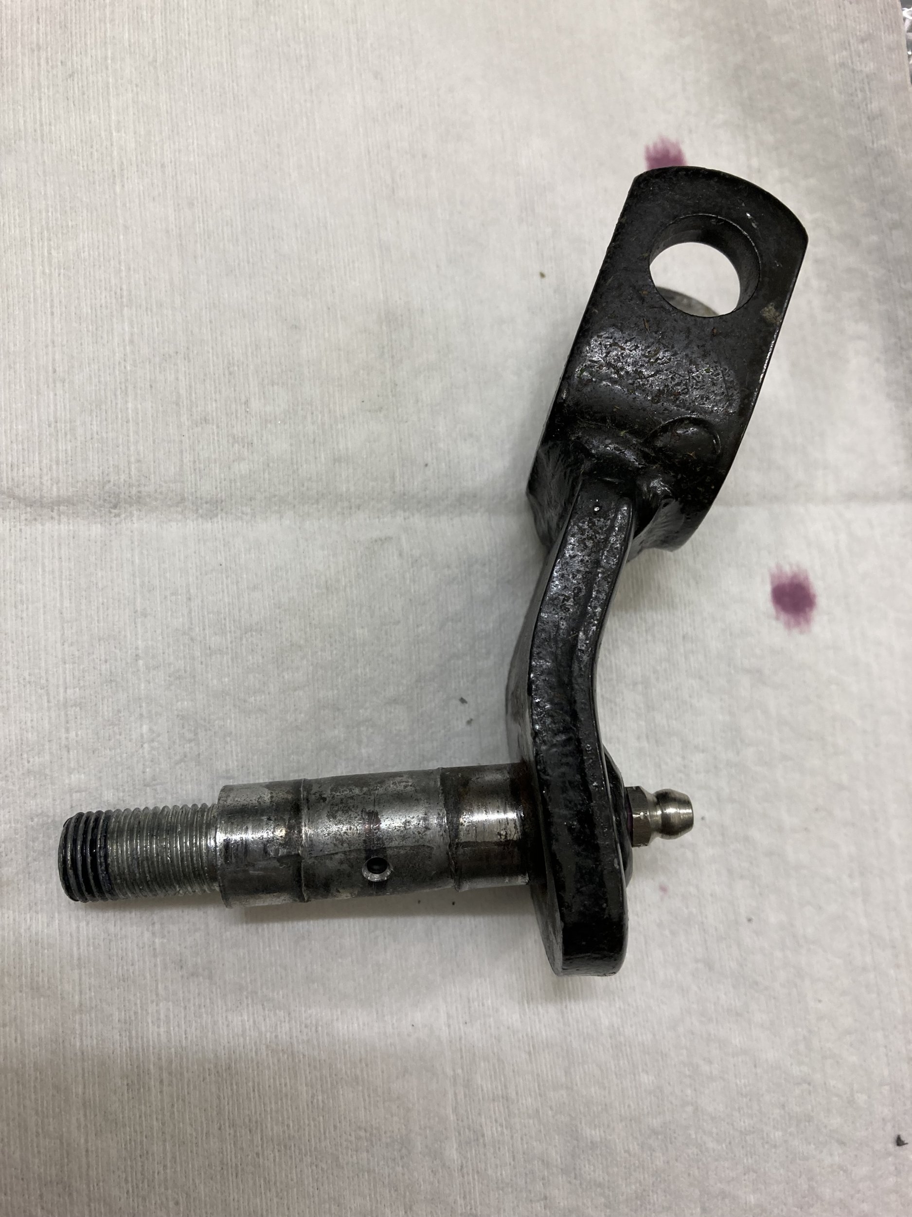

Here's the part I originally bent after I straightened it out. Note the wear pattern on the center of the pin. More than I expected for the low hours on the tractor using the 3pt. I decided to drill the holes necessary to install a grease zerk to hopefully lower the wear.

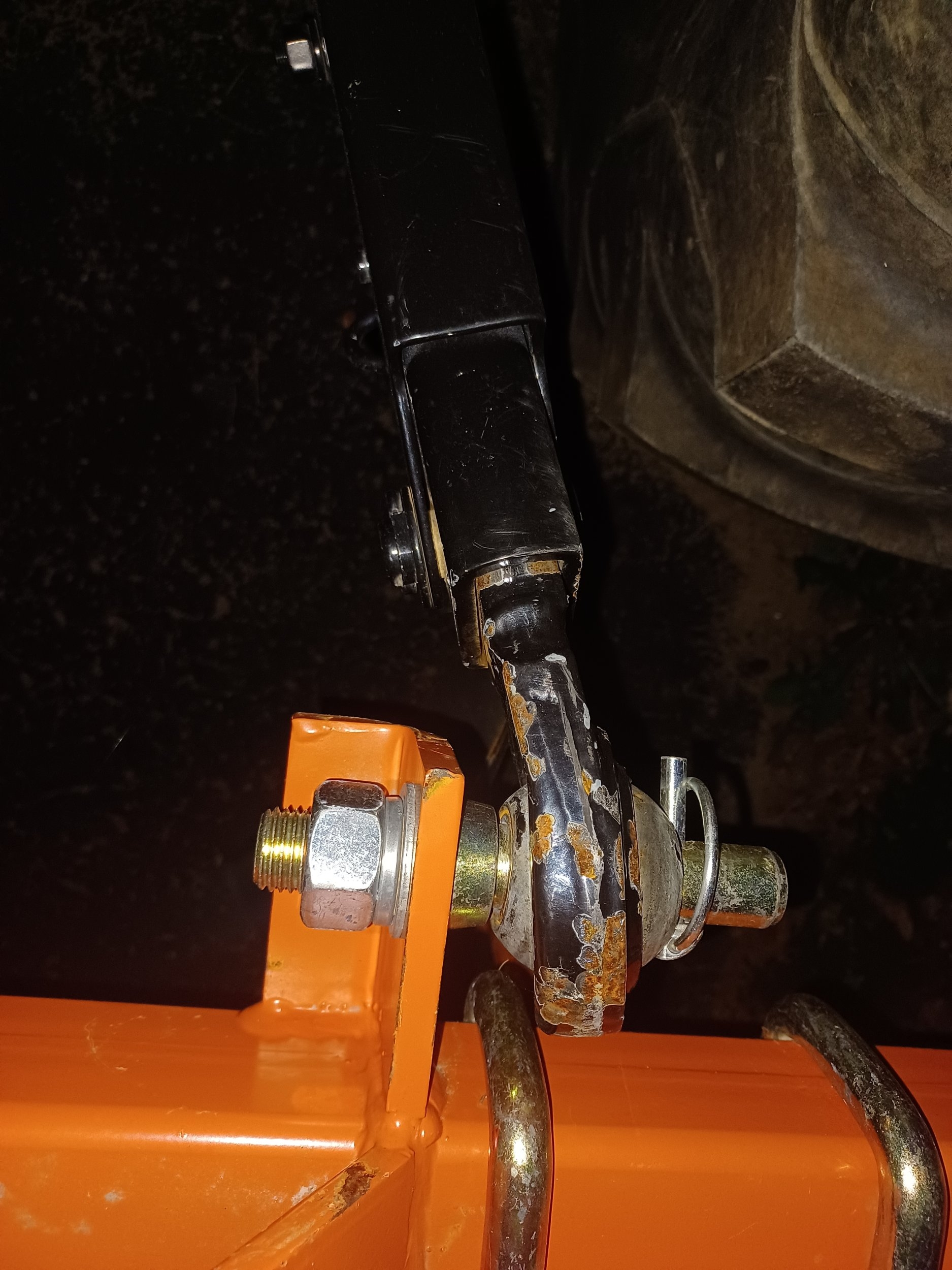

I thought your bars look different than mine so I went out and took a pic. Looks like my bar ends are beefed up as you can see there is a steel square tube they are inside of. I have a similar size 72" rotary cutter that I beat the crap out of doing brush 10' high.
Here's what my arm looks like
   / MT357 bending parts on 3pt #17
Here's what my arm looks like View attachment 810339
Those are the lower/draft arms. The OP is talking about the telescopic stabilizers.
