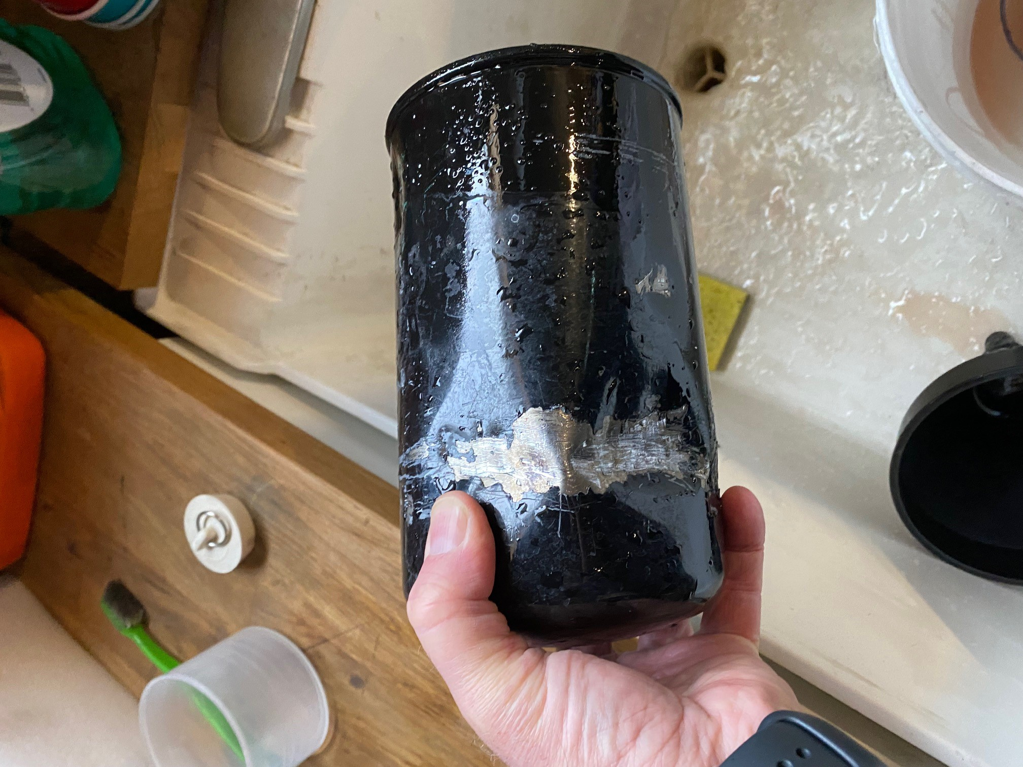

Well I crawled under my tractor. The HST filter is quite a bit smaller. But my more pressing problem now is that I cannot get the hydraulic filter to budge. My biggest wrench isn't big enough to get any real leverage.
What do you guys recommend I purchase for removing large hydraulic filters?

Normally, the first filter change is the bear. Being painted and installed without obvious gasket lube makes removal difficult. 15" channel-loc pliars got-er-done!

Check my thread on my 50 hour service. That filter will come loose if you step on the wrench from the outside. Get ready for the fluid gush, so have the new one ready to go immediately.

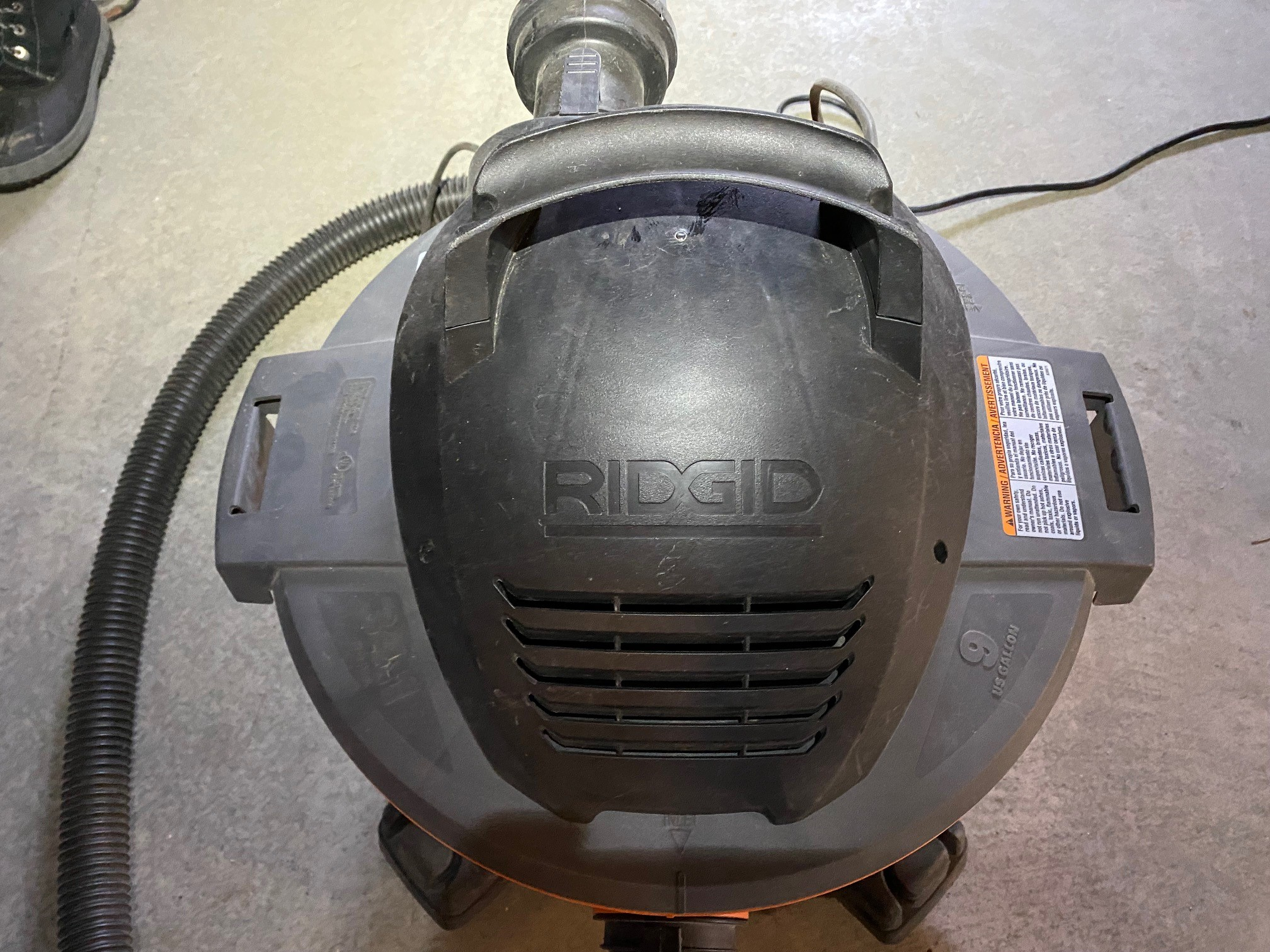

The vacuum trick worked great for me but it takes 2 people, one to loosen the filter and one to operate the vacuum.

All the original filters were difficult to remove, I bought steel strap type filter wrenches from Fleet Farm and felt lucky to get the filters off without smashing them, that would have been a big mess.

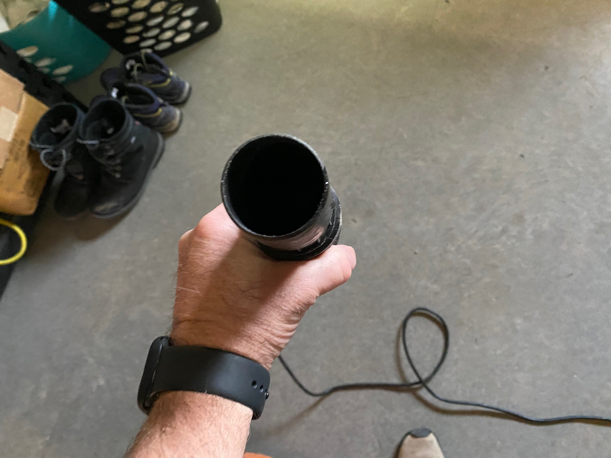

I used a small 18v shop vac and that was enough to create the vacuum and no fluid lost.
The small hose holds itself on the filler neck.

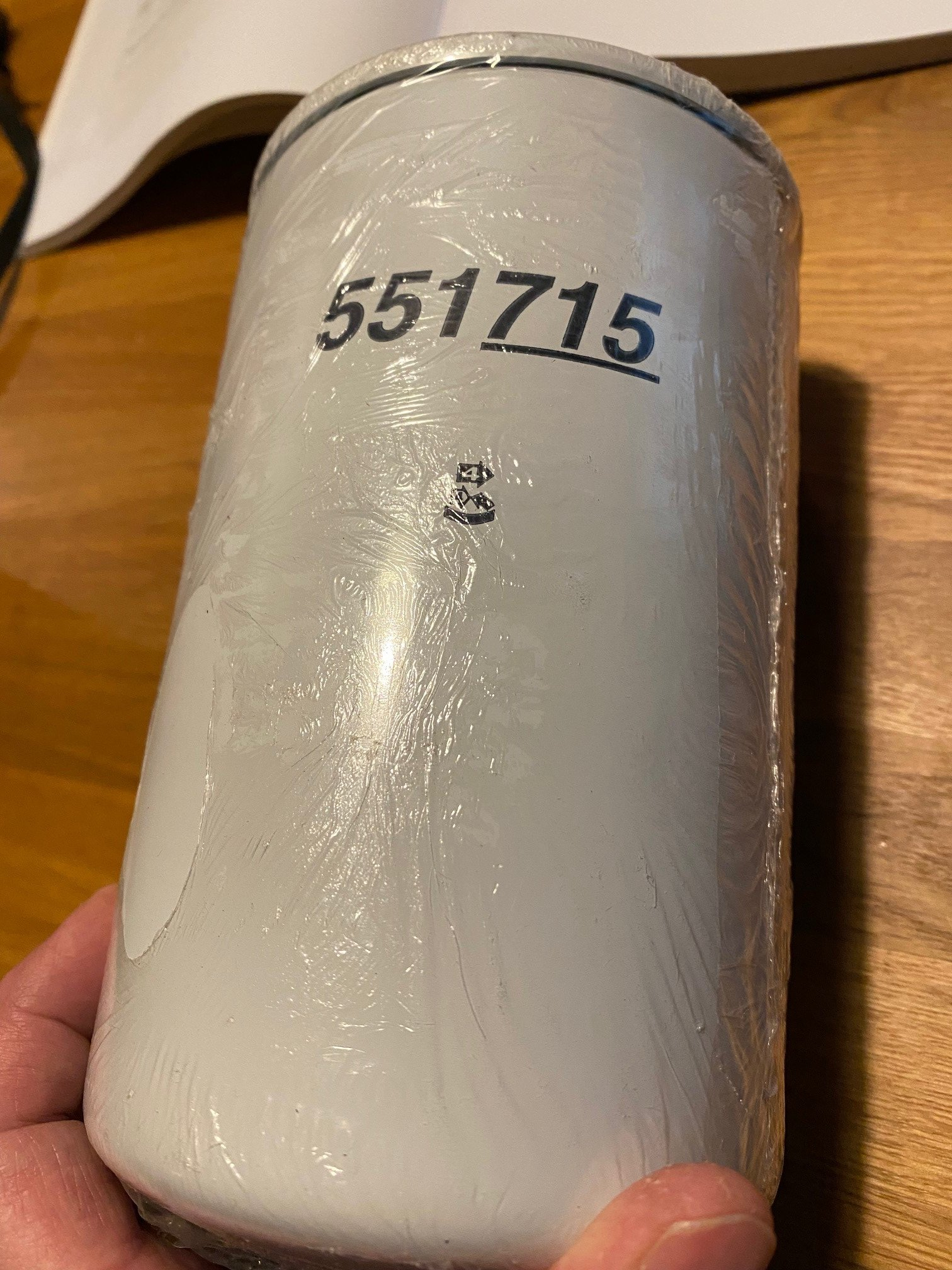

Thanks. I'm going to use the WIX 51551 for the HST filter unless you guys talk me out of it. And the WIX 51715 (a/k/a 551715) for the hydraulic filter.

I'd better double check that the WIX 51715 hydro filter will work

The hydraulic filter should be just fine.

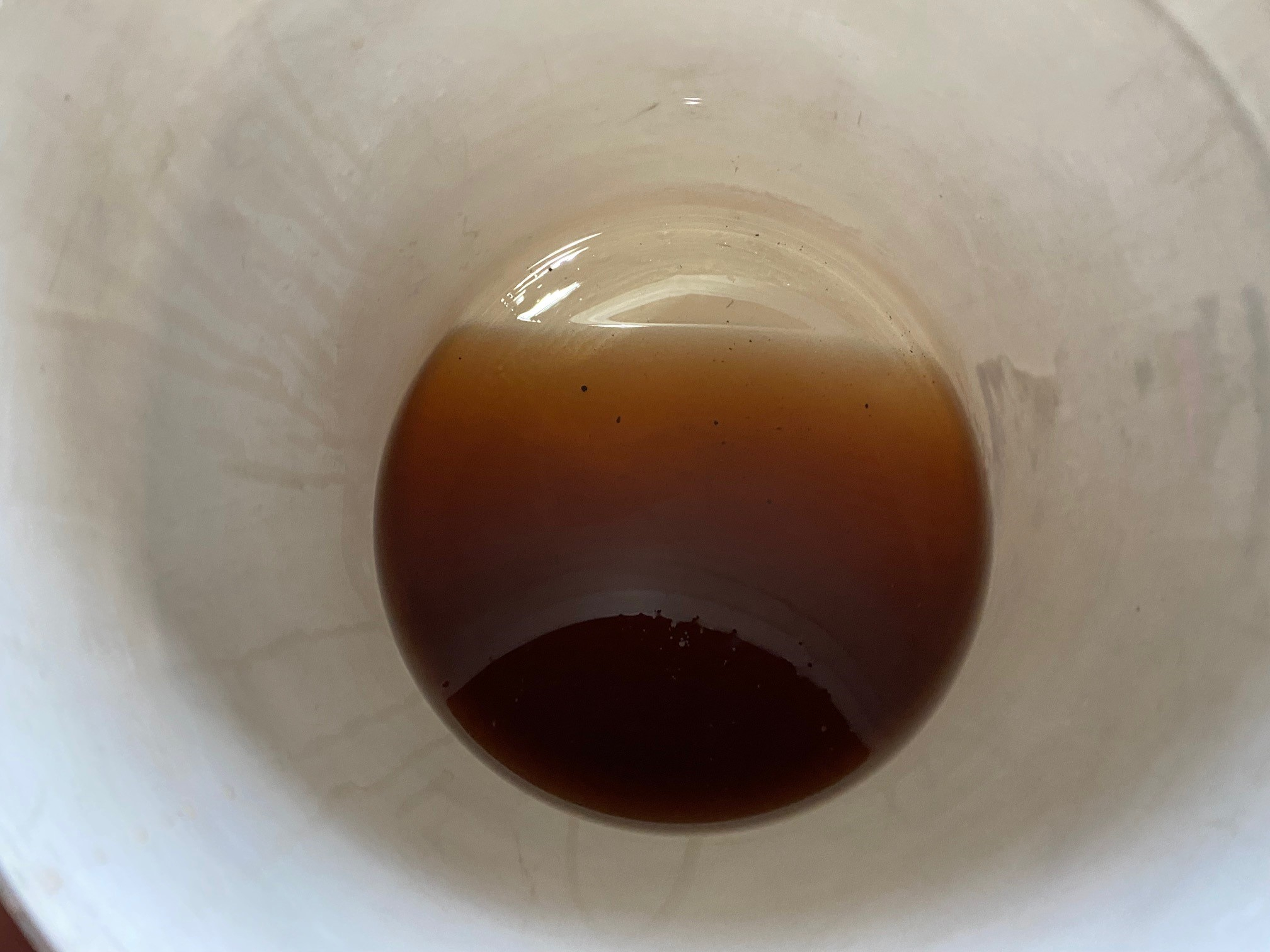

Thanks. Put it on a little while ago and it's a perfect fit. I made an adapter from clear tubing and my heat gun for my shop vac but I didn't use it because I was concerned it would suck the fluid into the vac. Had the wife hold the 9 gallon shop vac hose over the fill port and it worked like a charm. Only fluid lost was in the factory filter. I reclaimed it with a mesh screen funnel.
Changing the hydro filter is a breeze compared to the oil filter. My cheap chain wrench from Amazon worked great.

I used the same shop vac but not sure it was needed. Very little fluid came out. The filter was full. I strained the fluid and put it back.
