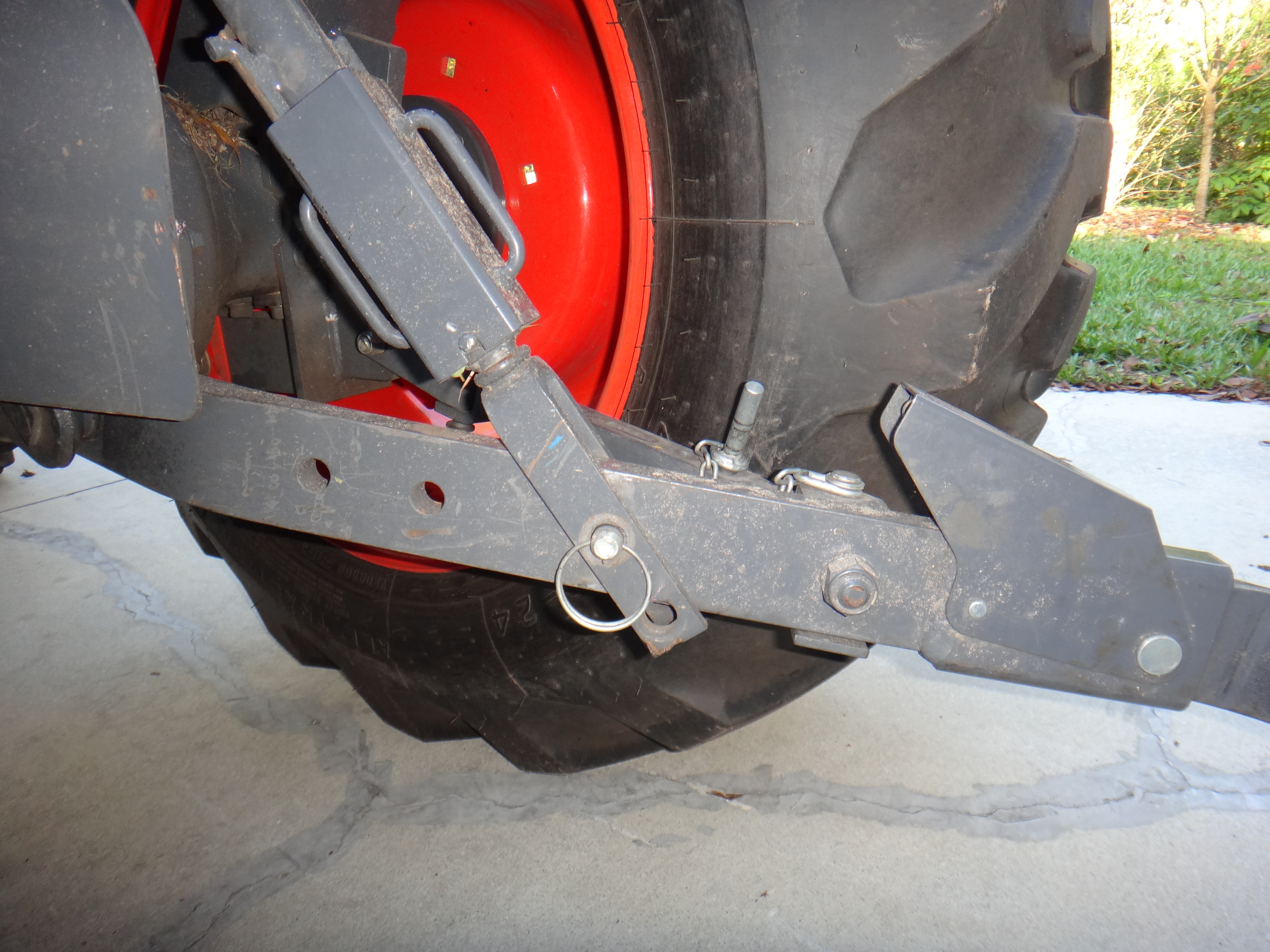

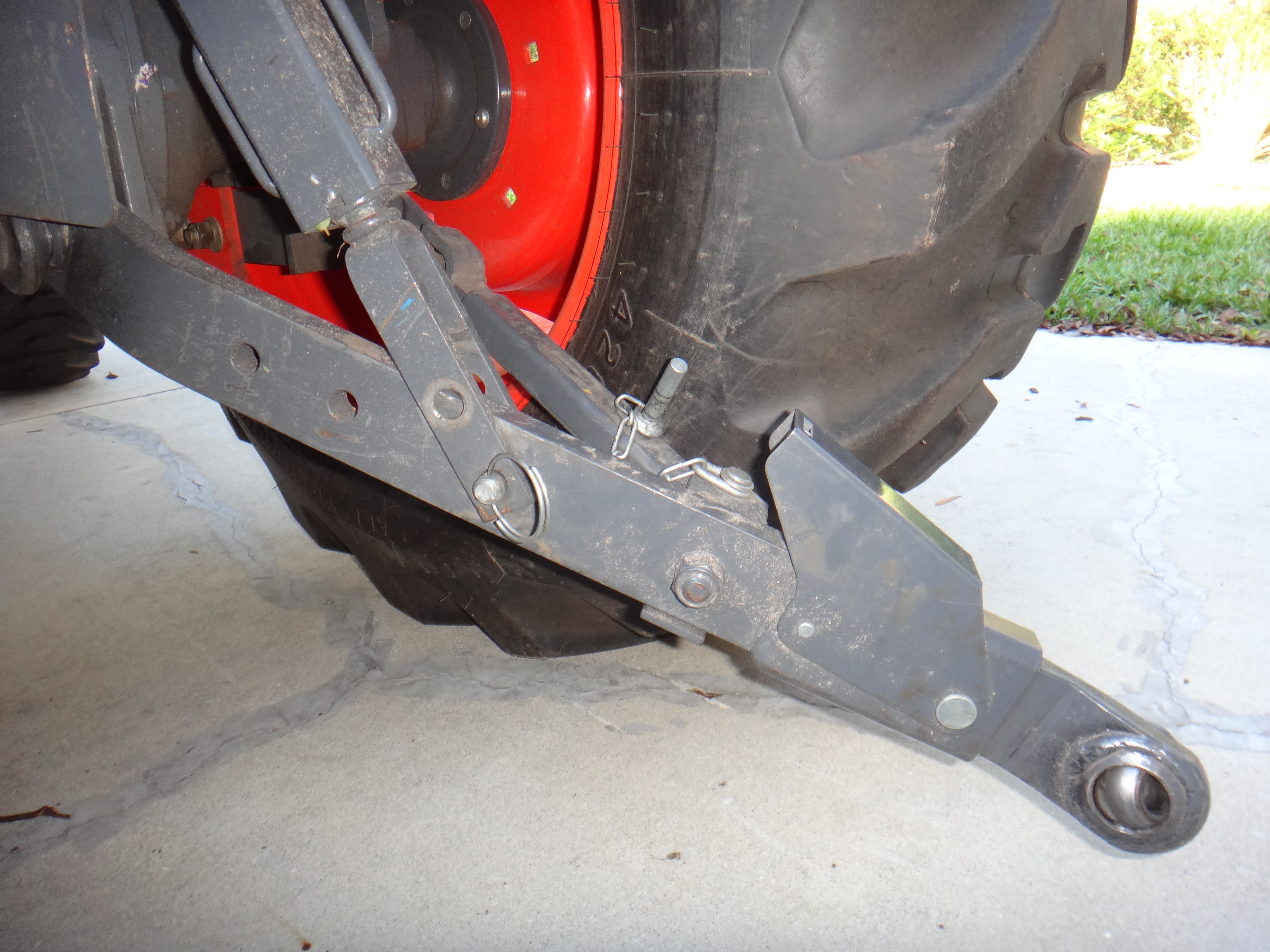

Perhaps clarifying pictures.
Photo #1 top pin hole. Considered default adjustment.
Photo #2 lower pin hole. Note lower angle of Lower Link.

Note that there is dynamic lift range that is inherent in the mechanics and hydraulics of the lift linkage. -- Lets say 18 to 24" of travel at the lift eyes depending on the tractor. -- This range can be offset higher or lower, but the amt of range will not change unless you actually alter the pivot points or the hydraulics. ... To make the most of what you have, LD1s method with the toplink point is valuable in that it will affect how much the rear of the implement tilts upward as it rises.

Perhaps clarifying pictures. Photo #1 top pin hole. Considered default adjustment. Photo #2 lower pin hole. Note lower angle of Lower Link.
Thanks, that shows what I was trying to say.

If you want the L2501 Lower Links to lift higher, move the right and left side adjustment pins to the TOP hole on the stirrups.
See photos in Post #4.
