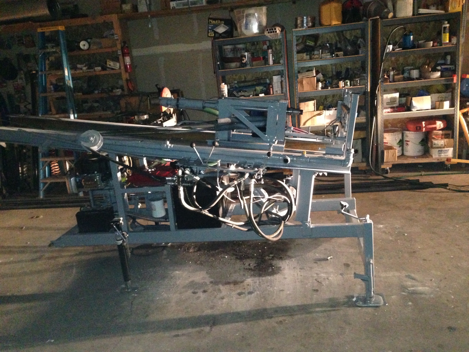

Hello all,
I built a water well drilling unit. Many companies make similar units and provide mud pumps with them.
My question is, what is a good choice for such a pump? Trash pump, semi trash pump, dredging pump, brand?
The slurry will be sandy, clay, small stones. I never saw any of the companies that make these small well rigs claim what type of pumps they use, just use the name " mud"?
Anyone have insight tonshare?
Thanks,
Gray

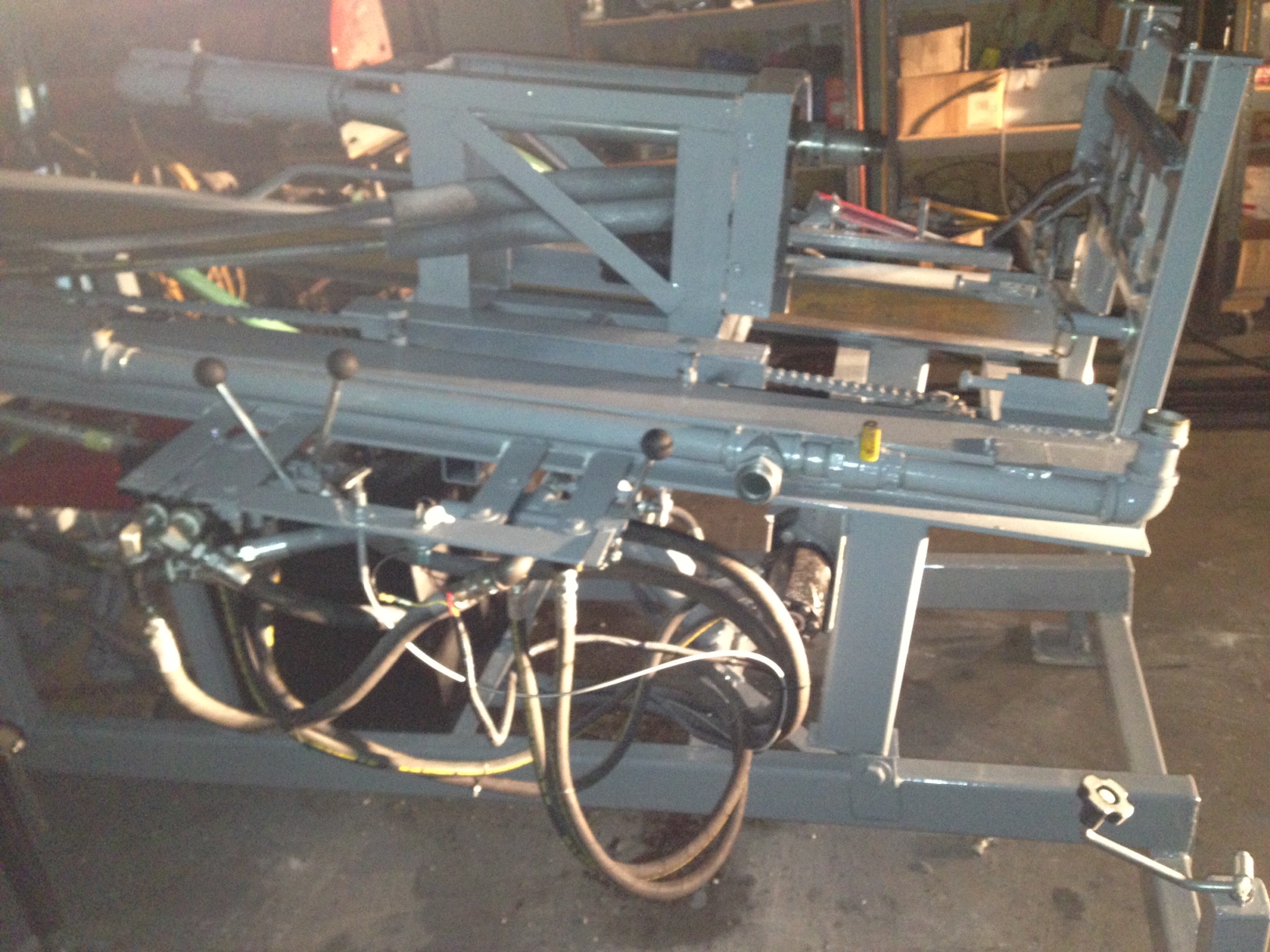

Hello,
Here is where I am at on this whole project:
IU have my prototype done. I predict it will drill over 200 ft given the right drill stem. I have a trash pump that will work on this unit for a few wells if I use a settling pan. I plan on using a feed troph and a divider in it for settlement. I will use bentonite in the mud. This will wear this type of pump out fast. I looked at a dredging pump from AMT and a semi trash from Flowtec. In the end, It looks like the flowtec with a pressurised grease seal is the best choice. In my research I found that Vermeer and Ditch Witch use them on there boring rigs.
I now have a 21 HP gas engine driving a 1.83 CI hydraulic pump. The engine is a bit undersized but because only one motor really pulls that much flow at any one time, it will work very well. Of course, I already have some refinements on it to make and this is a prototype. The next one that I plan will use all the same concepts but will have many refinements---27 HP. on board mud pump driven by a hydraulic motor, nicer control center, larger fluid container and a bit heavier pillow blocks. I will continue to use the 8 HP motors for drill head and chain hoist.
This unit is portable in that it can be mounted on many different trailers, even on the back of a full bed pick up truck. It weighs in at about 1200 pounds and folds down. It can use 5 to 7 ft drill stem but if it works well, I can produce this same type up to 20ft.
The swivel will be a big question? I made it from scratch with two sealed ball bearings, DOM tubing of different sizing, large washers, 1.5 inch black pipe and graphite PTFE packing with grease fittings. It held well against a 100 PSI air:)))
My drill head has 4-6000# drill head frame guides, 6000# thrust bearings for lift up and push down, No 80 drive chain and more. The lift capacity is over 4000# but I will rate it at the chain working strength of 2100.
So much more but you get the idea?
More input the better.
Gray

Here are a few pics of the rig. It is designed to mount on most trailers or be hauled in the back of a full sized pickup.
The upgraded model will have an on board mud pump.
Gray

A neat little machine, to be sure. Tiny by the standards of the typical rig I work with. I usually hire rigs with 250,000 to 1,000,000 lb load ratings, plunger style mud pumps to 1000 HP, yadda, yadda.
I recall vertical shaft trash pumps from Flygt being very popular for mud transfer. Bentonite slurries to 1.3 SG and 10% solids. Be warned though, thick bentonite slurries seriously affect pump performance - they will still work, but will not be able to deliver at the same rate. I've seen the Flygt trash pumps pass rocks that would not pass the downstream plumbing.
