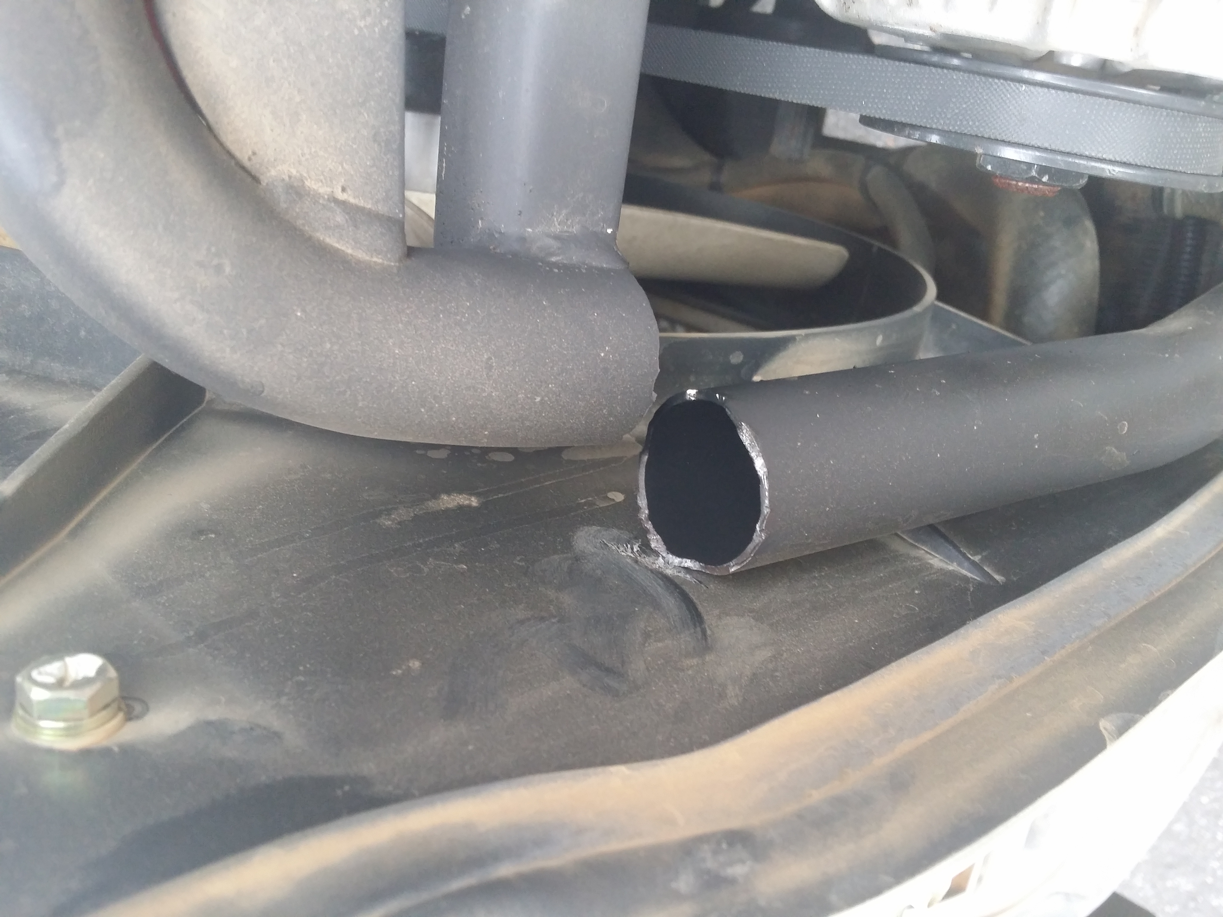

View attachment 609715View attachment 609716View attachment 609717
Mahindra replaced the original muffler on my EMAX22GEAR when it failed after 150 hours. But now, less than 30 hours later and 11 months, the pipe just fell off the muffler. I don't know what to think anymore. Do these engines run so rough that it just shakes the mufflers apart? Mahindra has replaced the loader bucket because of cracks and now the muffler has failed 2x. I bought the tractor new in February of 2016.

Barry, in your pictures I don't see the rubber mount (frame) at the end of the pipe. Did you remove it?
Barry
Your replacement muffler looks like the old style. The new one is twice as heavy and so are the brackets. If Mahindra won't replace it again, I'd bite the bullet and buy the new kit. It is rock solid once mounted. I don't think it would give you anymore trouble (knock wood).
The old rubber tail pipe clamp was a design flaw. The new style is mounted solid between the alternator bracket and the motor mount so the whole thing moves with the engine.

Take that thing to a welding shop, they can weld it up and add some reinforcement- probably lot cheaper than buying a new one! I did that once on a smaller tractor (rather than spend 2 or 300 $), and it worked out perfect! You see, it failed in the weakest location, so if that is fixed, you are usually good to go.

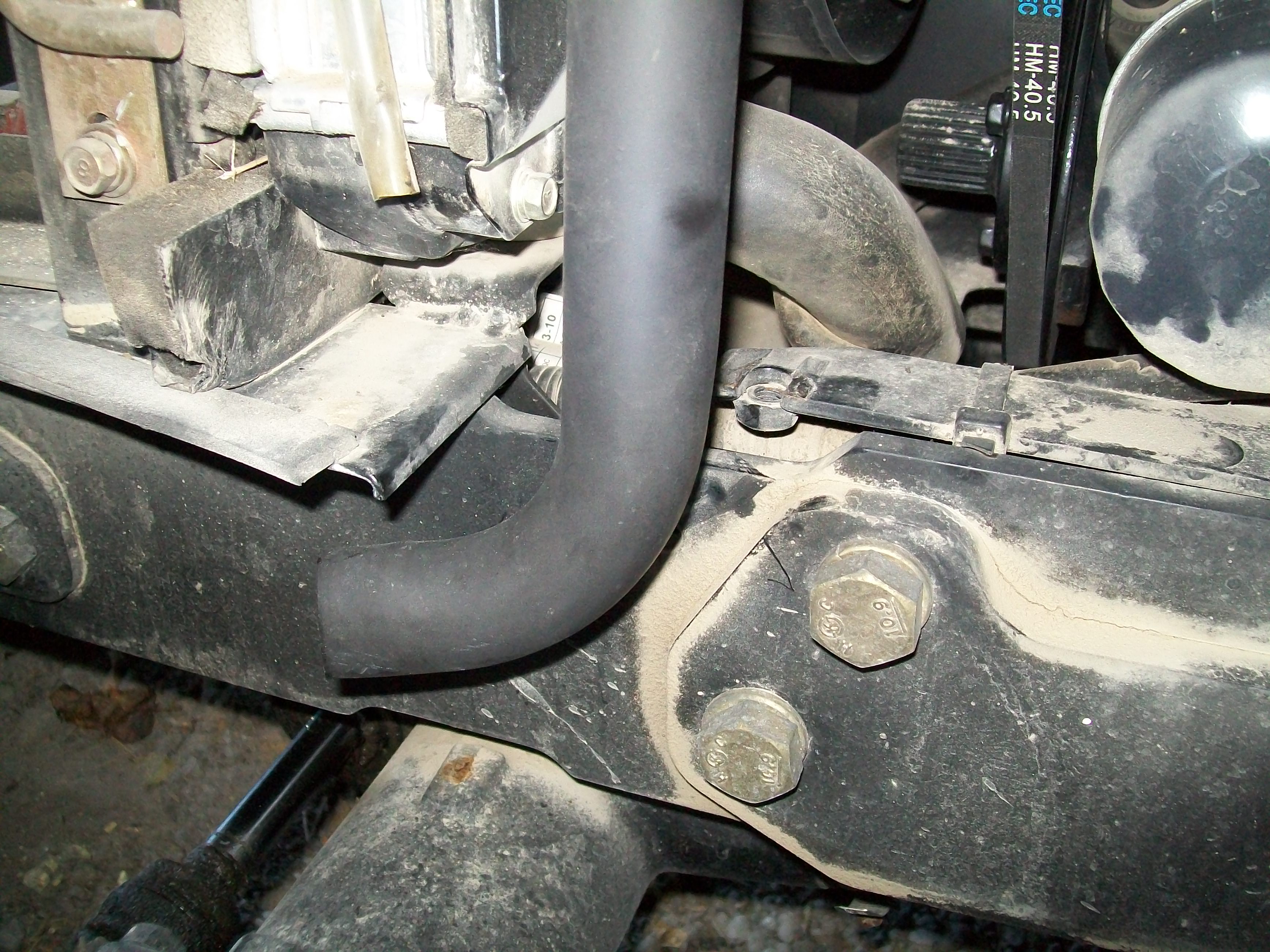

This is the replacement muffler installed the the dealer. There is an empty bolt hole down near the bottom of the muffler pipe that appears to be missing something (pic attached)??? Did the dealer leave something off??
   / Muffler cracked #37
Yes. If you look at the parts breakout on the Mahindra site, you will see the "L" bracket, rubber bushing, and pipe clamp. I bought my tractor used, and the only thing left was half of the L bracket, so I ordered these parts and re-welded the old style muffler. It didn't last, so I bought the new kit. You end up discarding these parts with the new style muffler. I still have the L bracket, bushing, and clamp. You are welcomed to them if you decide to weld your old muffler.

Follow up...
Upon close inspection they used a smaller muffler body with a thicker tail pipe wall. The tail pipe went from 1" to 1.5" OD and it was rigid mounted to the frame. How long do you think the new 'design' will last when one end is mounted to a engine on rubber mounts and the other end is bolted to a non moving frame? Probably about 5 years, just out of warranty.
I cut a section out and replaced it with stainless flex exhaust pipe, two clamps. It now has wiggle room.
