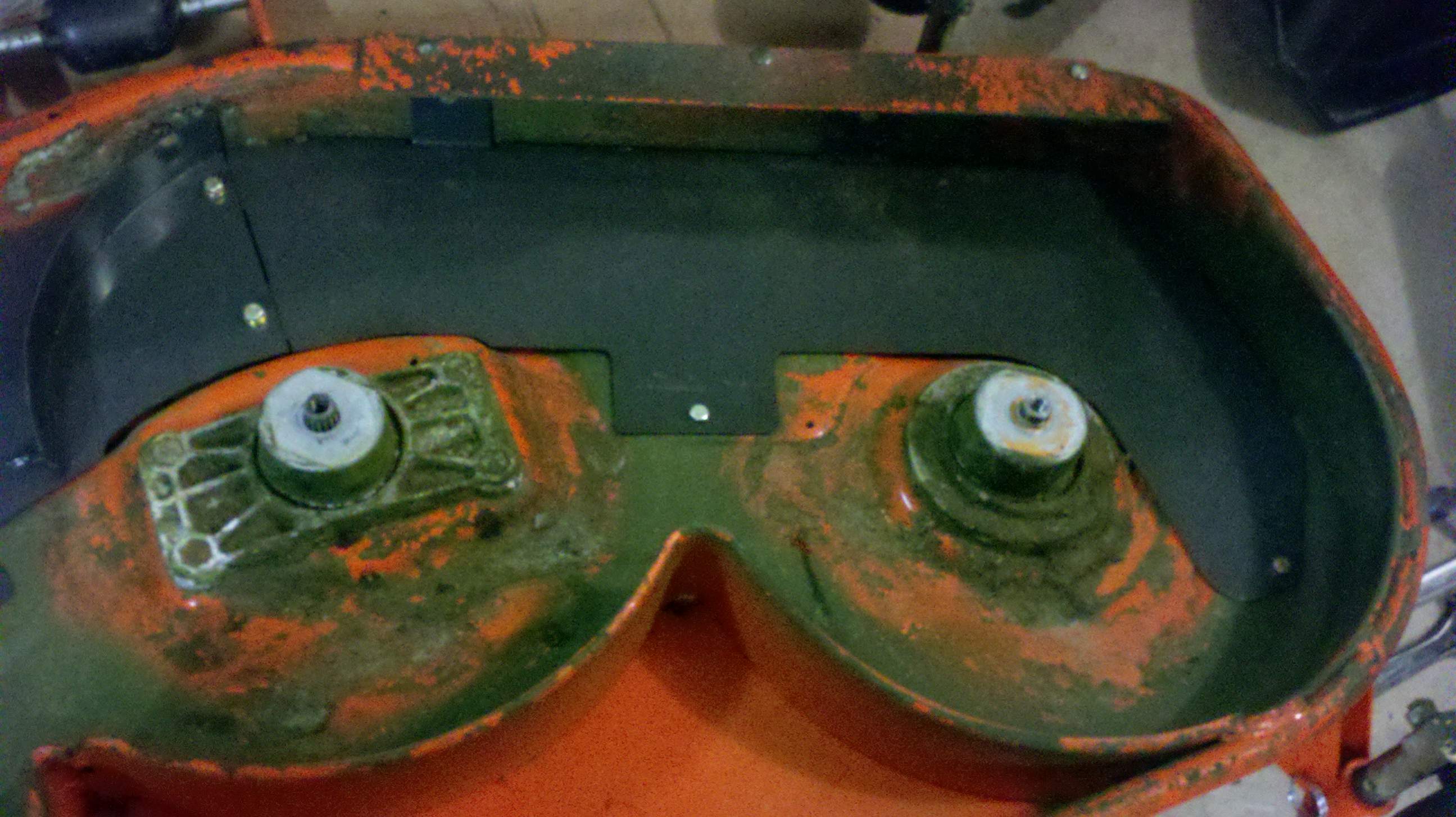

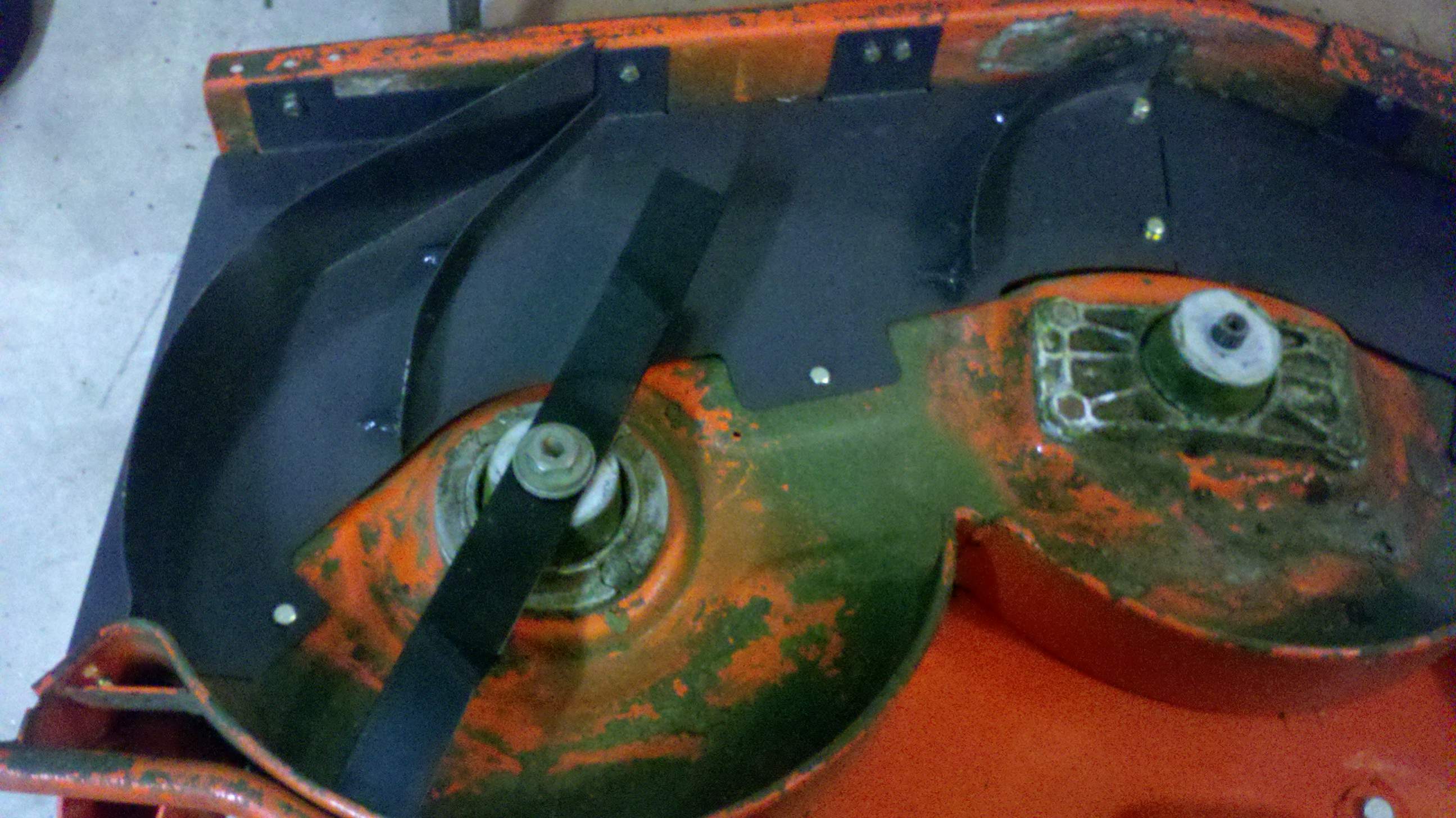

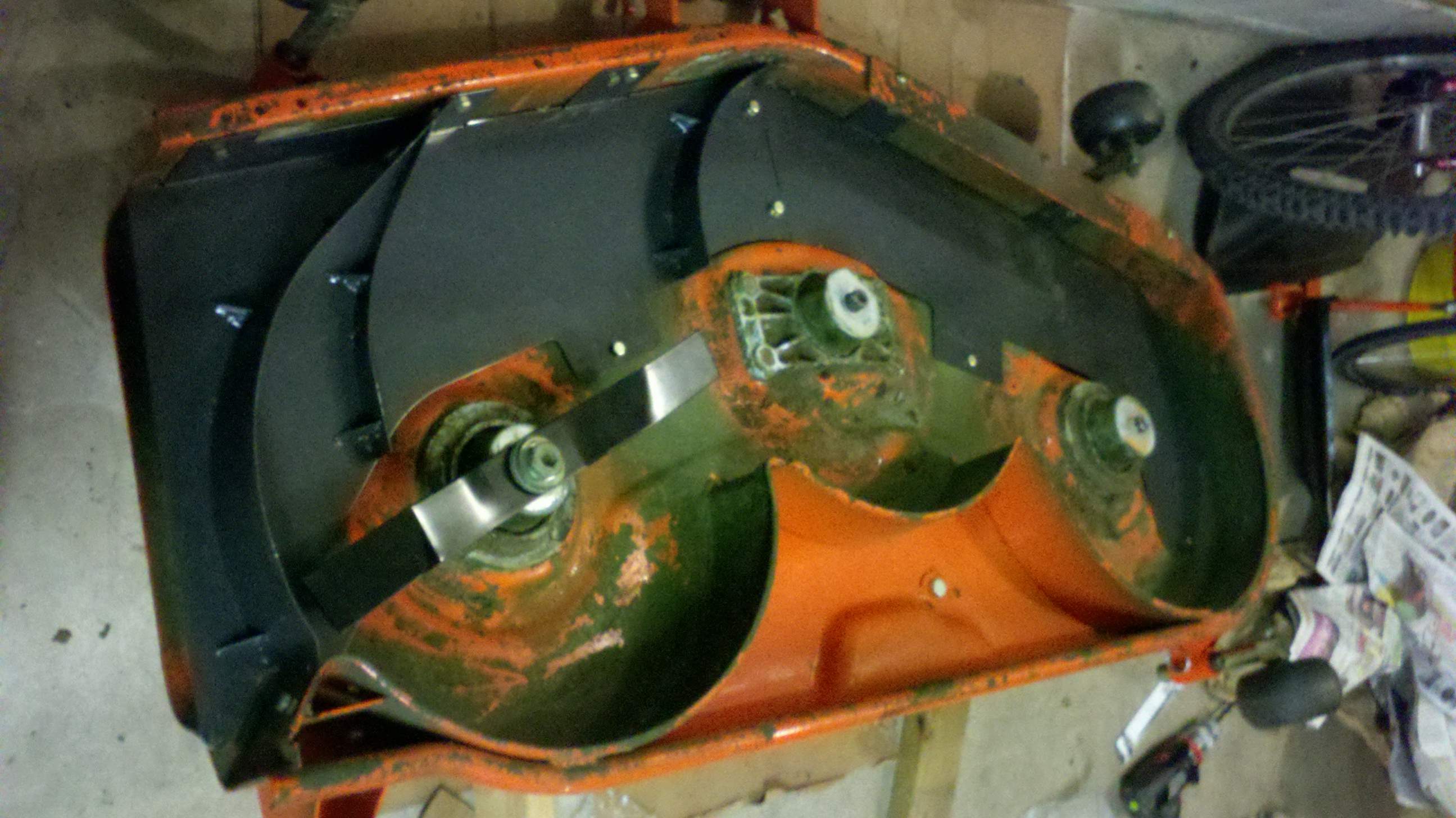

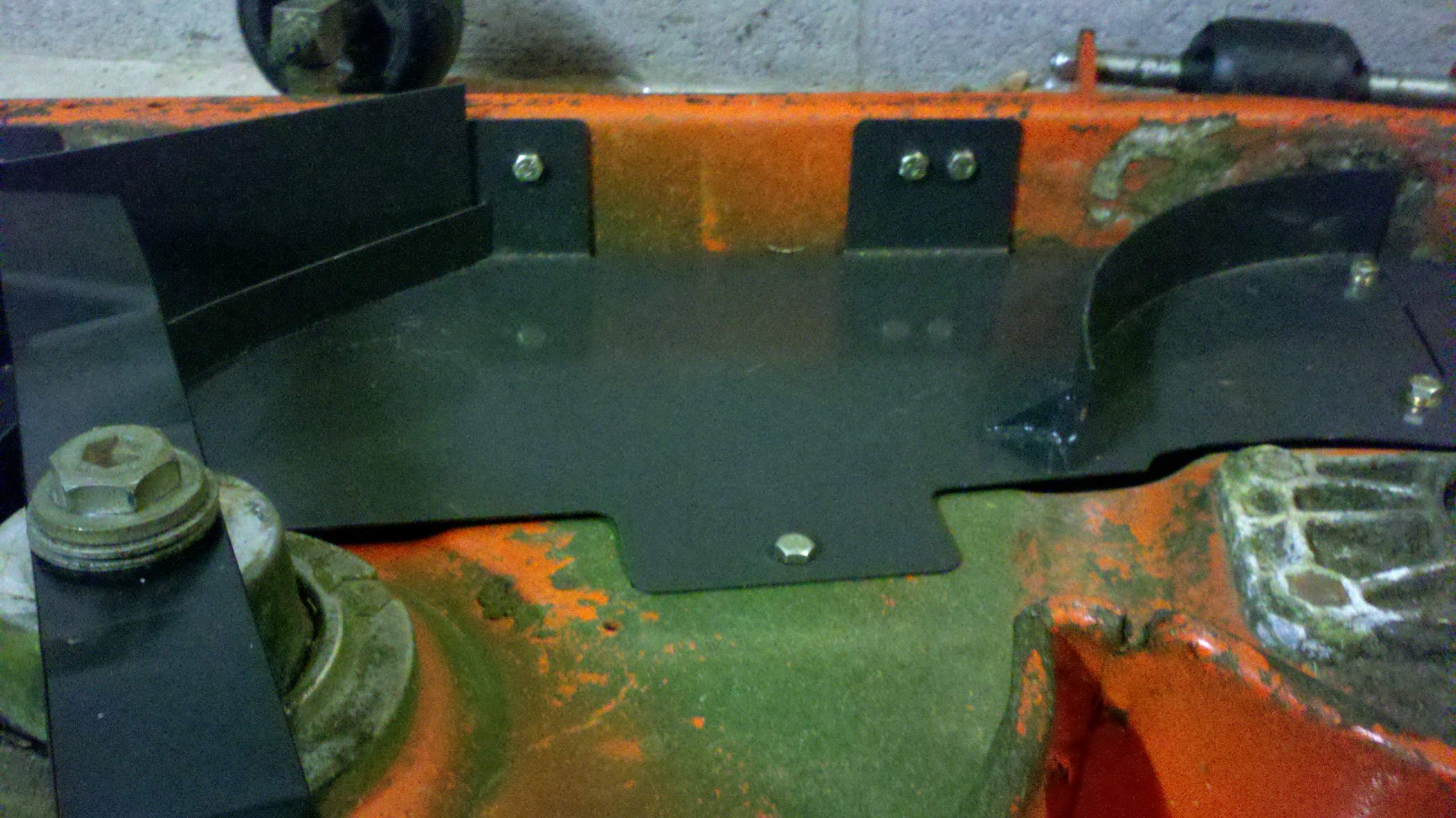

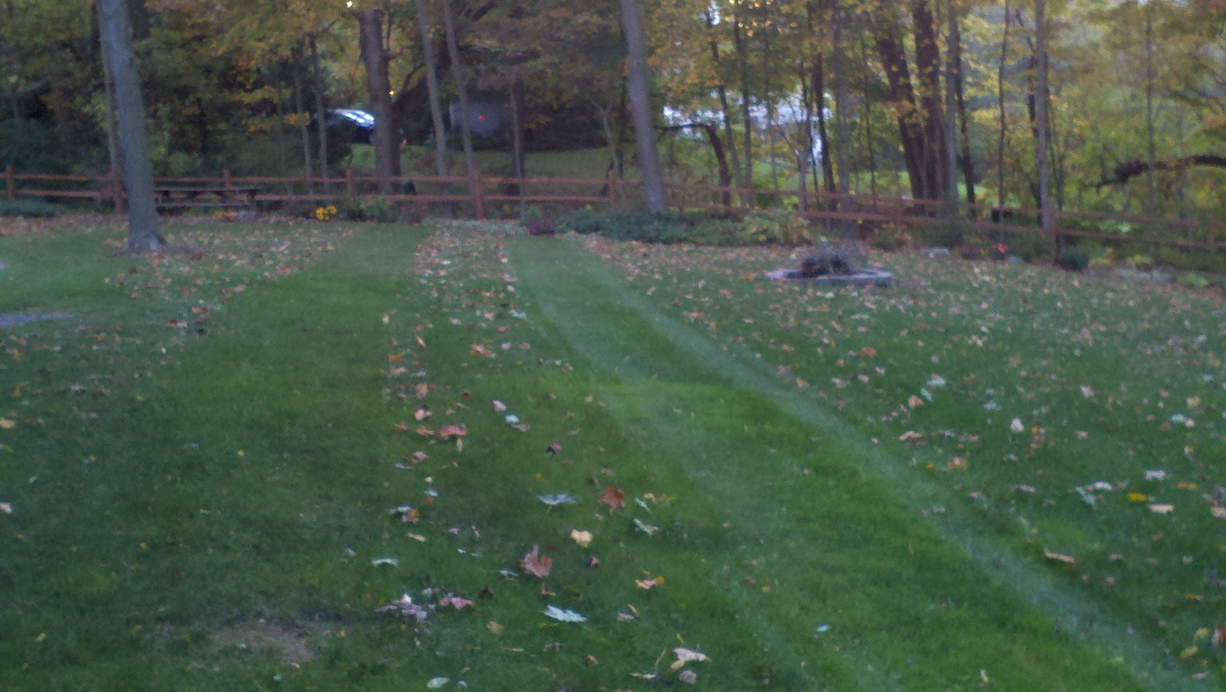

Well, Some have to pee on the electric fence themselves. I went ahead and purchased the mulcher because I didn't want to spend all my time working the leaves off the yard. It is not 100% like the GR series mulcher but it works fine. I can also run the mower and put my lawn sweeper on if i have to.
The pic is two times over and back with the mulcher. It does not blow the leaves away so this is a true pic. Also the pics of the mulcher. It was not cut and dry. I had to work at it, drill holes and such.

Well that's interesting.
Your kit is all metal, and looks like it has more baffleing than the one for my finecut deck. Plus the one for my deck is moulded plastic! I didnt think there would be that much of a difference.

It was a real surprise to me also. The one I had for my GR was, like you said a molded plastic piece. The dealer had gotten this back as a return and one piece was missing but I had a shop make me the piece. At first i thought the holes would be there and all I would need to do is line up the holes etc. That was not the case. I went and got a good drill bit and followed the directions myself. You're right, I think it is much different than what anyone else that gave their opinion thought it would be like.
