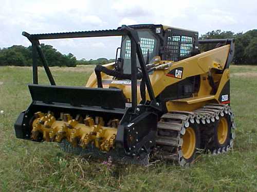

/ Mulching/clearing opinions #3
I think I would invest in something like this, or hire someone to mulch out the forest.

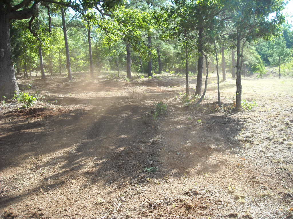

If you can sell it and people will buy...by all means! But my thinking is it should be cheaper, less costs up front (purchasing equipment new), less fuel cost to operate, and you can haul a decent size skid steer on a bumper pull trailer. It's also a lot faster.
If you mulch, do you still have the stumps that will pop back up? I talking aobut those 1-1.5" junk. I guess a dozer with a rake might remove more of this. You can see in the pic where I went over some small saplings with the RC. they have begun to strout up again. The stumps are only a couple inches up and a little rough on the finish mower. You can see a few in the front of the pic and some in the back.

/ Mulching/clearing opinions #19
I am pretty biased on the value of mulching over any other form of land clearing so guys with a dozer and an excavator may disagree with my opinion but we do live in America after all. When you have your land cleared with a mulcher you do not have to spread the mulch it is already done by the mulching process. Next you do not have to worry about erosion and losing your topsoil since the mulch bed holds the soil in place. When you try to re-establish your ground cover the mulch bed acts to retain moisture and moderates soil temperatures allowing you new cover to establish. The biomass will decompose quickly in a pasture adding organic matter to your soil.
The only added expense with mulching is soil testing and adding nitrogen since the decomposing wood will lower your N levels.
When I clear your land there are no stumps, I either grub them and grind them up too, or plane them off to gound level. After I have cleared any job you can drive a truck or tractor thorough there with no worries of puncturing your tires or getting hung up on stumps and such. If I just level the stumps you want to keep your ground engaging implements out for a few years though!
Also if you want 100% mortality on the stump you can put a coating of Roundup and veggie oil or deisel fuel and the roots will die right a way. If you kep the top growth mowed of they will die in a couple of years as well.

I am afraid that you are making a few incorrect assumptions. I run a dedicated purpose built mulcher that cost over $155k. In heavy material it will guzzle a 52 gallon load of fuel in 7 hours. And I would not reccomend pulling my 15,300 lb machine on a bumper pull trailer.
