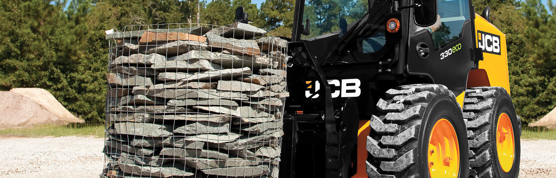

Perhaps something like a JCB 330? It is a single arm skidsteer with a side entry door: Skid Steer Loaders | Skid Steers | JCB 33

The JCB might be one option. Have you looked at the Rayco 100 size machine?

Aczlan thank you I checked out JCB 330 very possible alternative. I m going to look for a dealer close by and check it out in person so I can see how easy it might be for me to get in. Really appreciate your advice.
