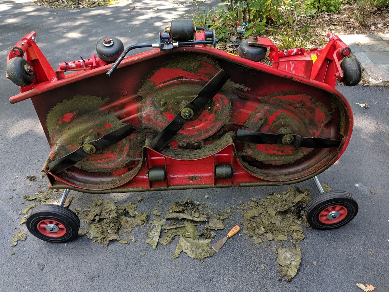

And here's my deck:
You know what, now I realize it's not just a matter of plugging the chute and changing blades. The mulching deck has baffles that encircle the blades, so the grass could be rechopped a bunch. Whereas my deck has a pretty big exit channel for funneling grass clippings out the chute from the 3 blades. Great for spitting out grass clippings, but I dunno how it would work for re-chewing the clippings just by blocking the chute. I suspect it would just create a buildup of clippings in that channel (although I suppose the buildup could eventually act like baffles).

I thought it would be like on my craftsman 50" deck, it's mulching kit is just different blades and a plug. It's got a way smaller exit channel, I suppose the design made a compromise so that it could do either side discharge or mulching ok "enough".

Is yours like that? Looks kinda like my craftsman deck, baffles surrounding the blades except for a channel between the 3 blades and then out the chute.
