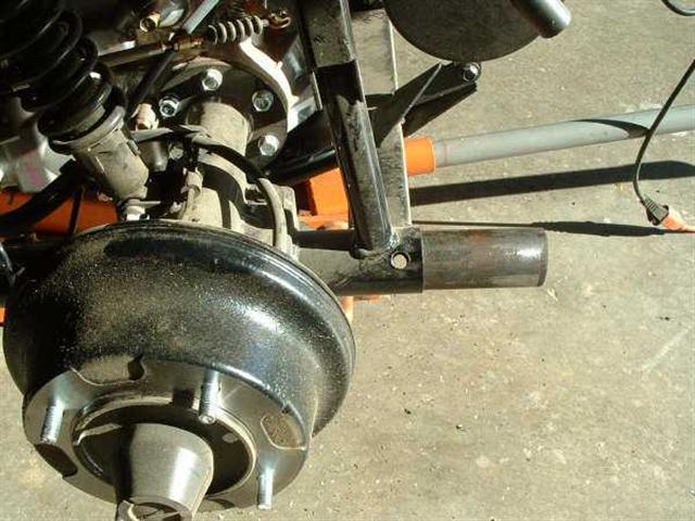

I started to fabricate one by extending the frame tubes using 1.5" black pipe. I drilled a through hole bo bolt the extentions on.

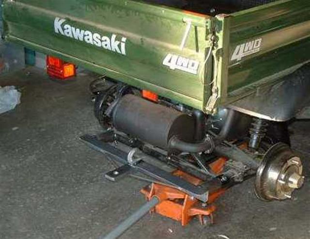

I then tacked up the hitch out of some scrap steel that I had. I wanted to make sure that it all fit correctly before final welding. I also added a tow hook that could be used with a tow strap.

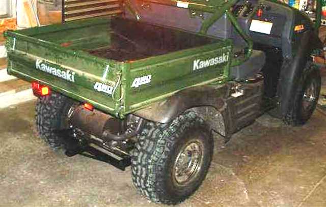

Once I was sure that everything was lined up right I welded it all up and put a coat of primer and black paint on.

Another view.

   / Mule Gets Hitched #6
Looks good and a good idea to utilize existing tubes. The only problem that I can see is that it will ride rough when you have something hooked up, since it is attached to the axle swing arm.

Jerry,
I had trouble finding anything to mount the hitch to. There just isn't very much back there.

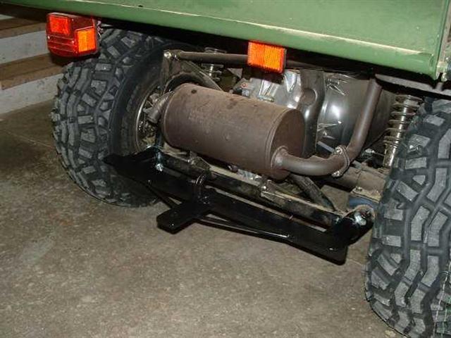

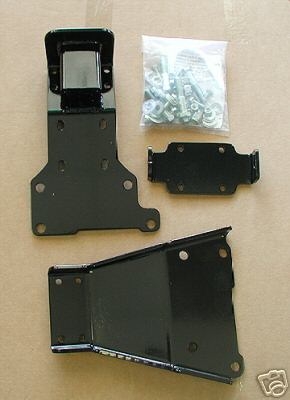

   / Mule Gets Hitched
#9
Here is a light gauge metal Mule hitch that is selling now on Ebay for $104. It appears to simple bolt to the center of the lower control arm.
