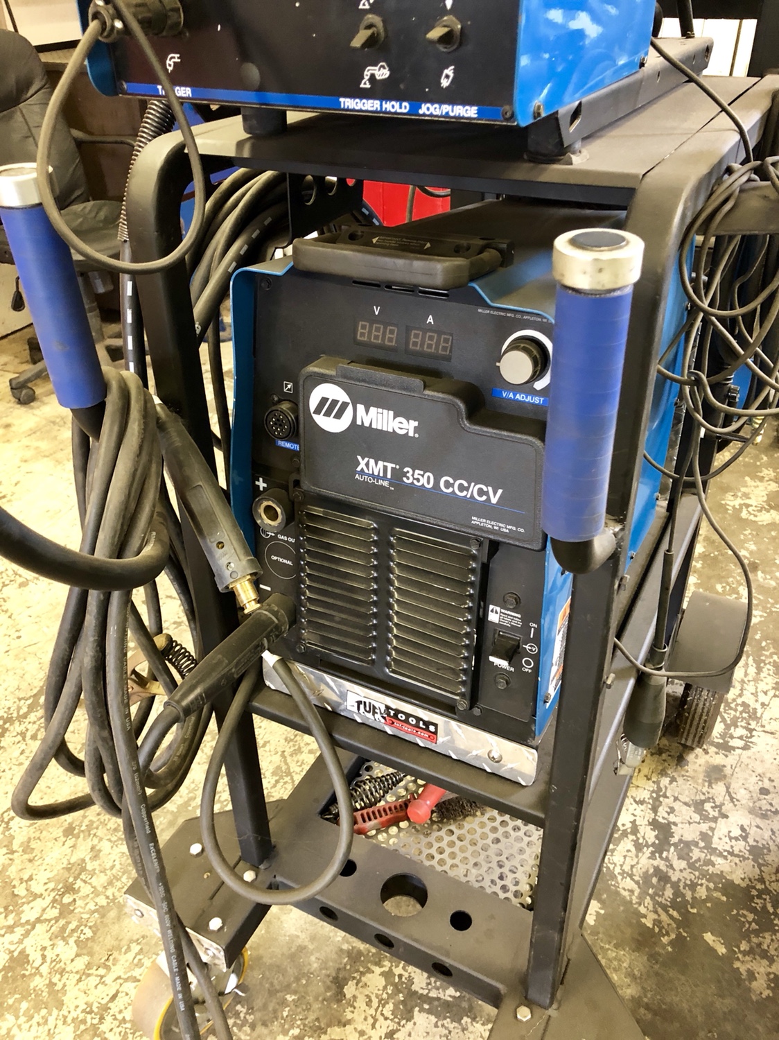

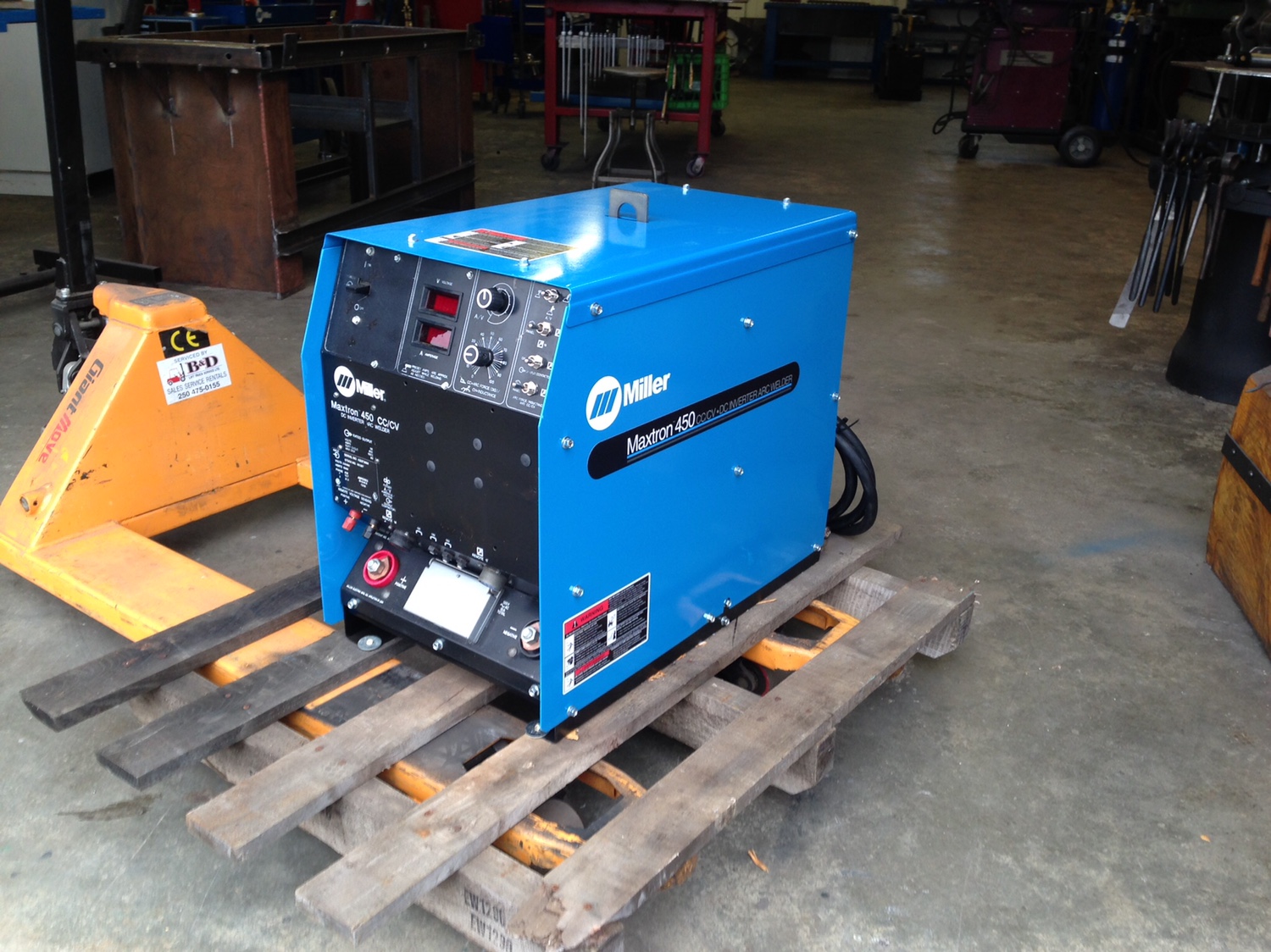

My Miller XMT and Maxtron will handle 6010

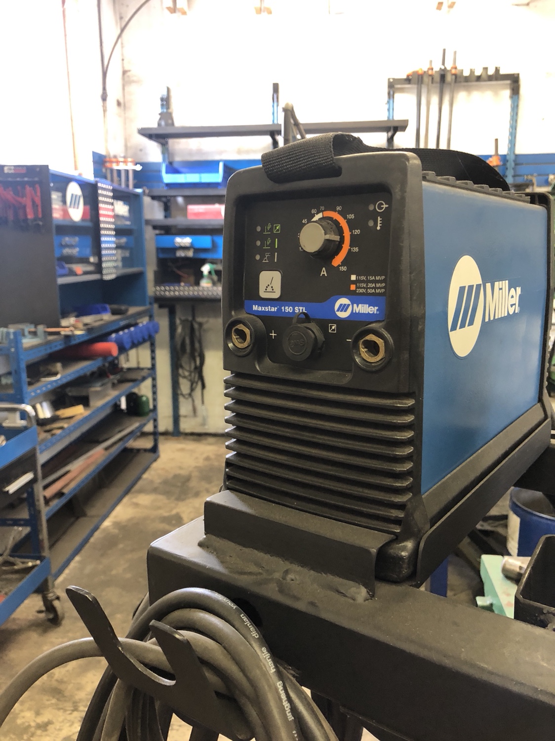

The Maxstar 6011 only

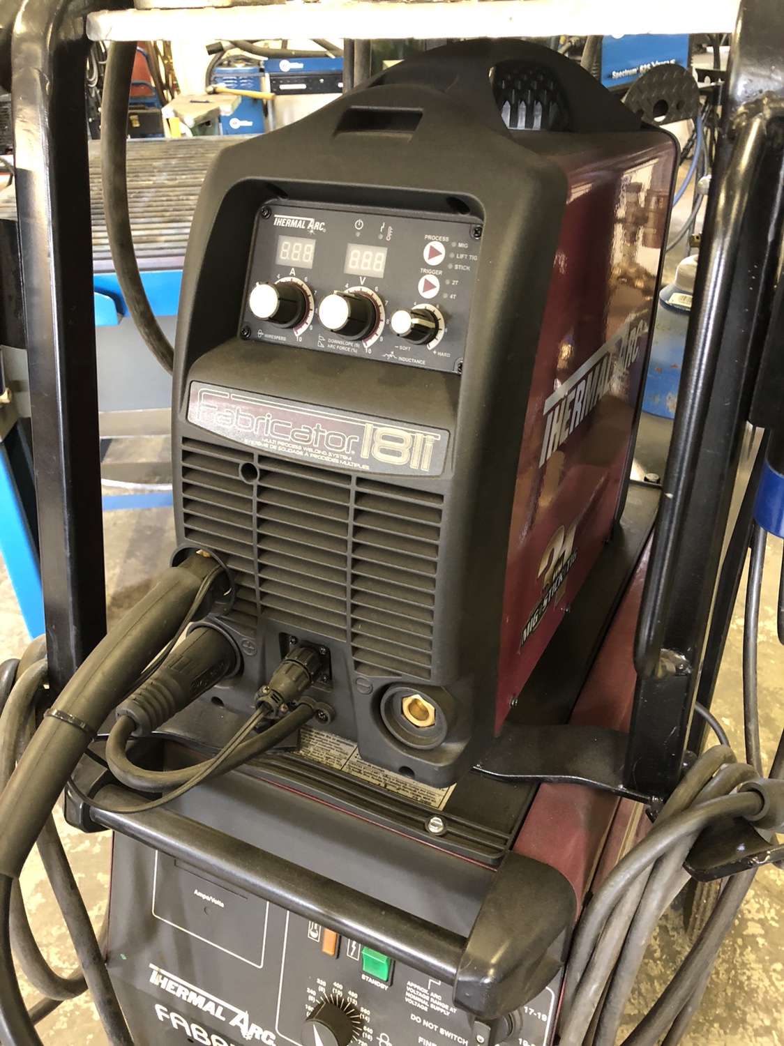

My Thermal Arc 6011, yes. Never tried 6010 but if I had to guess, not.

that thermal arc 161 will run a 6010 pretty good until you push it really hard into an open root groove joint then it takes some skill to keep it going. lots of inverters will run 6010 just fine on either polarity
