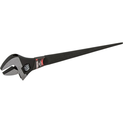

Not a must-have but a handy multi-purpose thing: a 16" one of these. Seems like I'm always trying to align pins with holes or holes with holes, or need something stout but skinny to stick in the loop on the top link. This and a regular crescent wrench make a good pair.
[edit to add] Chain hooks for the loader bucket. I'm fond of the BXpanded clip-ons for light duty.
Z.
Z.
Spud Wrench.... I keep one on the tractor.. perfect for three point hook up adjustments
