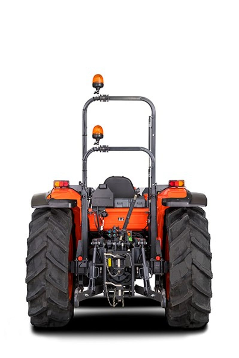

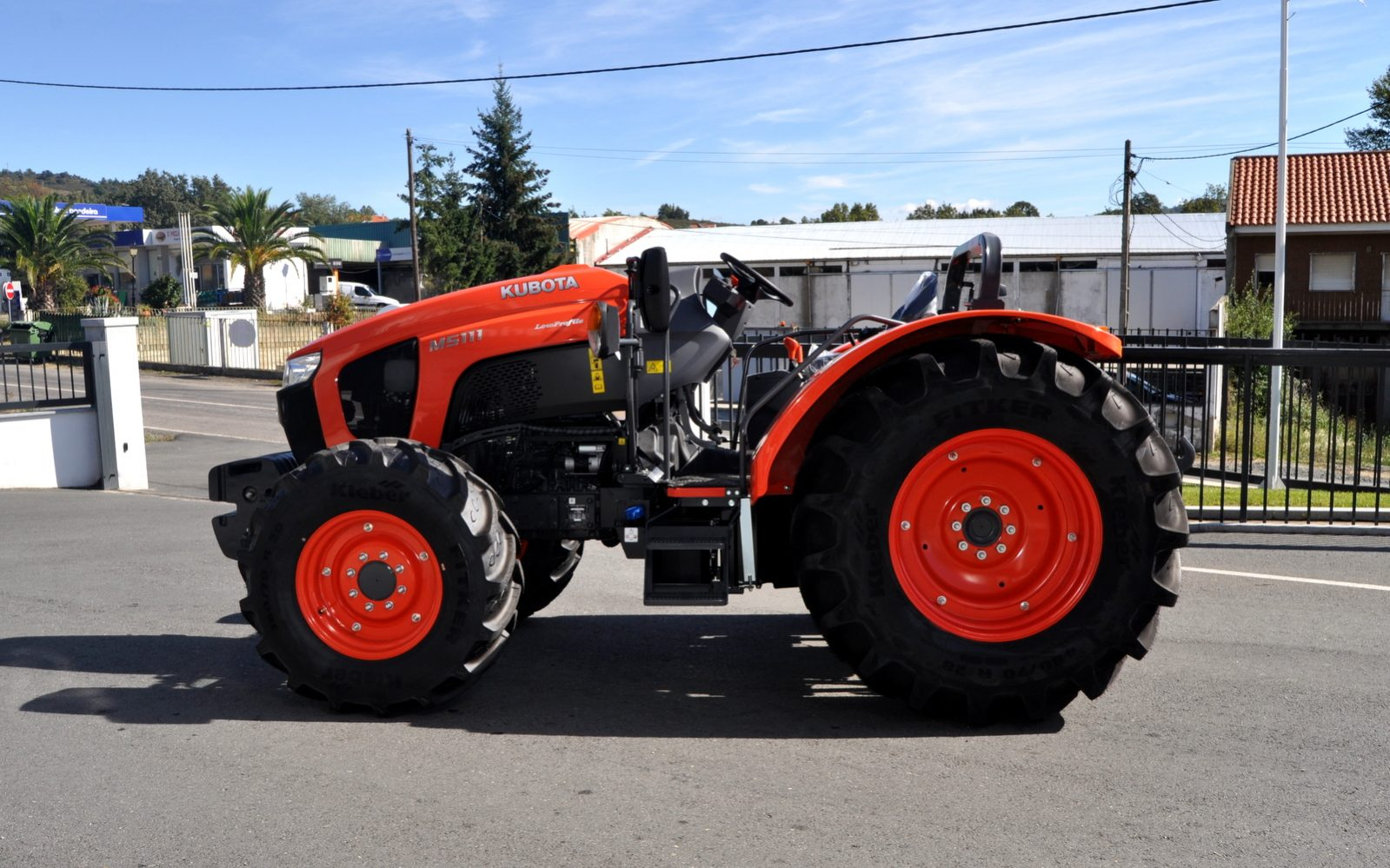

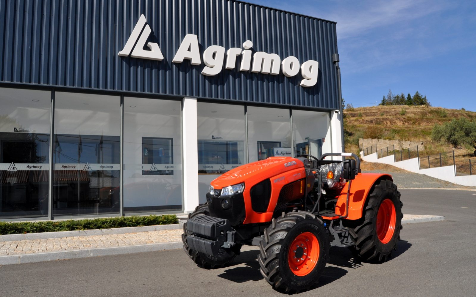

You guys just need to buy a Kubota M5111 Low profile and your ROPS height issues will go away. The ROPS on this particular tractor, will actually slide up and down with an assist of a gas spring, instead of folding backwards or forwards. Just set it at whatever height it fits on the garage and it's all good.
Man, it's fun spending other people's money! :)

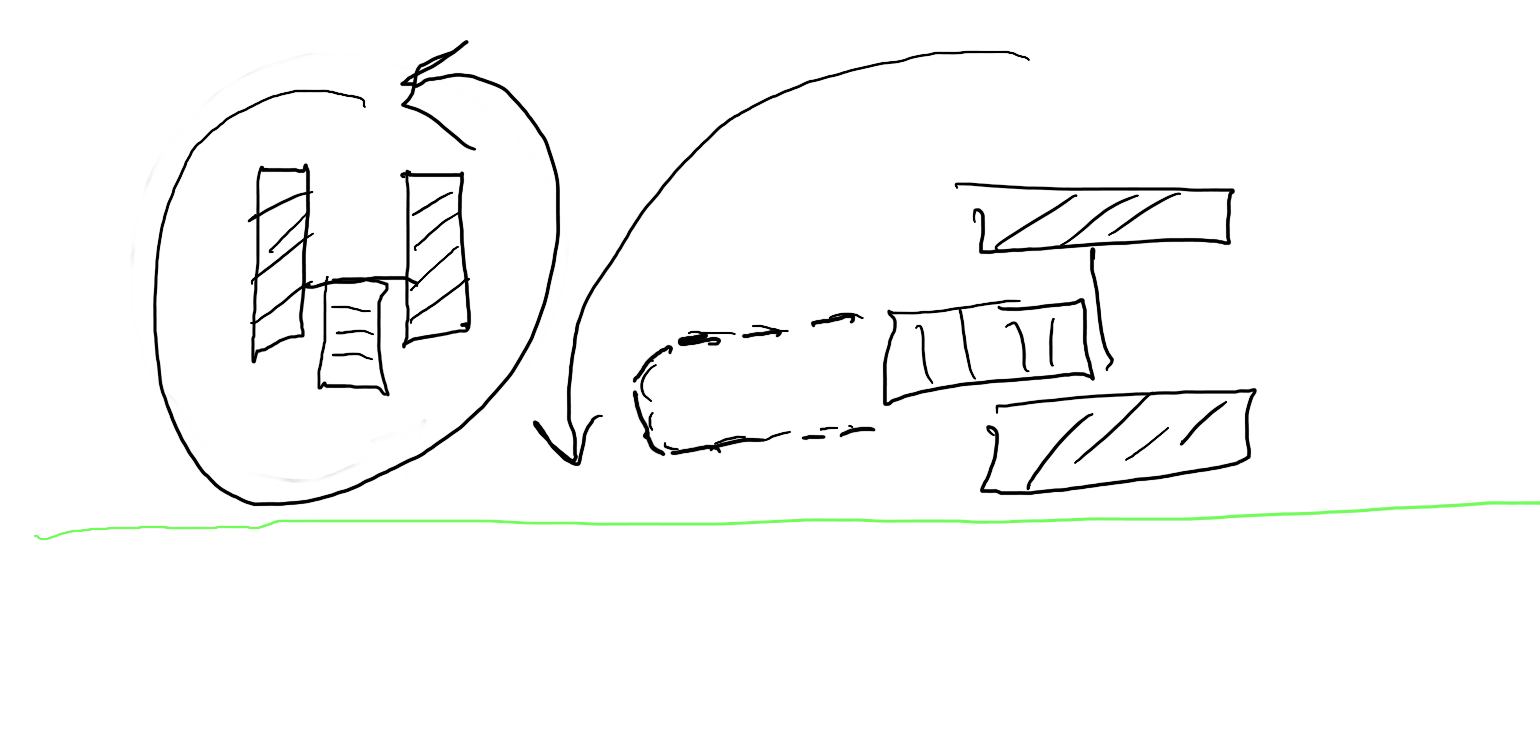

A ROPS has to be high enough to keep the tractor from ROLLING as in ā€œdown hill, like a snowball headed for hellā€ as the song says. It has nothing to do with keeping the operator from hitting his head on the ground. Cutting your roll bar is a very bad idea if you operate on anything but flat ground.
