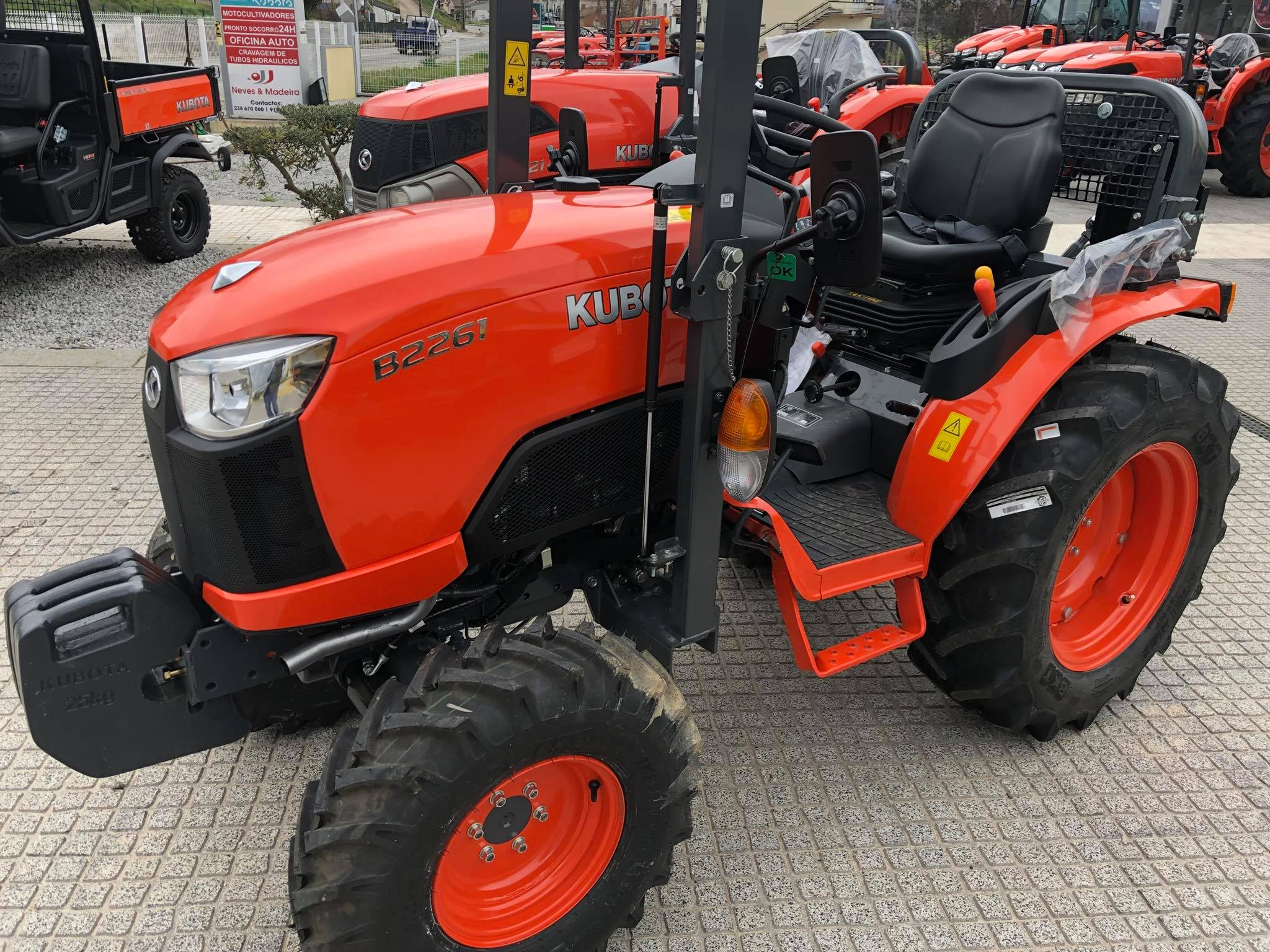

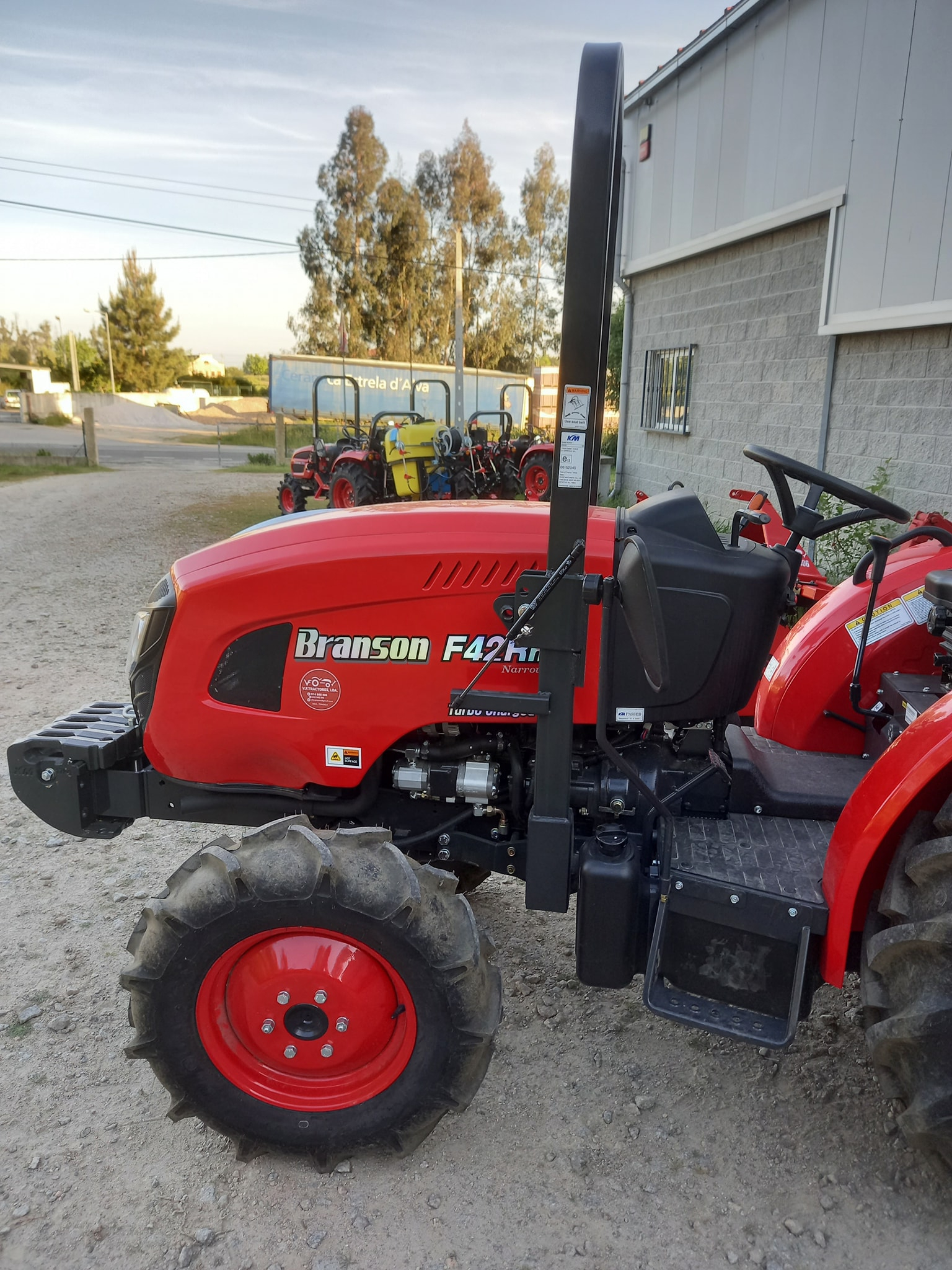

Around 2018 or 2019, I started seeing new tractors being sold with a gas spring assist for the ROPS so I assume it became mandatory for the tractor manufacturers to add a gas spring assist to lift and lower the ROPS here in Europe. I've never really dug much into that. Anyways, the idea was to hopefully make people lifting their ROPS when height is not an issue since there have been so much deathly accidents due to roll overs.
This mostly done on the mid mounted ROPS, since it's a lot more mass to move. I have yet too see the same gas spring assist on rear mounted ROPS though.
In todays world, tractor manufacturers really should just include a gas spring on all types of foldable ROPS. It won't cost them a fortune and I'm sure they have plenty of profit margin.
Here is a picture illustrating what I'm saying. Note the gas spring attached to the ROPS post. From what I've seen, when lifting the ROPS, once it goes over 50-ish degrees, it will pretty much lift itself all the way. Before the 50 degrees, it's still an effortless lift that can easily be done with just one arm.
   / Must Tractor ROPS Be So High? #76
View attachment 731931 View attachment 731932
Psssttt,,,, your ROPS is in the wrong location.... :D
This is truly the first time I've saw a ROPS in that location.
Thanks for posting this Pedro!!!! :cool:

First time seeing that too. Does the ROPS need to be upright to open the hood?
