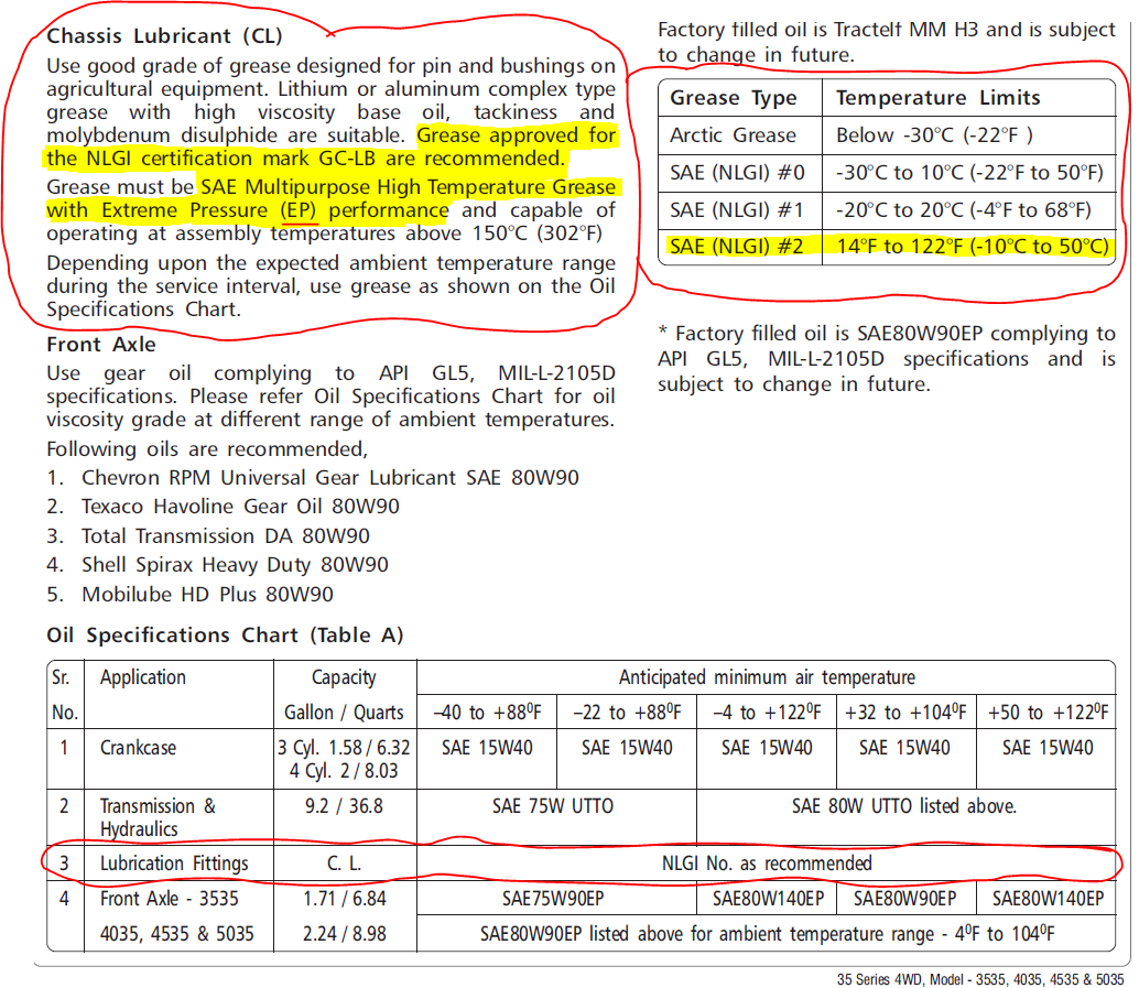

Ok, I've been studying the lubrication stuff on everything for a while tonight and am not sure I understand what I'm finding. First, I need to lubricate more than I have! I found the following in the 3535 manual:
I highlighted and such - but I don't know if this means EP2 or not. I see that SEA (NLGI) GC-LB is recommended. None of the temperature limits really fit out area - but if I had to pick, we probably fit into SAE (NLGI) #2 the best - although we have been as low as -20F (-32F with wind-chill). In summers, we can get near 100F. So... Anyway, does this mean EP2? Or just EP? The Lucas Grease I listed earlier says it is NLGI GC-LB and has a high operating temperature and has exceptional extreme pressure characteristics. See Datasheet here.
But, I cannot find any real specs in the backhoe or loader manuals. The BH says "...with SAE Multi-Purpose Lubricant or an equivalent SAE Multi Purpose type grease." That is the only reference to grease type I could find. On the FEL, the only thing I found was "...use only high quality lubricants". I couldn't find any other references in the Operator's Manuals of either of these units.
What do you think? Does 3535 not need EP2 across the board? Am I missing something somewhere in the manuals?

On the way to TSC today to get this stuff - although - I'm still not sure about which grease to get as my manuals are clear as mud on the topic. EP, EP2, NLGI #? - Sysop says EP2 stated in his manual, but I can't find where it says that in my manuals. Unless SAE (NLGI) #2 is EP2 - but I'm inclined to think not, as the #2 seems to be an indicator of ambient temperature ranges more so than assembly temperatures and stresses. I will take my spec sheet to TSC and see what they think too.

I use oil, grease and hydraulic fluid sold at Tractor Supply for my Mahindra 5525.
The motor oil is rated for use in diesel engines. The weight is what's recommended in the user manual.
The hydraulic fluid conforms to the John Deere 303 spec (per my dealer).
The grease is Mystic brand.

I also use Mystic JT6 It is a high quality lithium based grease. There is nothing about the pins and bushings in your FEL or BH that requires any more than for them to be slippery.
I buy the Mystic mainly for trailer bearings,it is a good all purpose grease, so it is my only grease.
