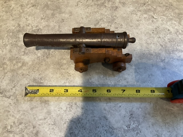

Ball is about 10 inches from lip of barrel

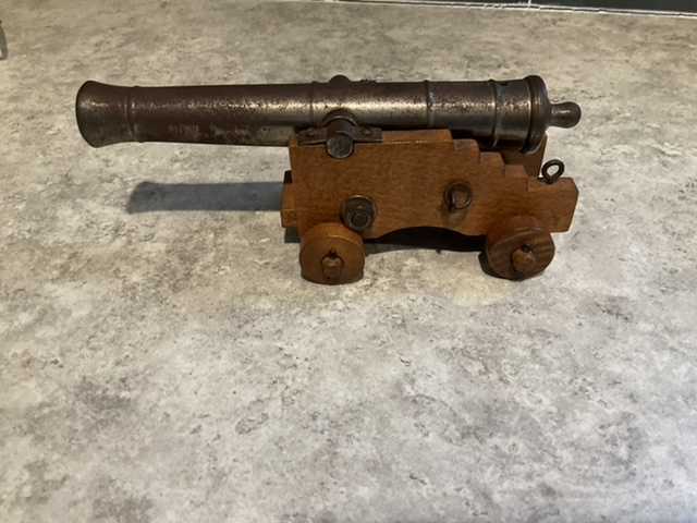

At first glance of the thumbnails I thought “hey, I have one of those”. Not quite. :)
Mine is .45 caliber I think. It was a Christmas gift 40 years ago and came as a kit. Never had the balls to fire it. That’s probably a good thing.

From what i can see it looks like a deck gun off a ship or a wall gun from a fort wall . Looks like a 3 inch bore . As some have said i would use lots of solvent to try anloosen the round up , Since it is so close to the muzzle i would get a long drill bit and drill a hole in the ball run a long lag bolt or some type of threaded rod into the hole and slowly work it out. I pulled many a musket ball during my reenactment days by using a screw end on my ramrod.You will need cannon powder or 1F to fire that, If that is an original cannon it would be worth quite a bit, I would not want to damage it.
