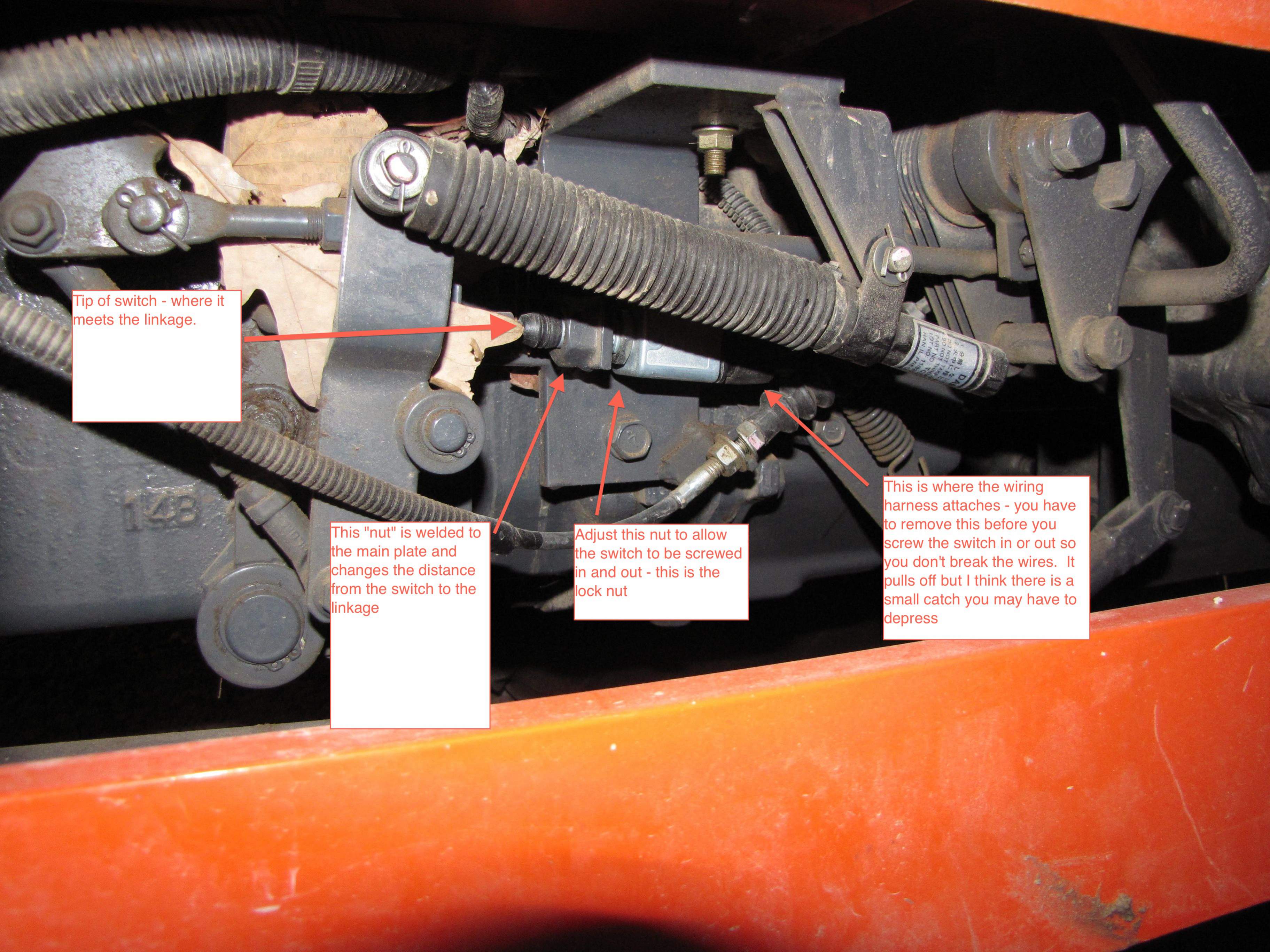

I understand the point of the switches but they sure can be a big pain in rear! Glad to hear yours is working, but if it needs adjusted it is under the left floor board (if sitting on the tractor) and has a lock nut that screws in or out to adjust it. It is easier to adjust it than haul the tractor to the dealer :)
Can you post a picture of the nut you are talking about? Thanks
   / MX 5100 Fuel Problem #13
Here are two photos and I added some text to give a little more info. Hope this clears it up!
