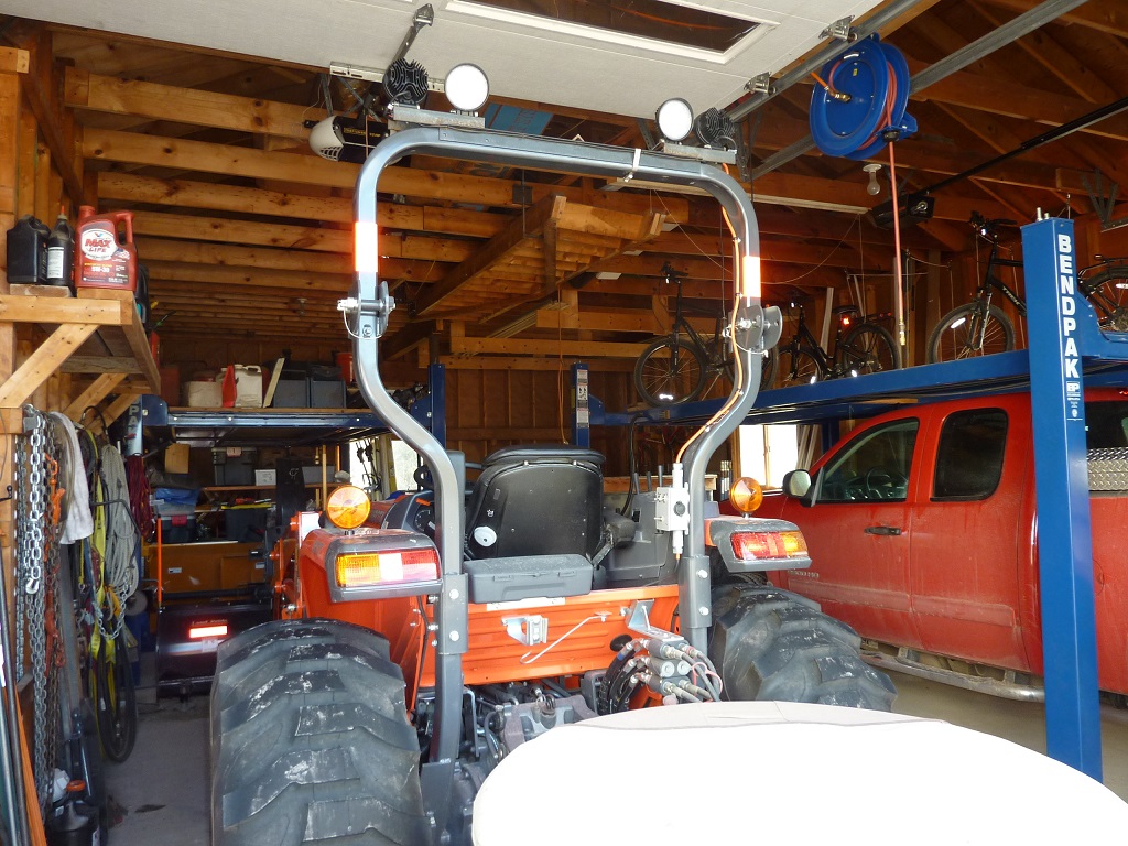

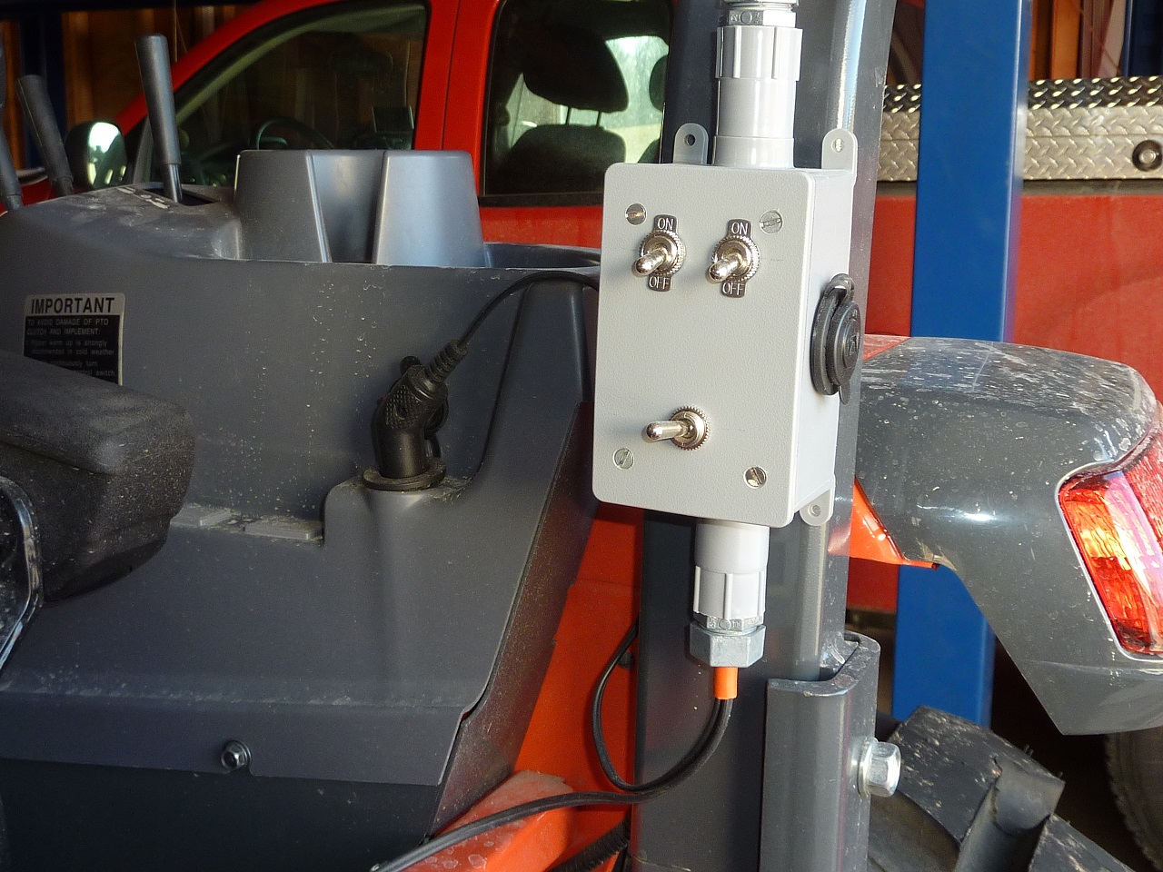

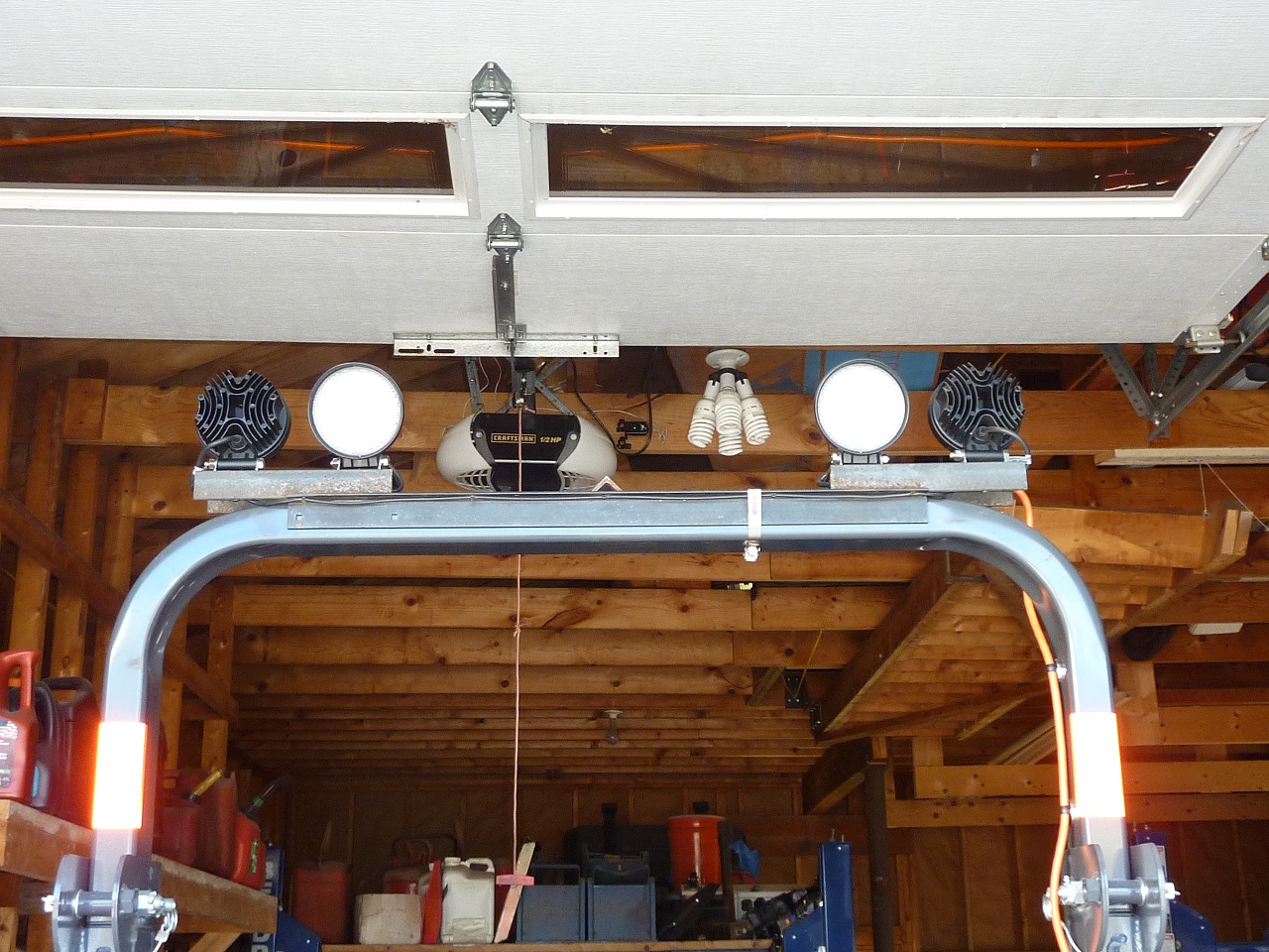

I have a 4 LED light bar that I use on both my MX5800 and L6060. I used a standard PVC electrical box with magnets screwed to the back. It mounts on the ROPS of either tractor.
The magnets hold the box and wiring firmly in place. Takes about 2 minutes to swap the rig between tractors.
I also added a cigarette lighter jack on the box to power other low wattage devices.
