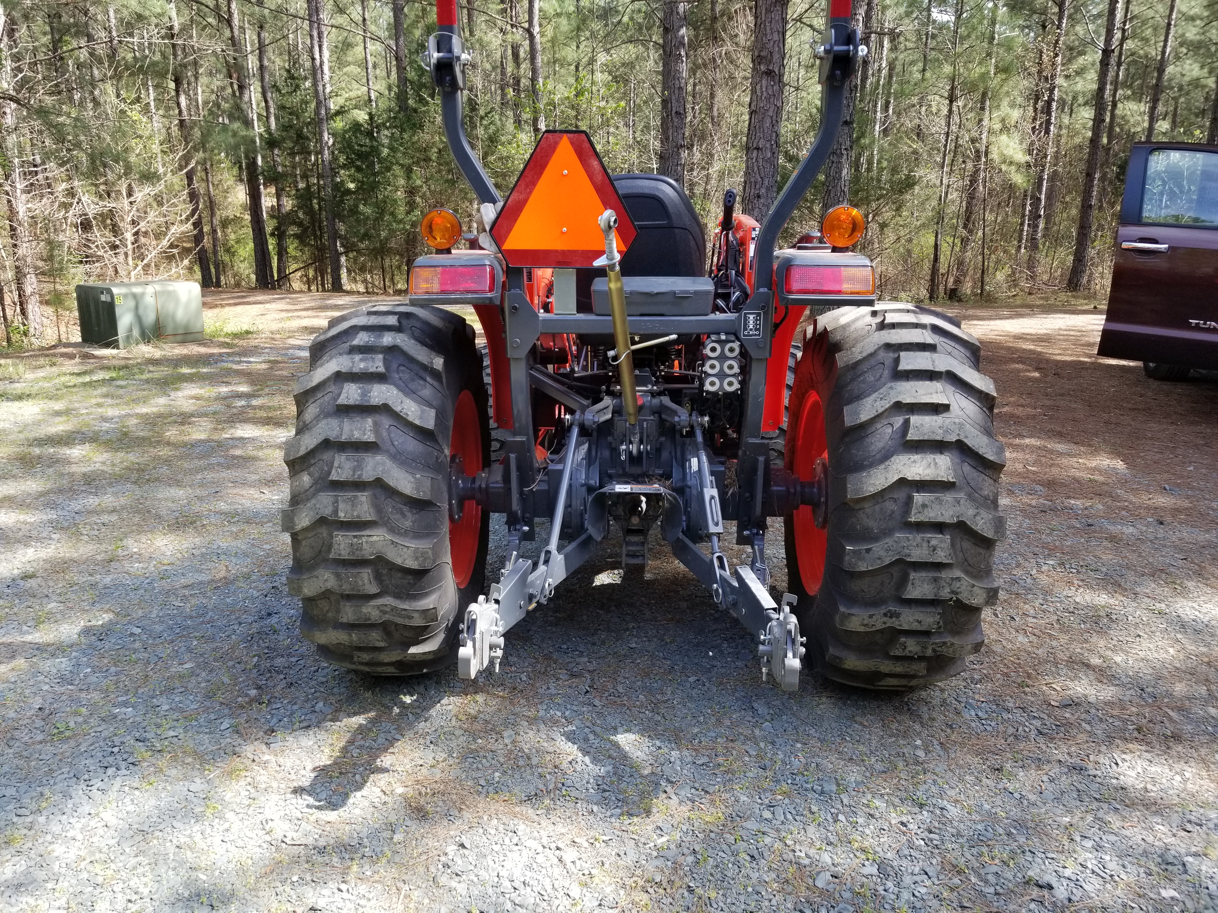

Coolbrze, you wanted some pics of our MX5800 front and back. Here you go: The first pic is obviously the view from the rear.

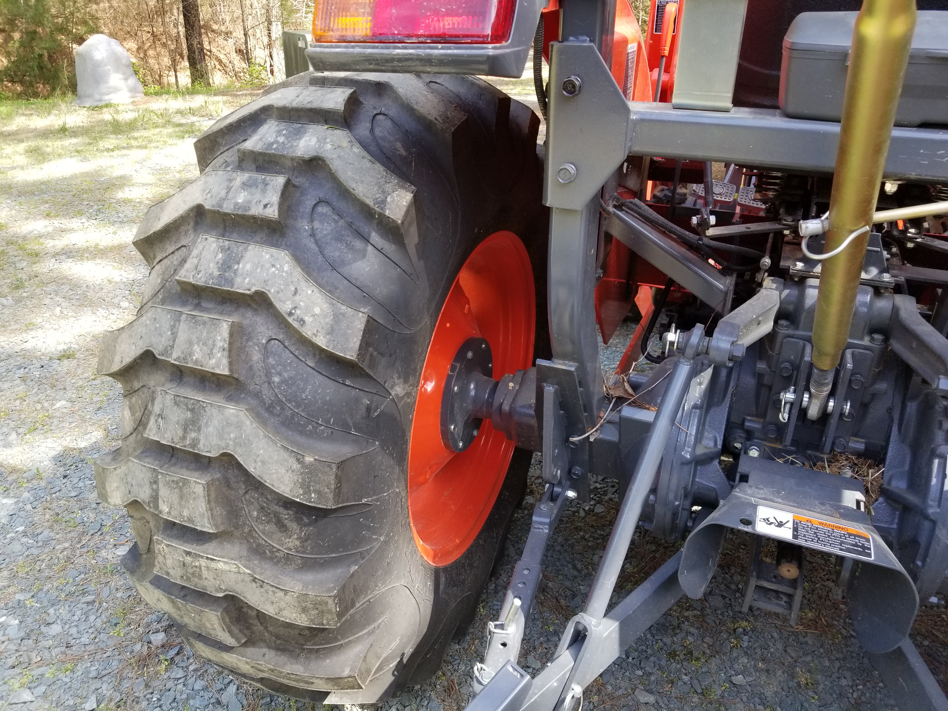

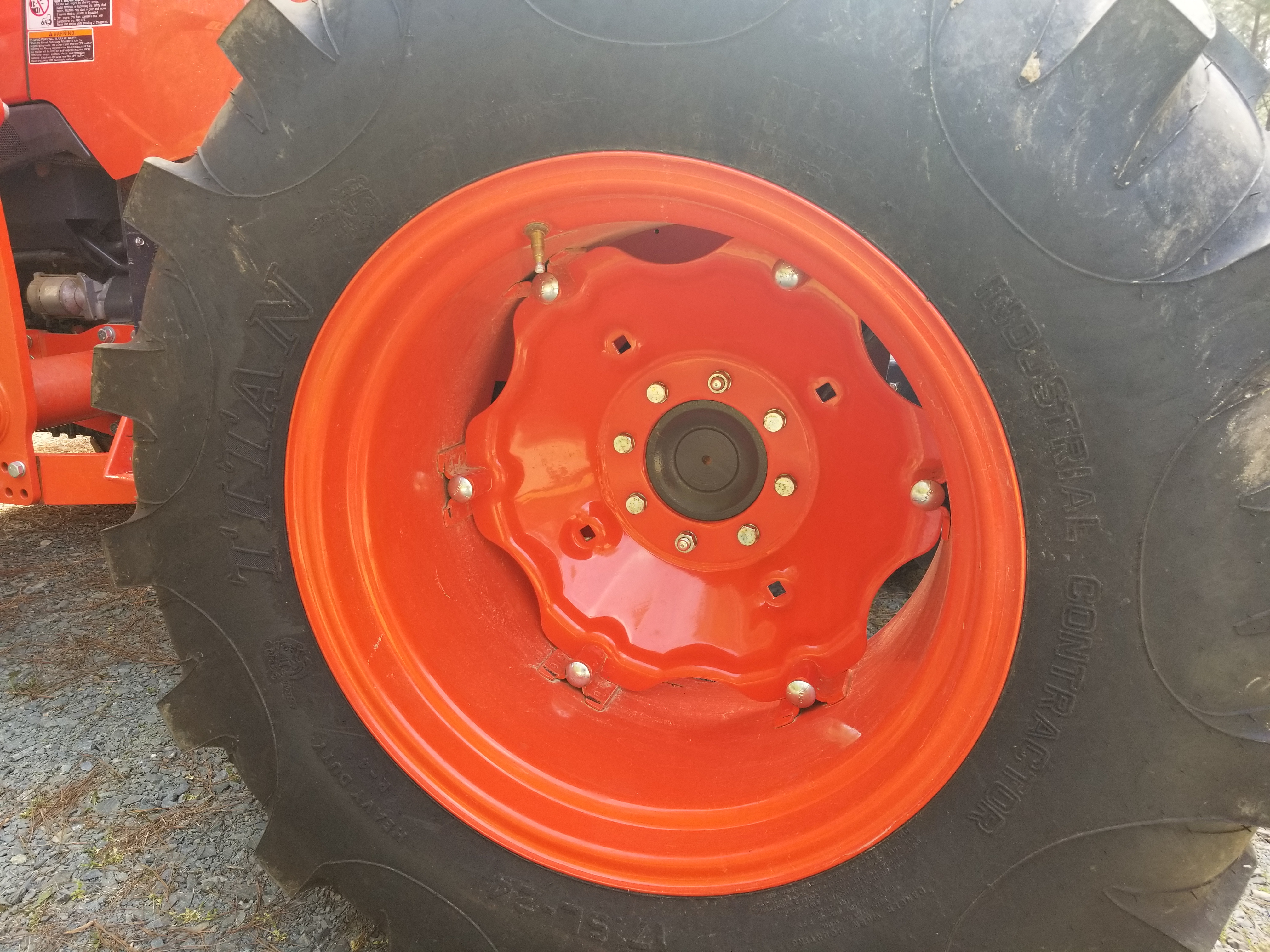

The next two pics show a rear wheel from the inside and the outside. Hopefully you can see how the rims are set all the way out.

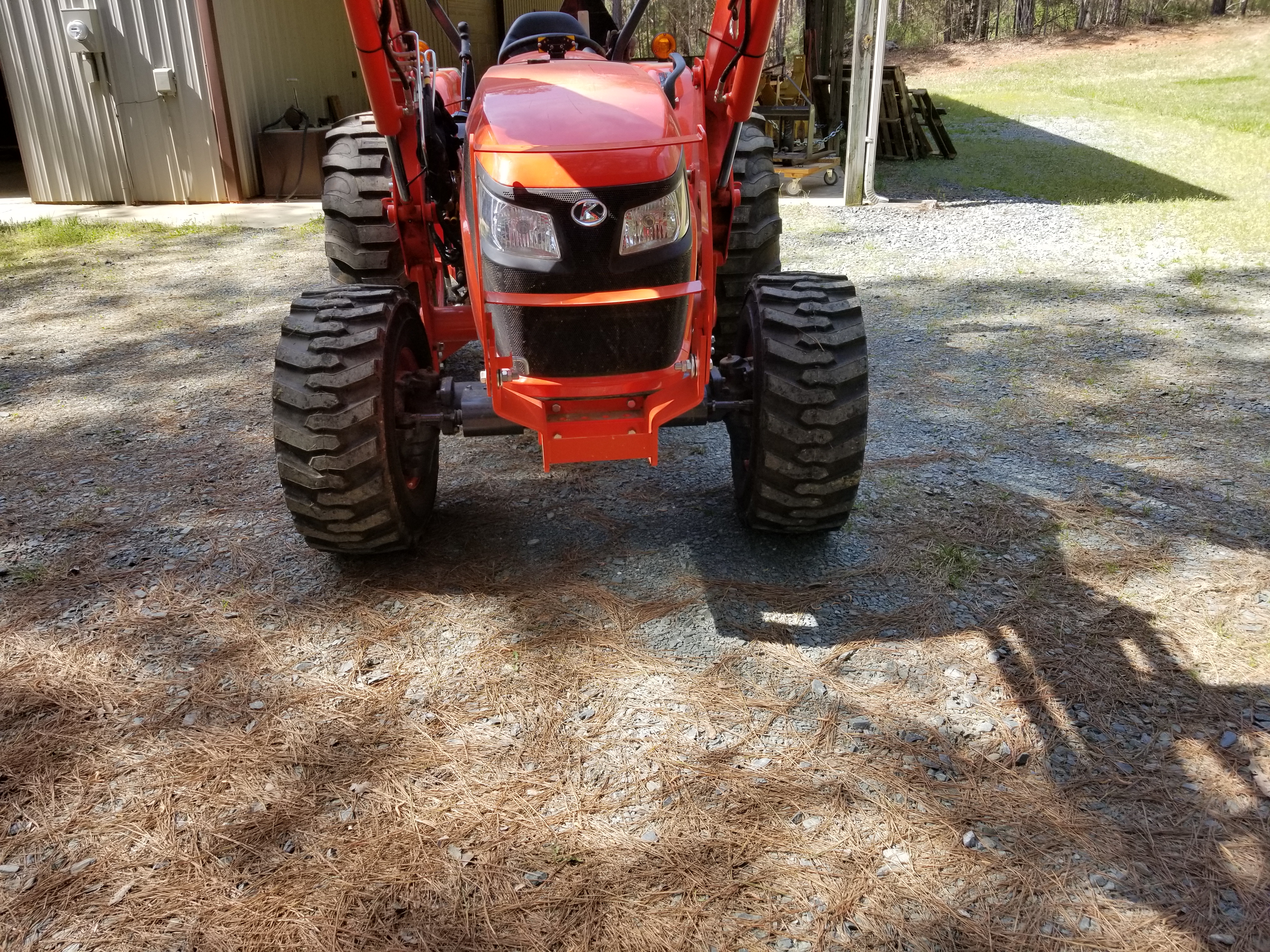

The next pic is the view from the front, as you requested.

Thanks rbtjr! Tires are mounted the furthest setting out & width is 78" correct?
   / MX series R4 tire width & filled rears #16
Correct about both. The tread where the tires hit the ground is about 77" because the tires are a little rounded at the outside edges. The sidewalls of the tires are about 78" or a td more, and that is the measurement I would use for purposes of buying a trailer.
