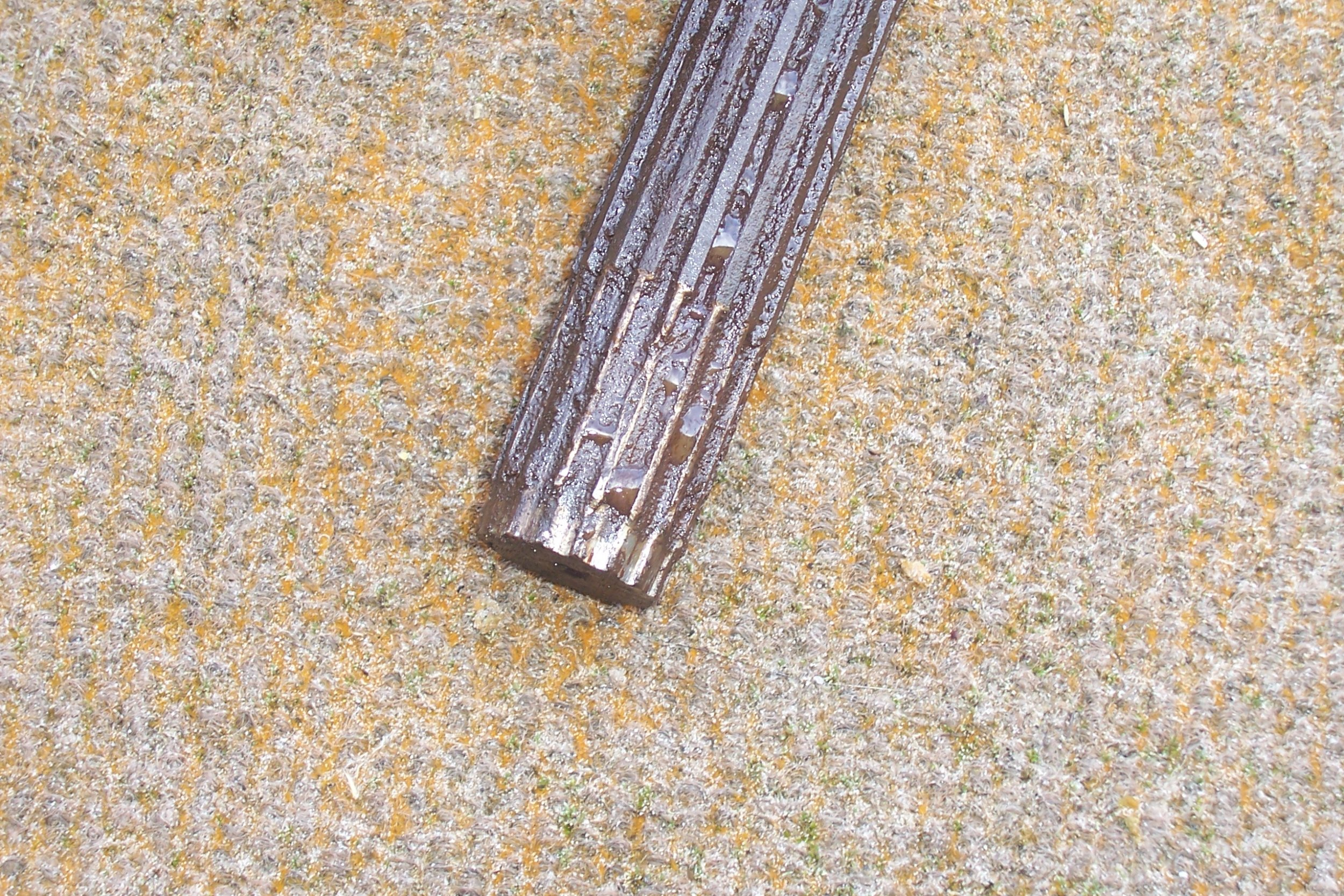

Next door neighbor has an MX4700DT which he uses hard.
(He also hasn't read the sig line here about taking time to maintain your equipment or your equipment will make time for you to maintain it.)
Anyway, I stopped in today and he has the front of the tractor off the ground (using the front loader bucket) and a bunch of parts scattered around. Did I mention he's wearing a LONG face? Well he is . . .
Tractor runs fine in 2wd, runs ok in 4wd as long as it is going straight, but when you turn in 4wd, it makes nasty, expensive crunching and grinding noises from deep down inside the back end of the tractor.
Dealer cheerfully advises "Bring it down and we'll do diagnostics for you!" I'm sure they will, I'll tow it right down behind Dear Bride's Subie.
He's thinking he broke something at the rear end of the drive shaft to the front diff. I'm not so sure, because I'd think it would make noises in 4wd going straight as well, but I really don't know what's inside there although I'm guessing it is a) hard to get to (he's going to split the tractor in the next couple of days) and b) its going to be expensive (assuming he can even get the parts in some reasonable time frame).
I asked if he had found any metal in the gallons and gallons of hydraulic fluid he's drained out, and he said "No, not yet."

Well,... the only way something changes when it is being turned compared to straight line is that the differential in the rear end is involved. So that says that inside the rear end there is broken hardware between the normal rear end function and the drive headed to the front end via the drive shaft. Not pretty to picture. That's why the thing is being split. Most Harry Homeowners with a tractor for fun are not ready to do that kind of repairs -- one wonders if he has the experience/ability figure out what parts are broken much less how to remove replace -- even of the logistics of getting the parts is solved. Good luck to your neighbor...

Sounds to me like indiscriminate use of the locking rear differential to me. I bet the locking pins are sheared off and are doing damage in the rear case.

Stopped by, he wasn't there, but he has the front axles out and the wheels are turned 90 degrees. I suppose that makes for a great turning radius. I'll report back on what he's found.

Why would you remove the front axles when the noise is in the back end?
This is gonna get interesting I suspect.
   / MX4700DT nasty, expensive noises
I have no idea why he pulled the front axles, but I will ask him later today. He wasn't there when I stopped by so it is possible he found something and has taken a ride to the Kubota dealer for parts.
Stay tuned . . . you're right, this may get interesting indeed ;-)
