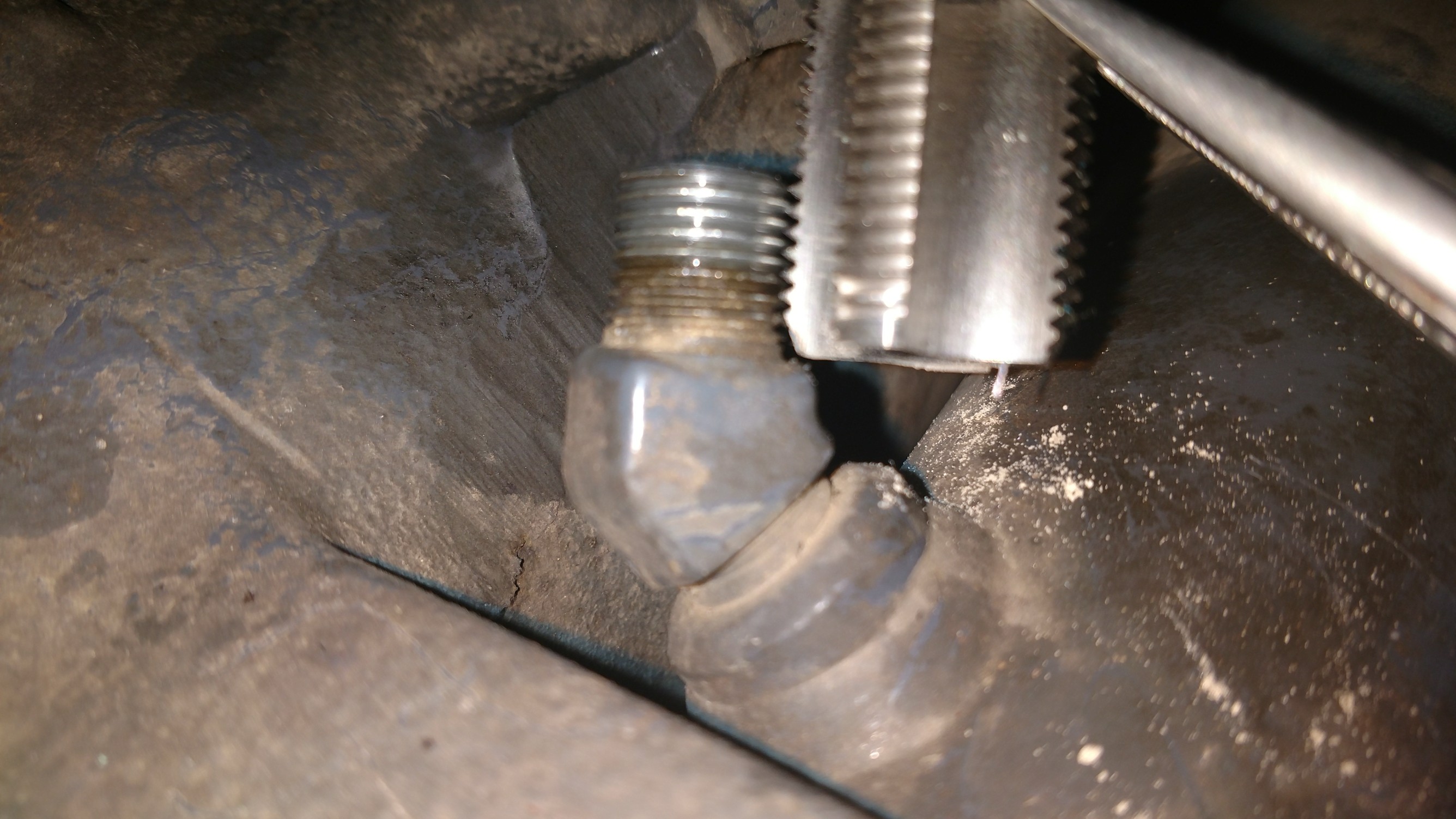

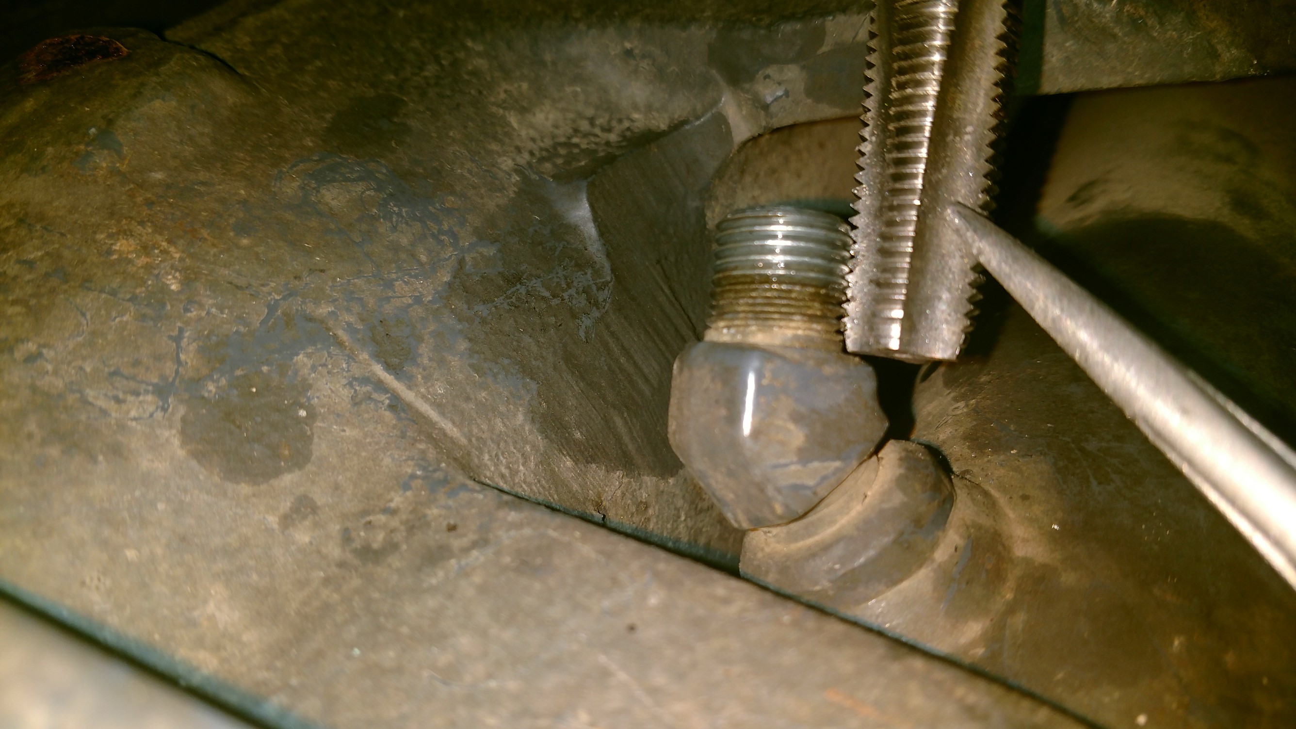

Forgot my thread pitch gauges at work, but who needs them when you have taps.
1/4-18 for reference
And here is a metric tap with a 1.5mm pitch

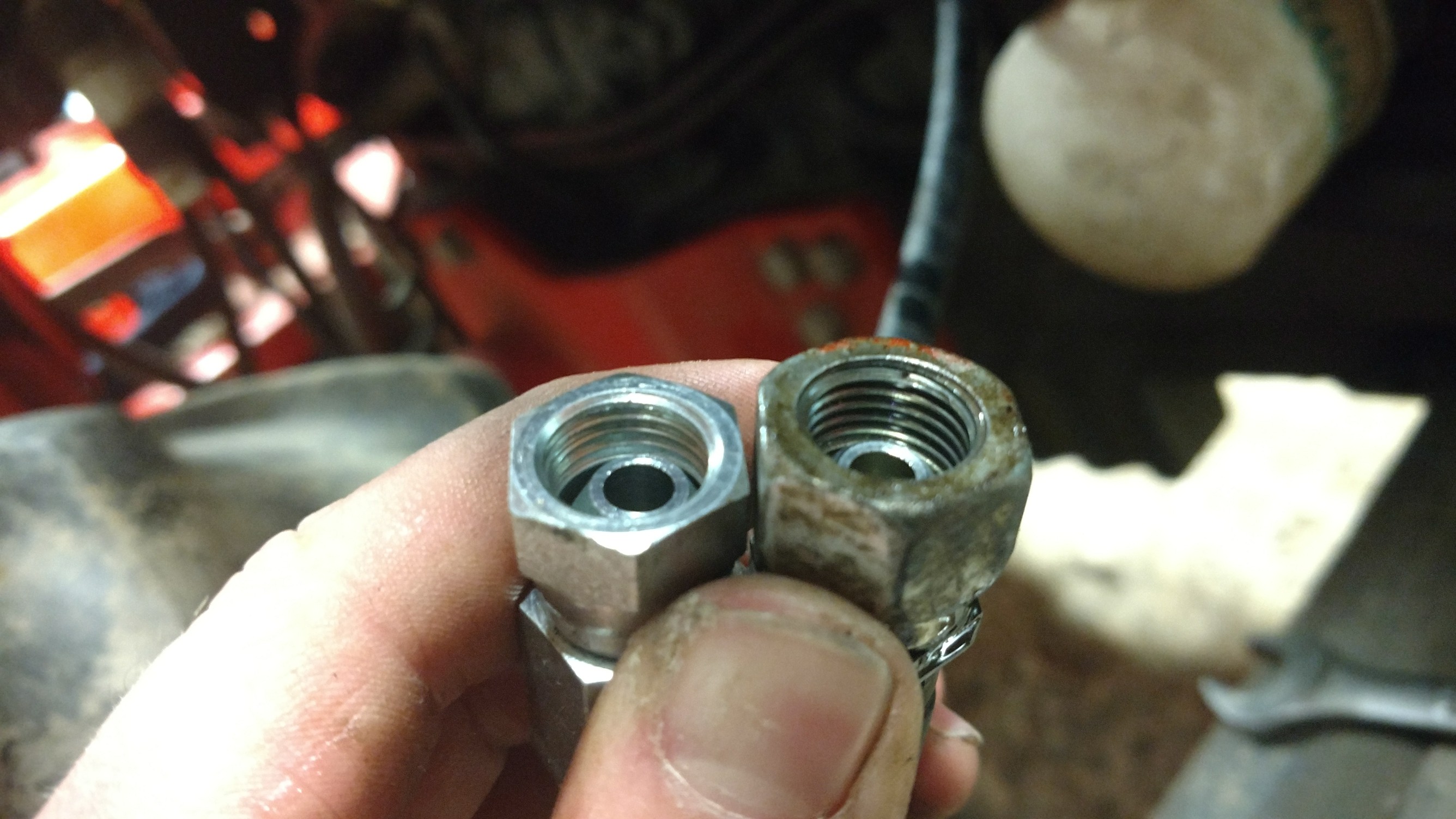

I think 1/4-18npsm is what it is. Here is a fitting vs the hose
Fittings go on and tighten properly. So that's what I'll use and I am confident it isn't gonna leak.

Just an update, installed hoses with NPSM ends. No issues and no leaks. Everthing tightened down as it should
