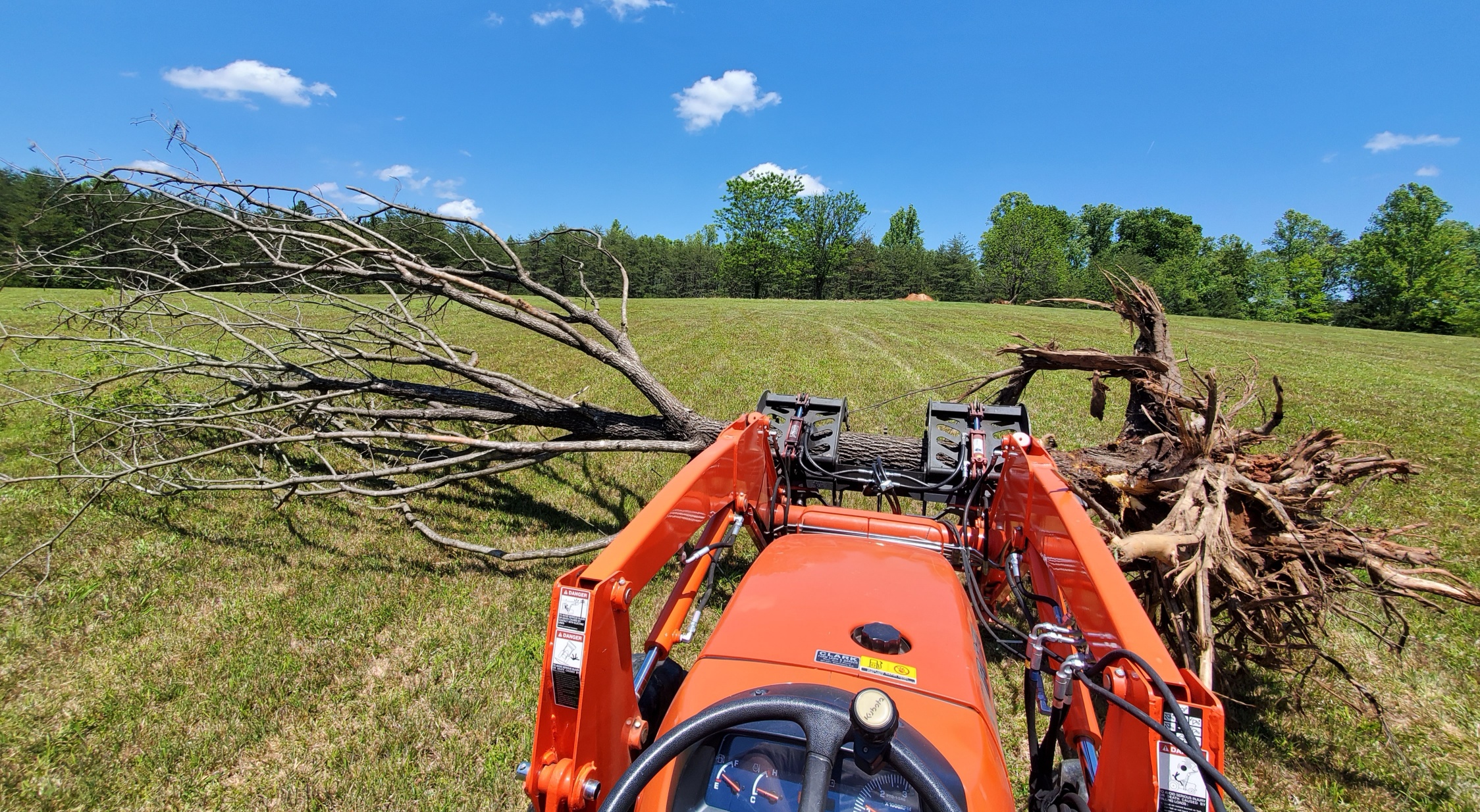

My tasks are similar, if on hills. Loader work, grapple work, field brush hogging. I haven't had any issues with using my grapple to do root raking or push brush along as I scoop up a lot of cut stuff. But again, nothing to compare it to. If the loader/grapple are applying force, you'll definitely hear the tractor working harder, in fact it's something of a clue to me about how much I'm engaged with the ground.
