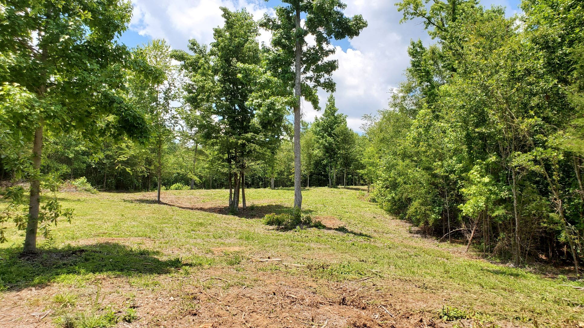

Hi deelowe,
We have a Woods BB720x, which I highly recommend. It can cut 3" diameter items and I definitely know that hubby has easily cut 2" diameter saplings. They don't sell them anymore (may be some new "old" models left, but I think Woods now sells this as a replacement BB72.50. We added the chains.
. Pictures are of our MX5800 w/Woods BB720x and another of the before/after and then an after. Hopefully you can tell that the left side of the picture is the before/after. :) You can see the Kubota way in the back.
