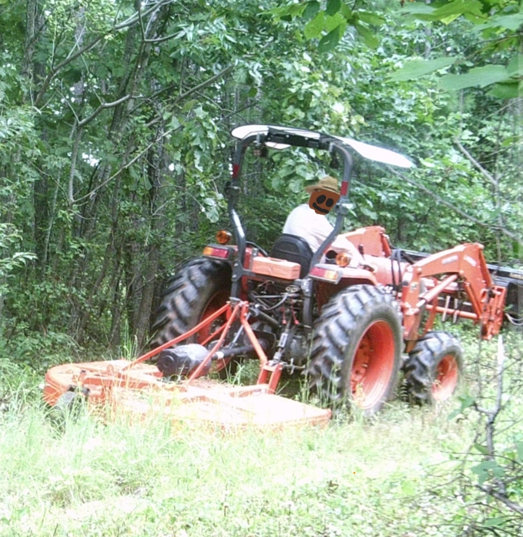

   / MX5800 rotary cutter opinions #8
Trust me I use it well for hogging, even tho it looks like I only need a mower in this pic. It's the only pic I had of the 6' cutter
