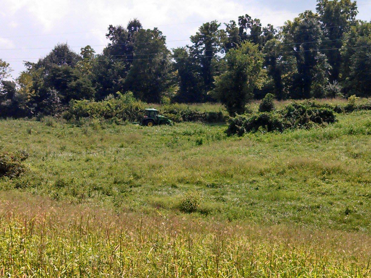

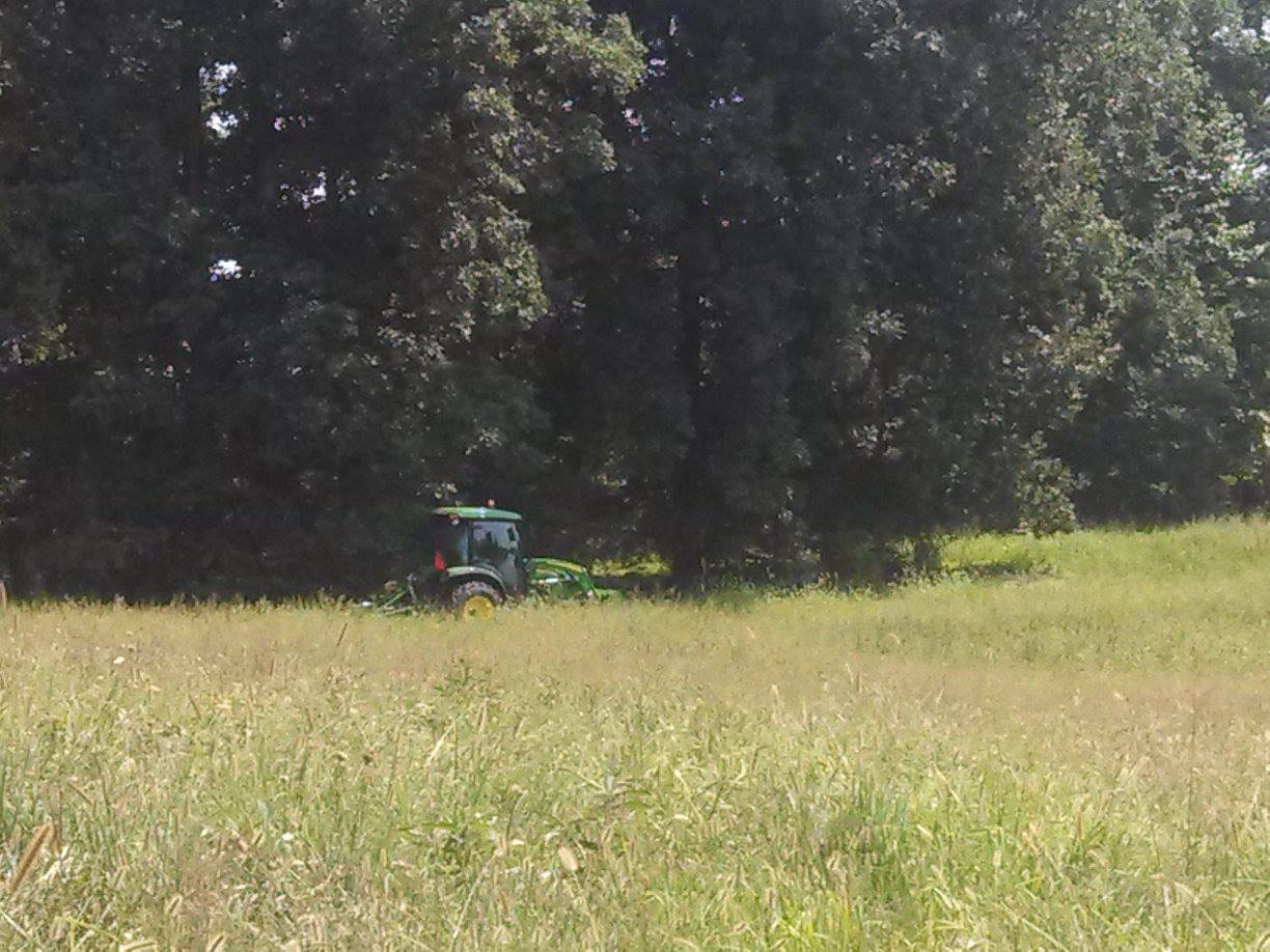

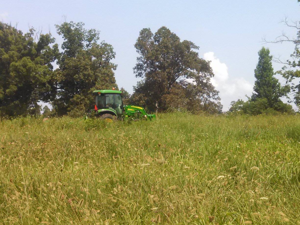

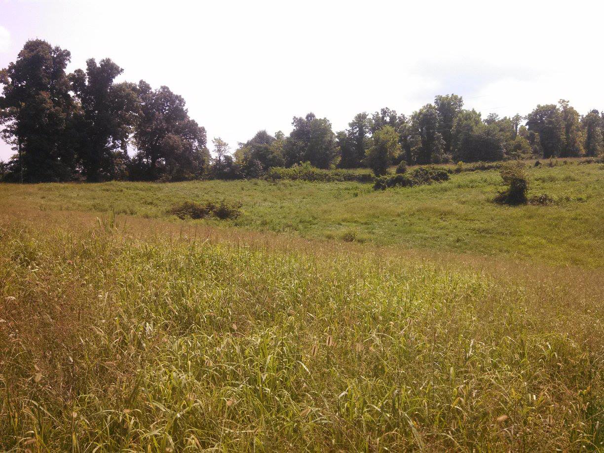

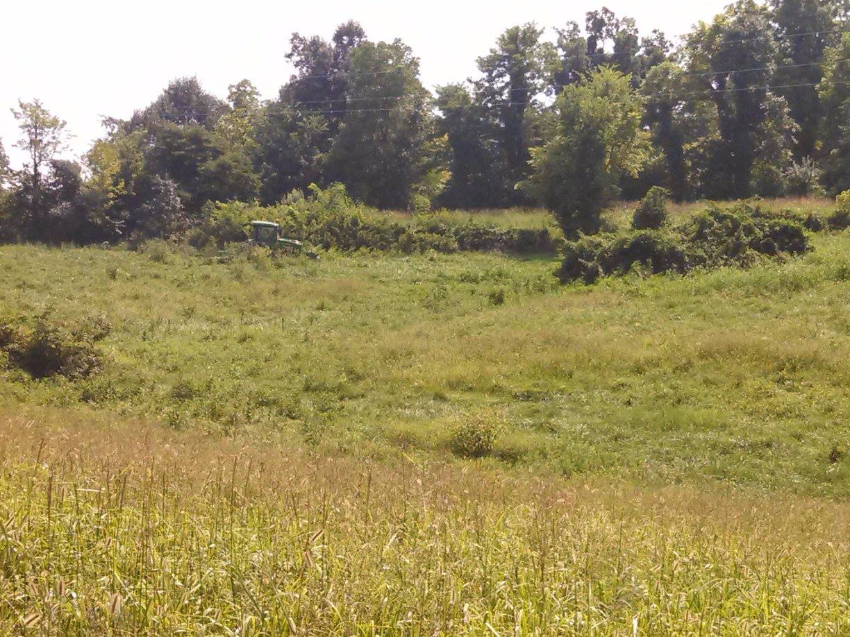

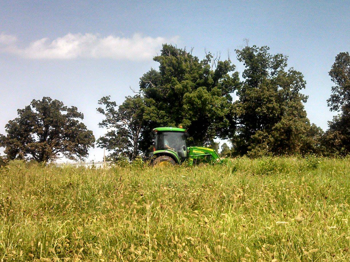

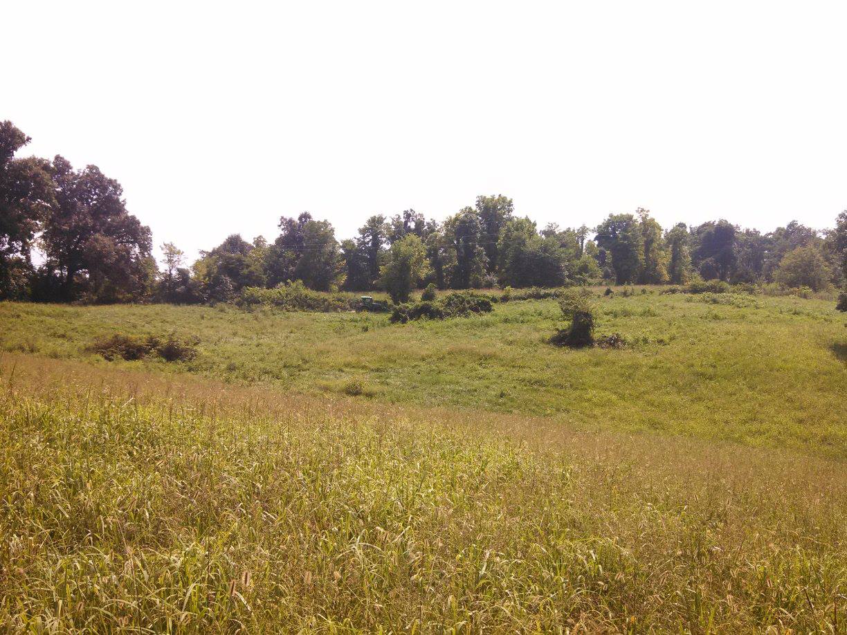

Yep, 3520 with cab. Here are some pictures from the mowing yesterday.
   / MX6 Engagement Noise w/ 3520 #28
Holy crap. That looks pretty thick.
Raise the mower up some and mow it a couple times. Lower it down on the second pass.
