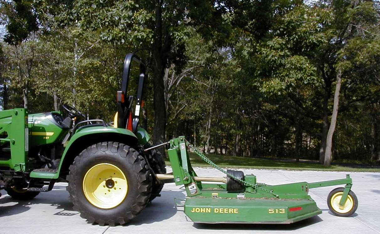

I've found the hydraulic top link (invaluable addition I might add) along with chains in place of the solid supports works real well. Leave enough slack in the chains for the cutter to ride on the tail wheel but lift 3 ph and shorten the top link in combo clears most obstructions and is good for road travel.
Pic before addition of hyd top link.
