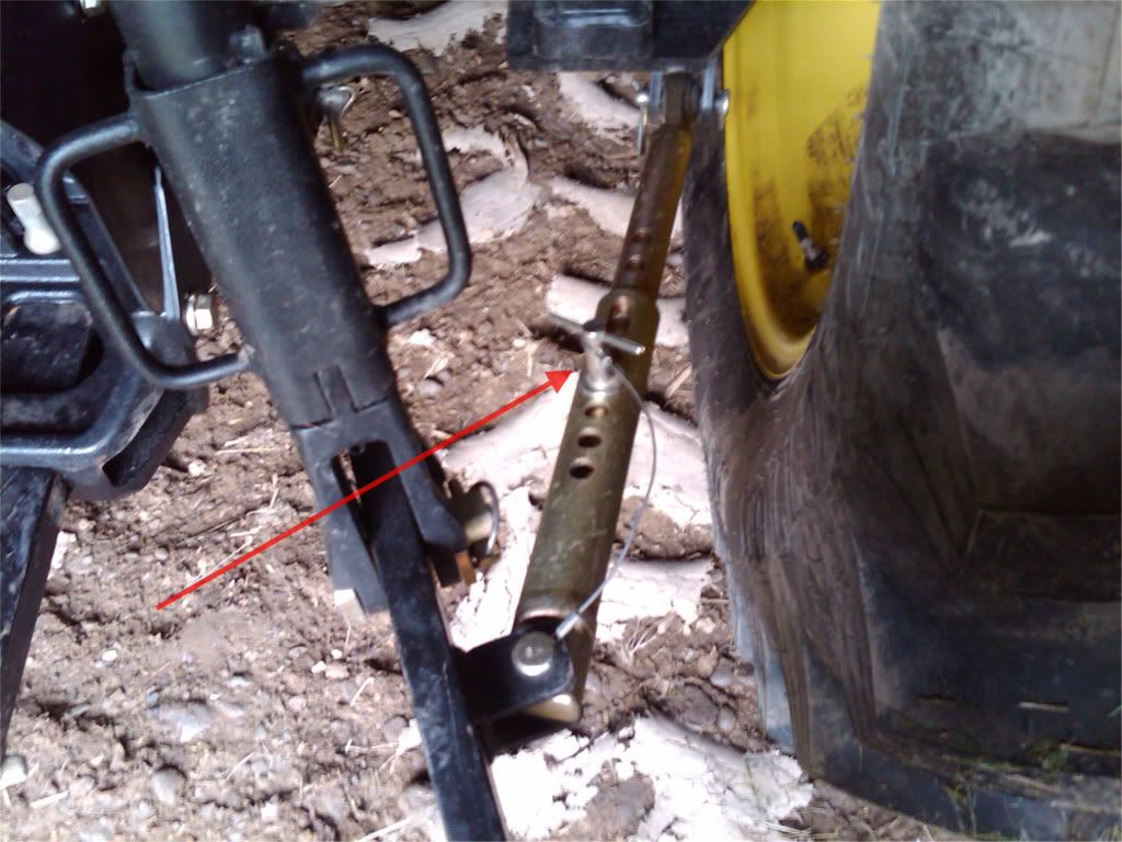

/ MX8 cutter snapping stabilizer bars? #30
Heres a pic of mine after my dealer did mine....under warranty of course....One big question....The pin doesnt reach thru the hole as the round bars are thicker than the old square ones, did you get longer pins? When I say dont reach I mean the ball bearing that locks in place doesnt reach all the way thru, its short by like 1/8 inch or so.....
/ MX8 cutter snapping stabilizer bars? #31
I will have to check mine. I got new pins with mine. I suspect they reused the old pins.
D.
#32
The short pins sound bad, thinking about the everything that can go wrong will philosophy. I see them popping out with use or travel if they do not go all the way through
