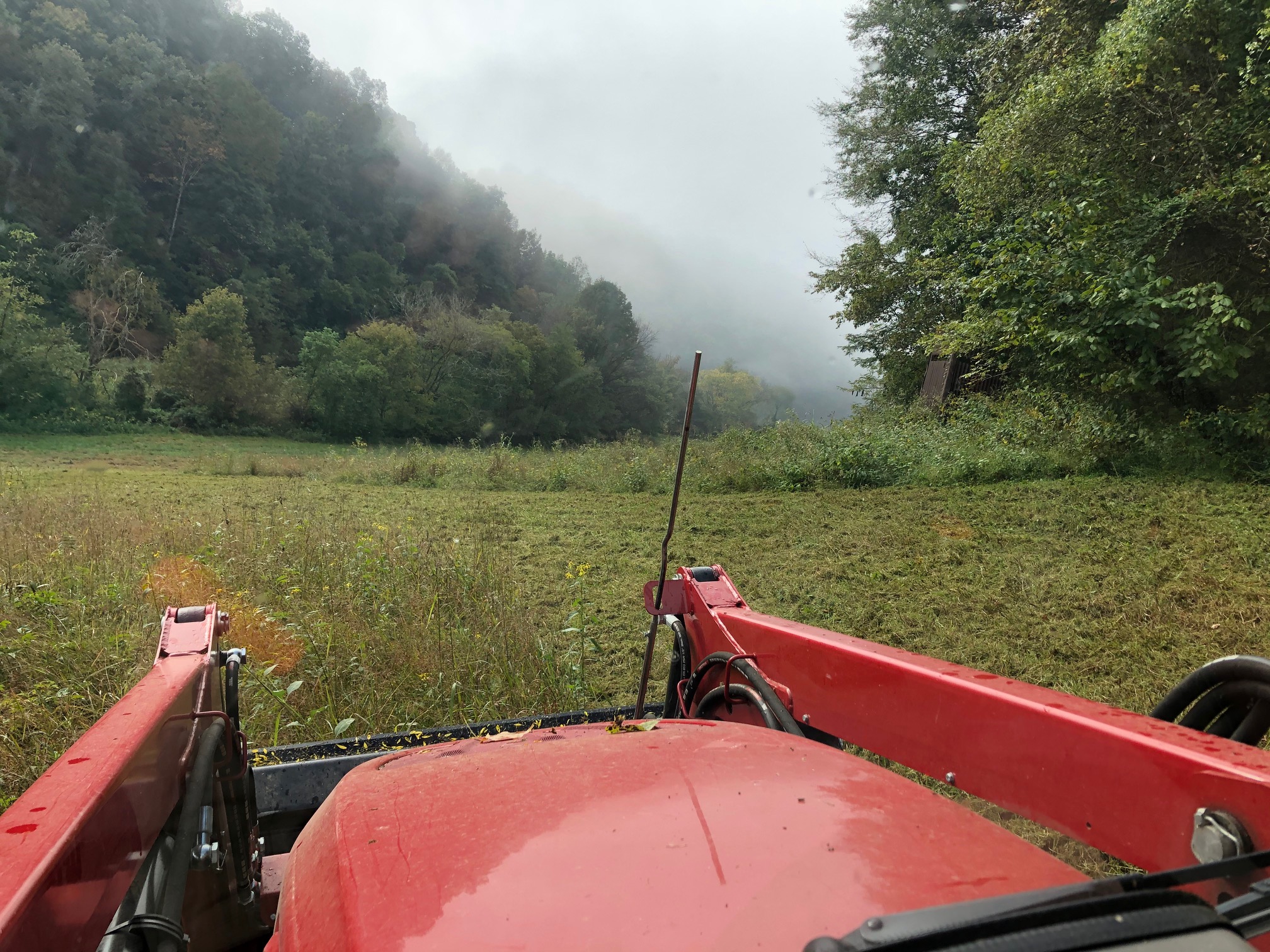

Almost 2 years into ownership and around 180 hours. The tractor is being picked up by our local Case dealer on Friday for a couple warranty items.
There's a real small brake fluid leak. I've had to top off the reservoir three times in the 22 or so months I've had it. Leak is coming from something underneath sort of under the driver's seat.
And just last week- the clutch started slipping and the clutch pedal is noticeably higher when at rest. Sounds like just a linkage issue, but the Case user's manual says "contact case IH dealer" in the how to adjust clutch pedal section. Since it's under warranty- they can take care of this too.
Otherwise, it's exceeded expectations.
