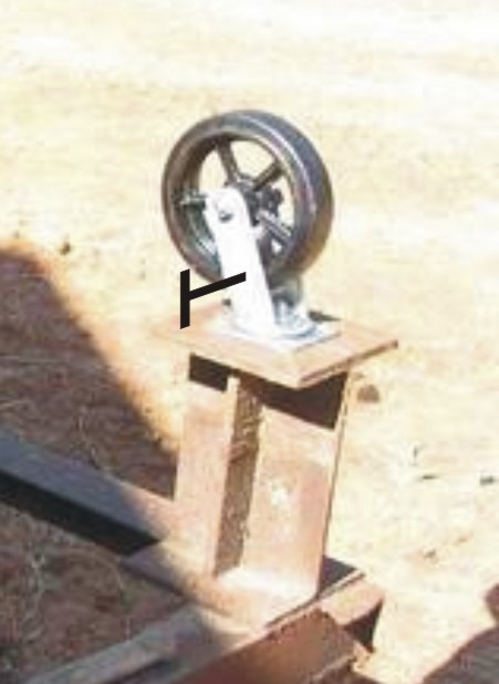

here is a simple fix for the wheel locks. Drill and tap a hole on the wheel support leg and make a tee bolt to jam the wheel
Simple and cheep:D
