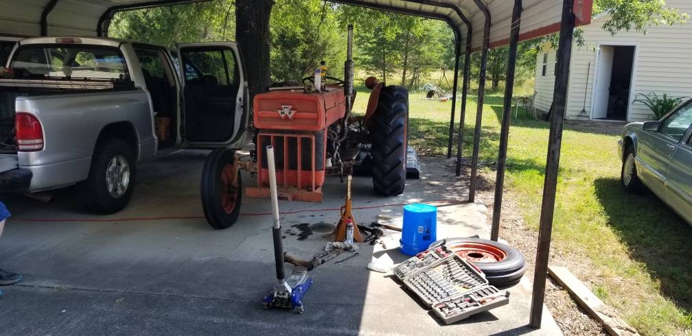

get that thing back together ASAP! Pretty paint won't make it work any better. These are rugged machine but you can do some damage if you "refurbish" too much at once. If you can't put it in the shed overnight, make absolutely sure those rubber boots on the gear levers are perfect. Thermostats are often stuck open on older tractors, if you have the fuel tank off it's worth checking this out.
