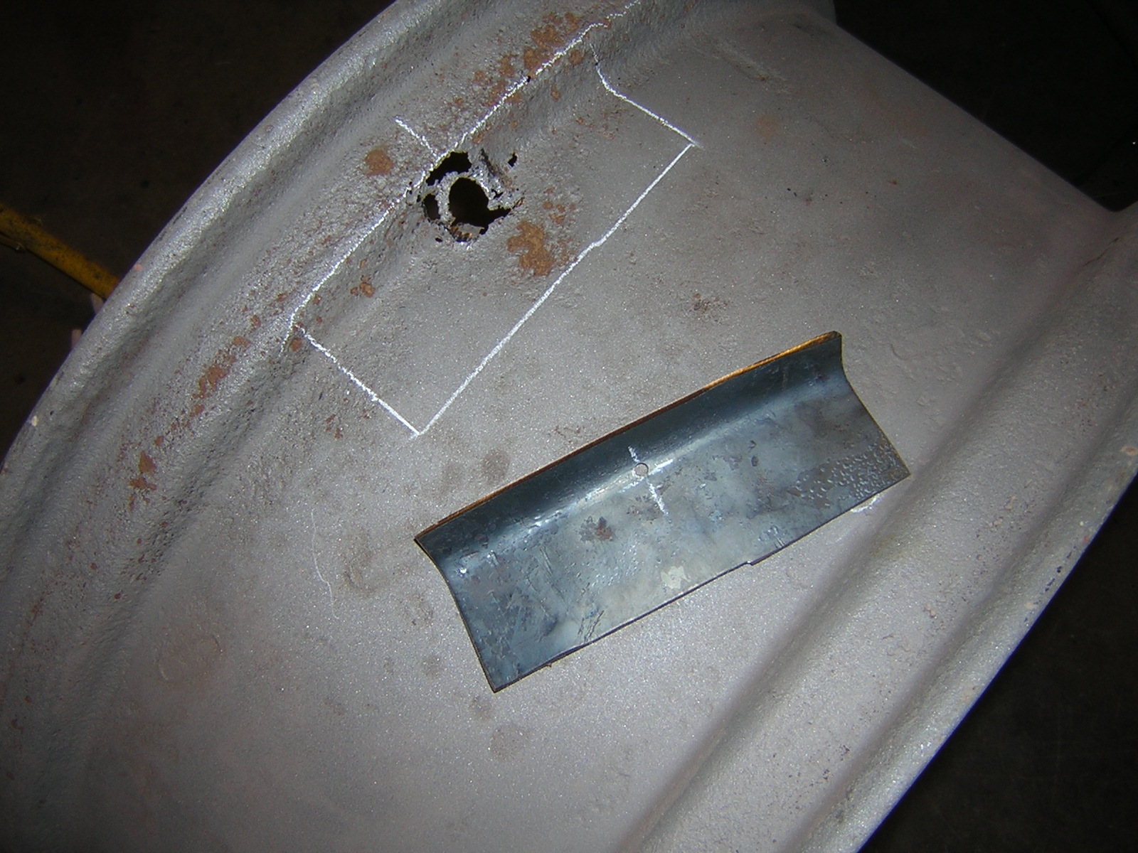

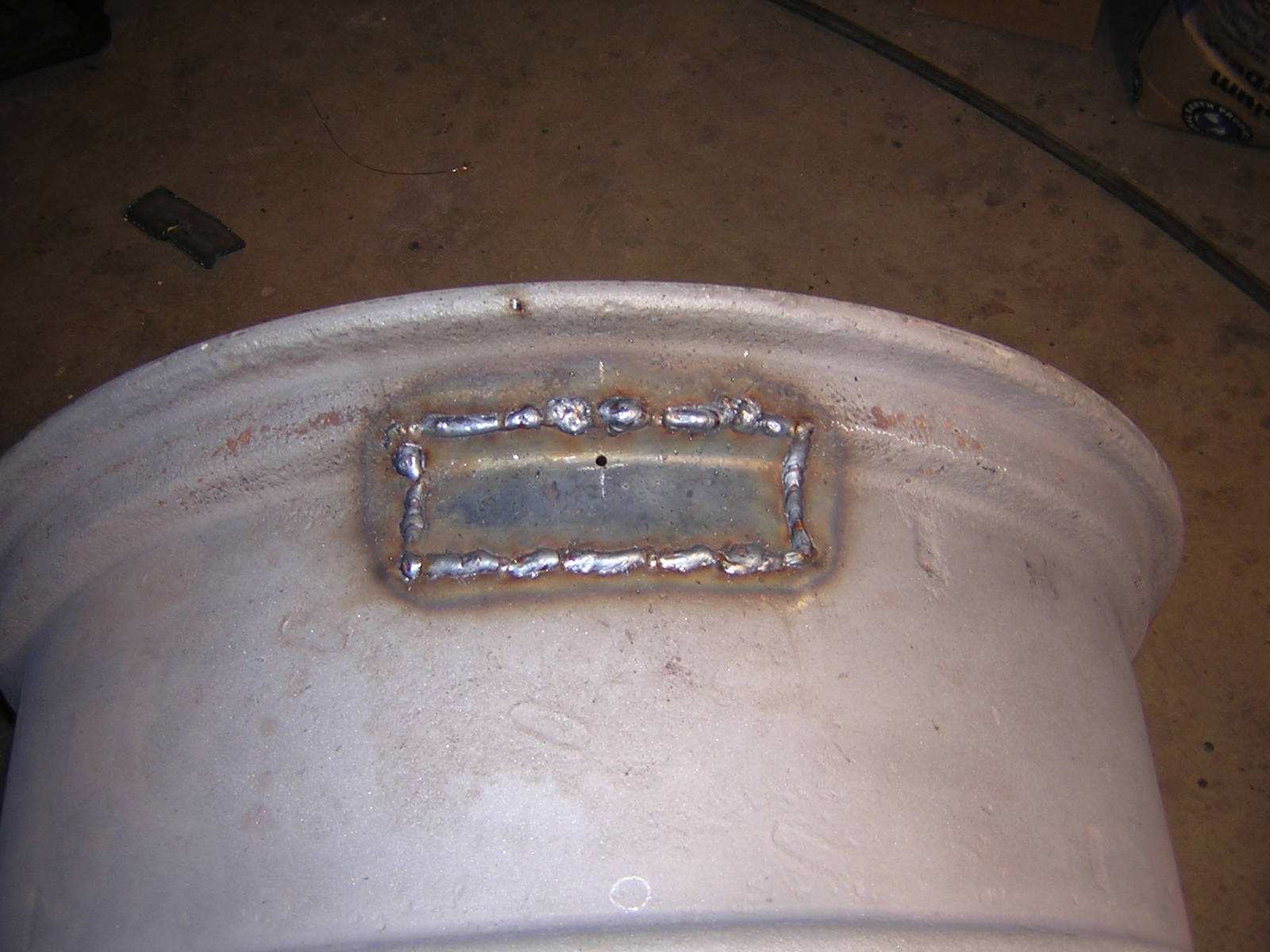

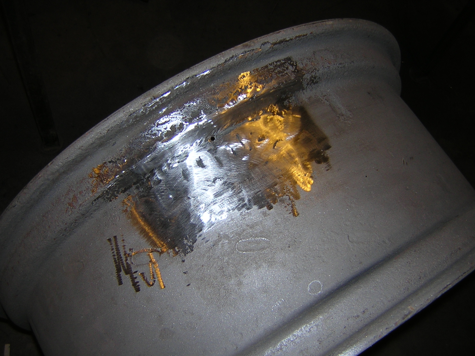

Unfortunately, the rear rims will need to be replaced soon due to heavy corrosion around the valve stems,
Great looking tractor! The rims on my MF 50 were rusted in spots from leaking salt water so I cut out the rot and welded in patches. Also had rims sand blasted before painting. Worked fine and cheaper than buying new. But I guess you do need a welder. Anyway best of luck with your tractor.
