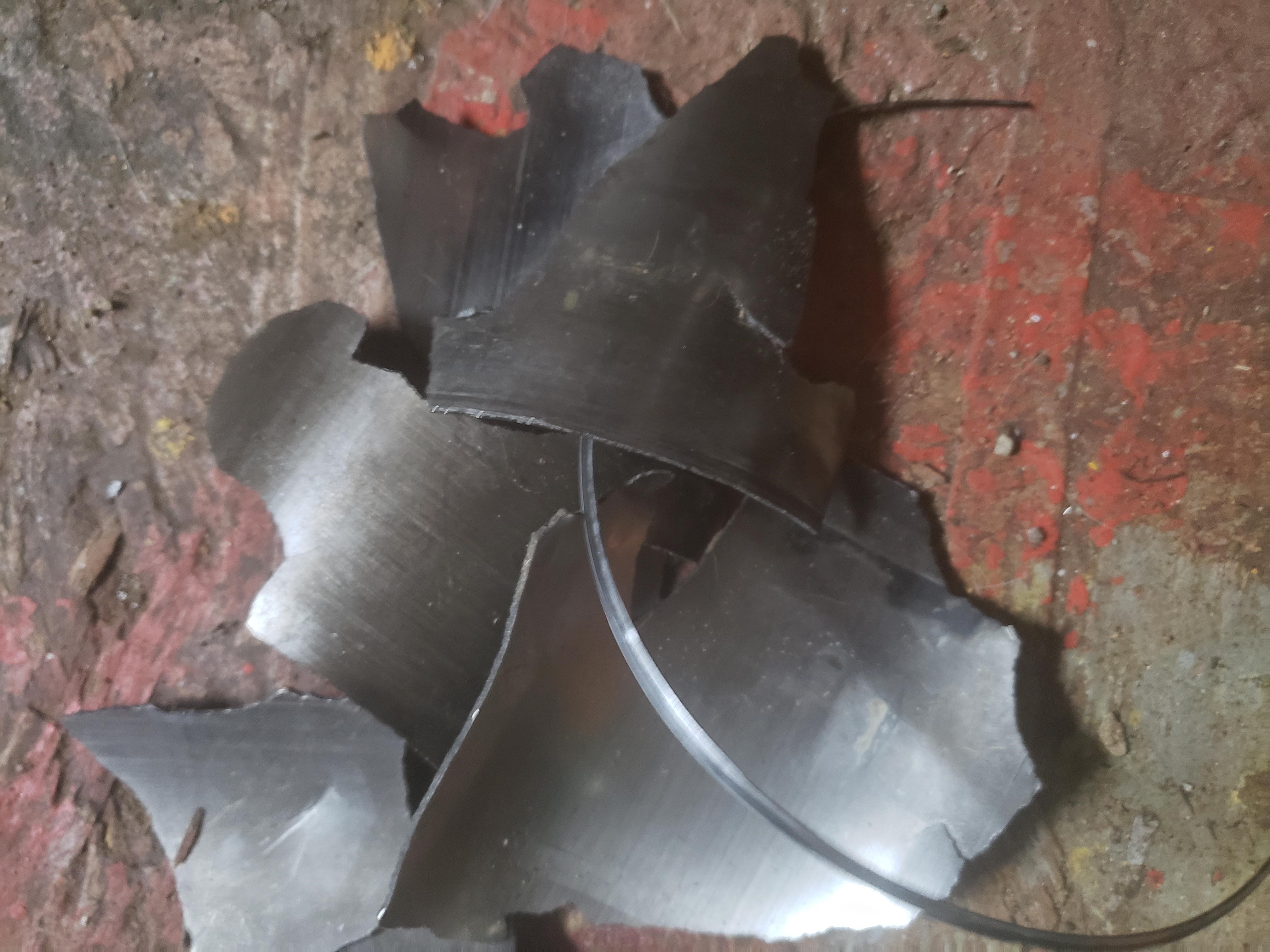

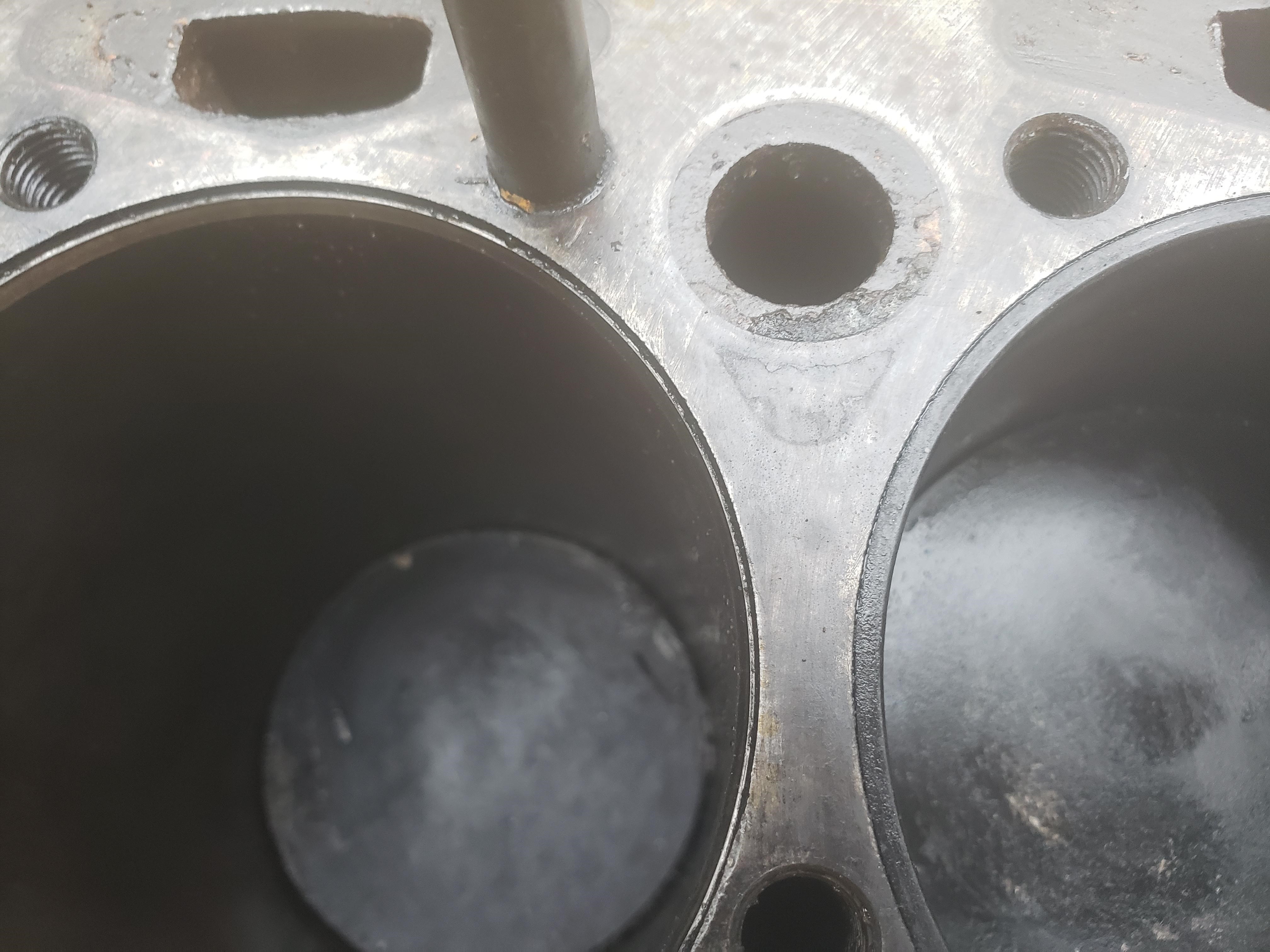

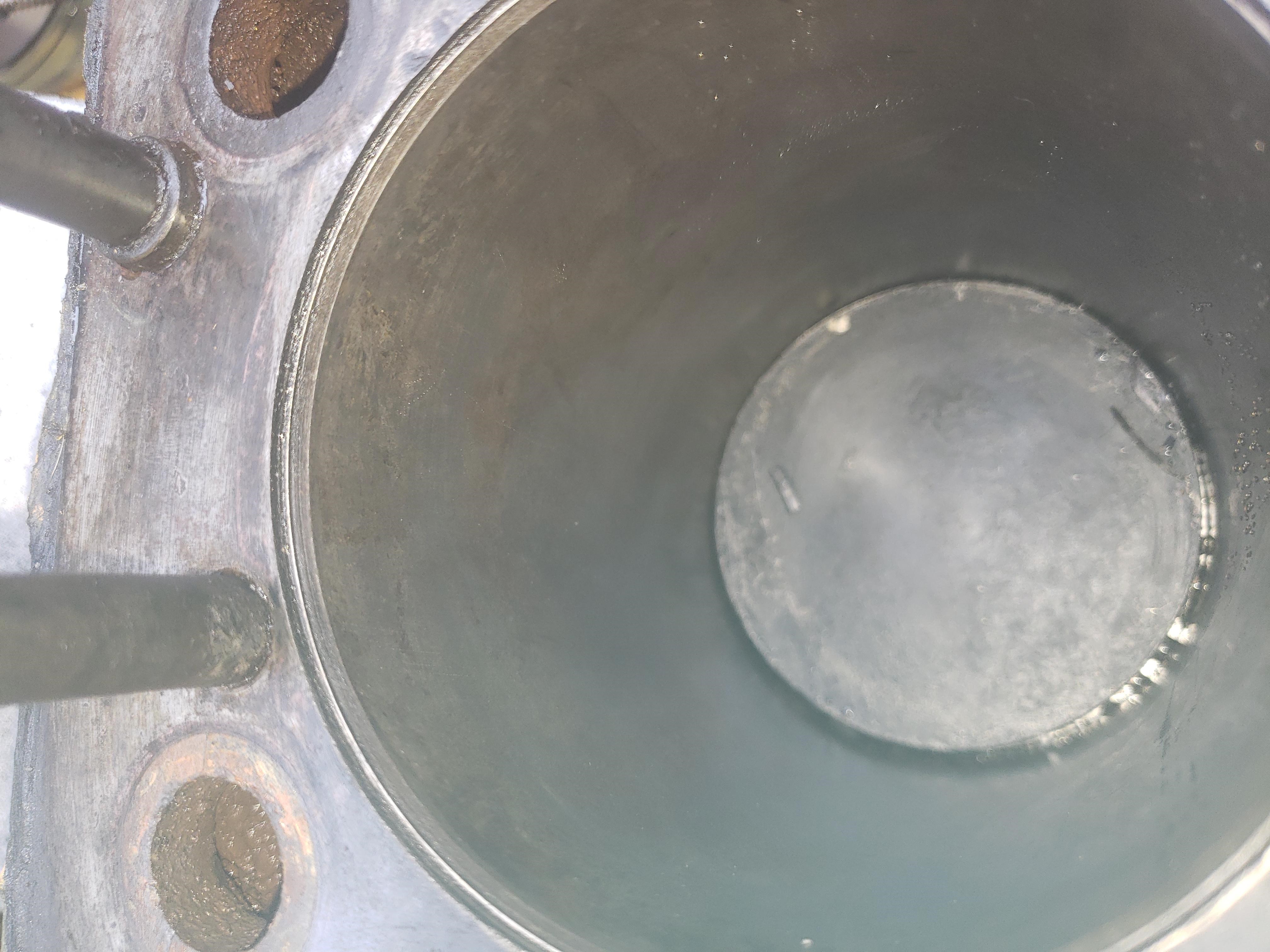

when I took the head off it looked just like ln the photos. There were a couple pieces of the off the top of the sleeve on the top of the piston. I think the sleeve has been loose and moving because the sleeve and the bore it fits into was cleaner than a removed sleeve would normally be when pressed out. I don't think it has worn the bore/water jacket any. It mic's to spec. The engine had a lot of blow by. The engine sounded like it had piston slap, which now makes sense.
This photo shows the left bore without the sleeve and the right bore with a sleeve
This photo shows the bore without the sleeve. There is some rust stains in the bore but it was as clean as you see it.
This photo shows some of what was in the pan. I'm guessing it slid down and the counterweights did the rest. I'm guessing that ring was broke off the top of the sleeve. It could be part of an oil ring off the piston. The engine turns over by hand smooth and easy. I d0nt see any damage in the pan or to the crankshaft. I think it just slid down and the crank broke it up. The head looks good. I'll know more when I dismantle it. I feel a bit lucky with my bad luck. It could have been worst. That sleeve may have been cracked and moving a little with each stroke. I have never seen this happen.

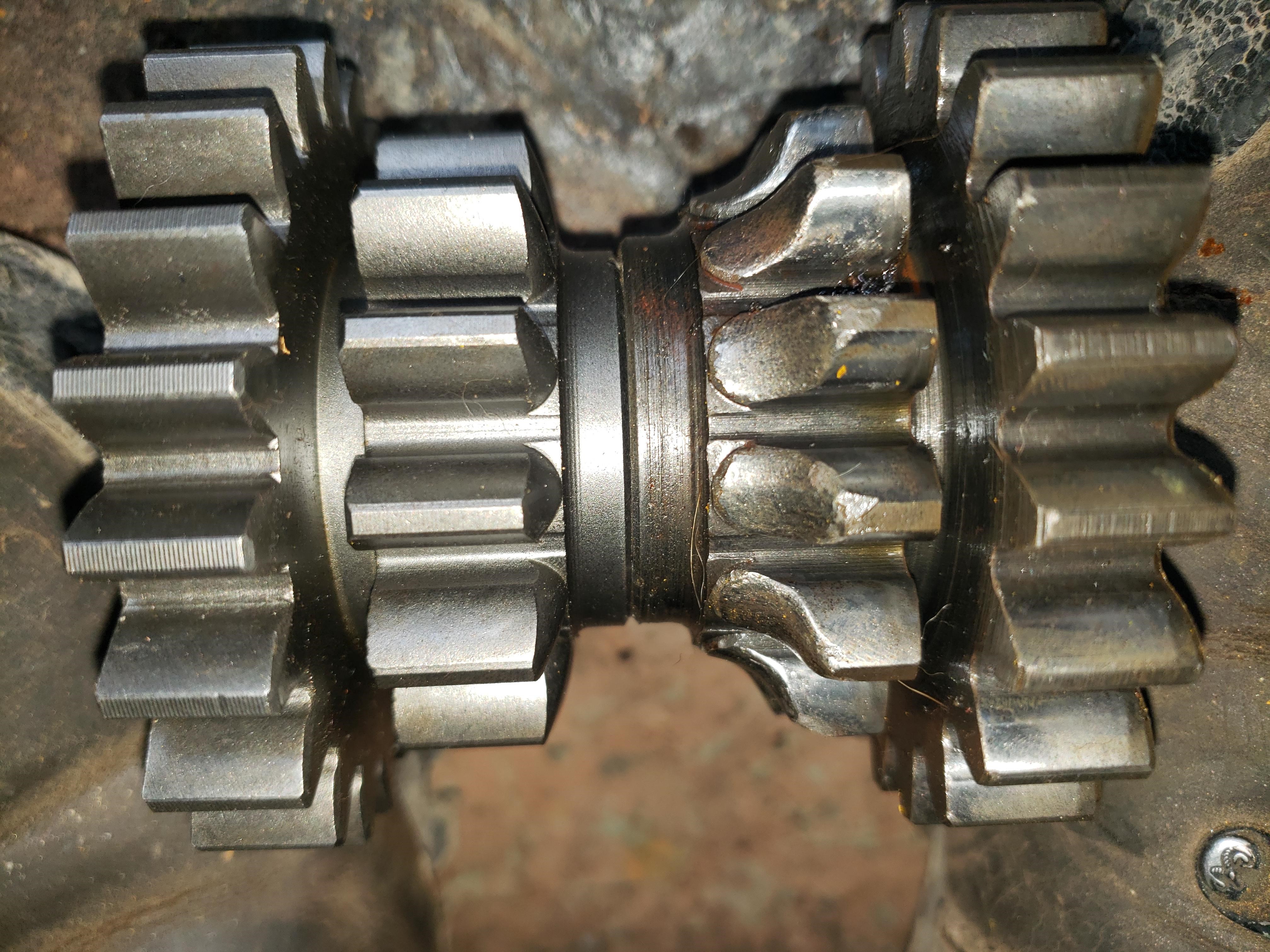

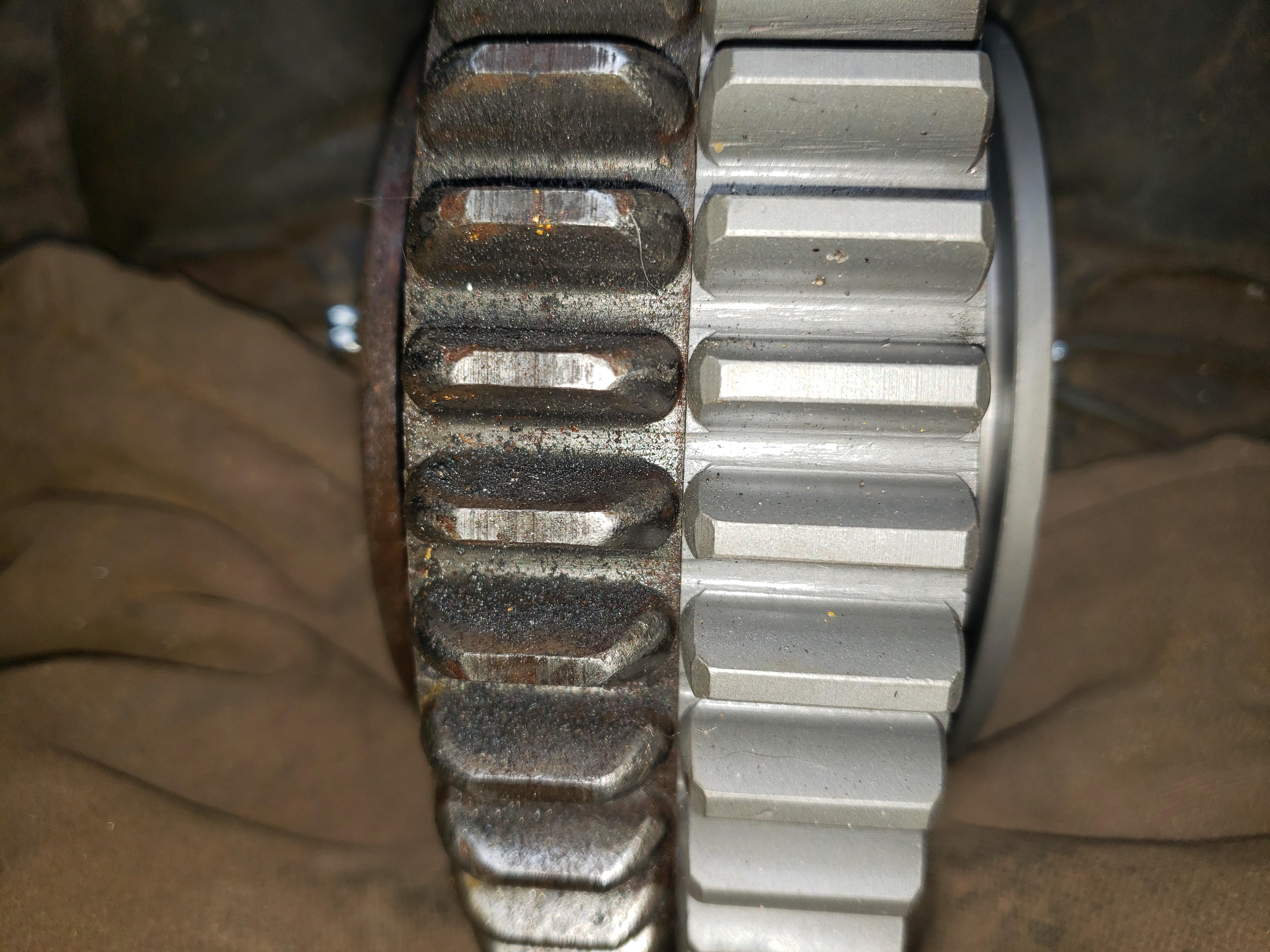

They ground gears in the transmission instead of fixing the clutch. I have never seen transmission gears ground this bad. About $850 on the engine and about $650 on the transmission

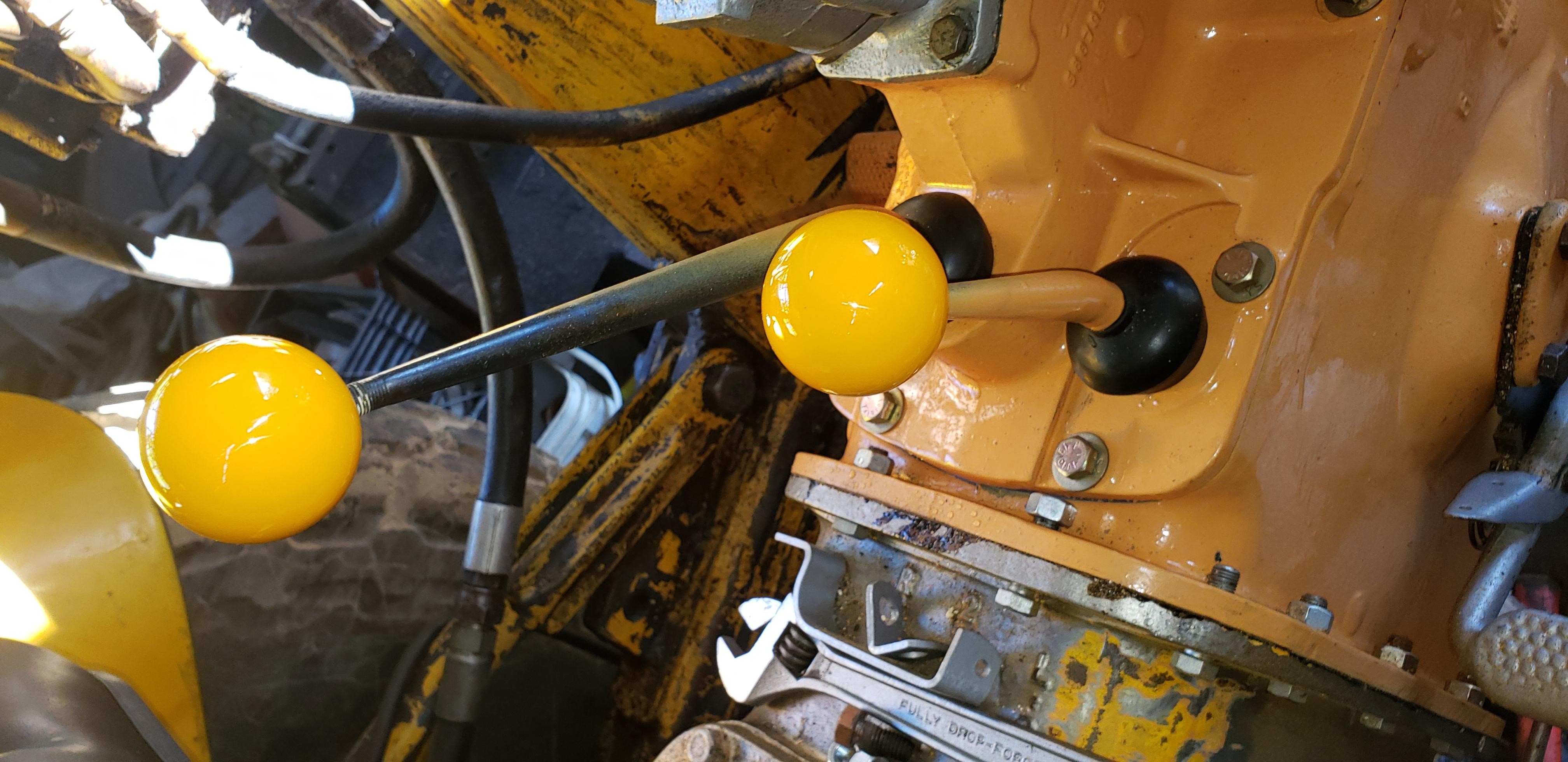

I know the pool ball shift knobs aren't stock but I don't like the small stock knobs. Ill keep the old ones for a buyer if I ever sell it. it will probably be sold after I'm dead. I'm building a dependable tractor for myself.

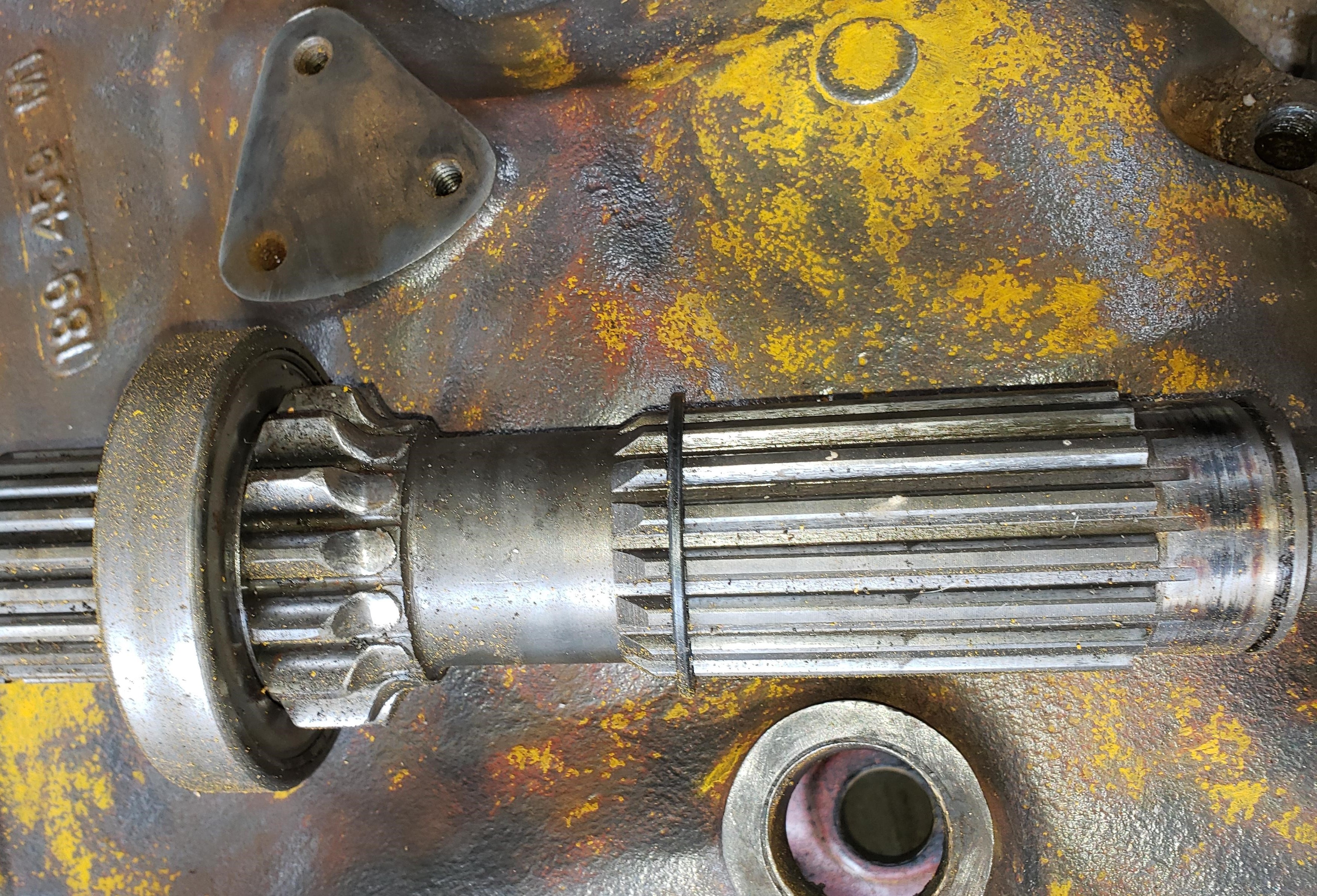

This was not an occasional grinding a gear. There are small chips and fractures in the teeth.
The set screw in the shifting fork was sheared. You could set the peddle properly then it would slip after a little use. They put a new clutch in but missed the real problem with the sheared set screw.. So they just jammed it in gear. That much grinding takes time.

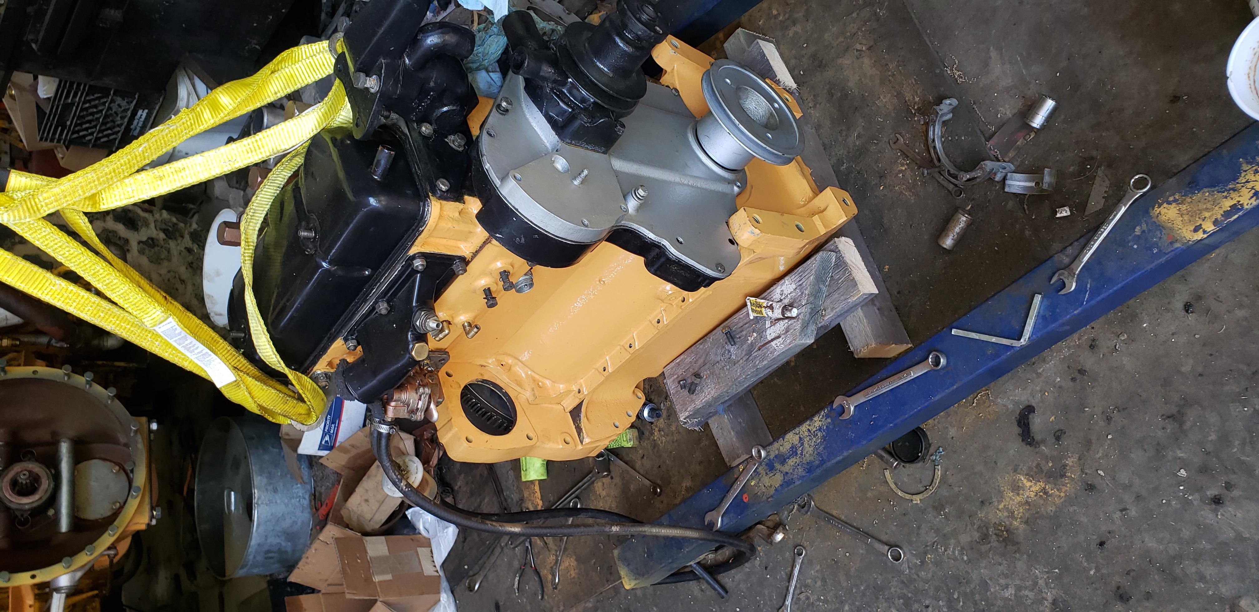

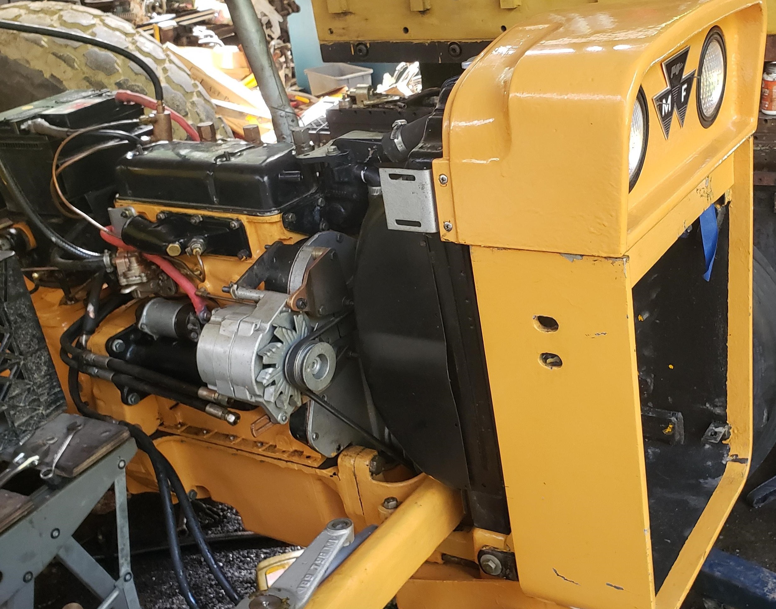

Well I'm making some progress. The engine is running again. My first timing attempt failed. I had to pull the timing gear cover and try again. I think I was 120 deg. out. I have about ten minutes run time. Sounds so good.

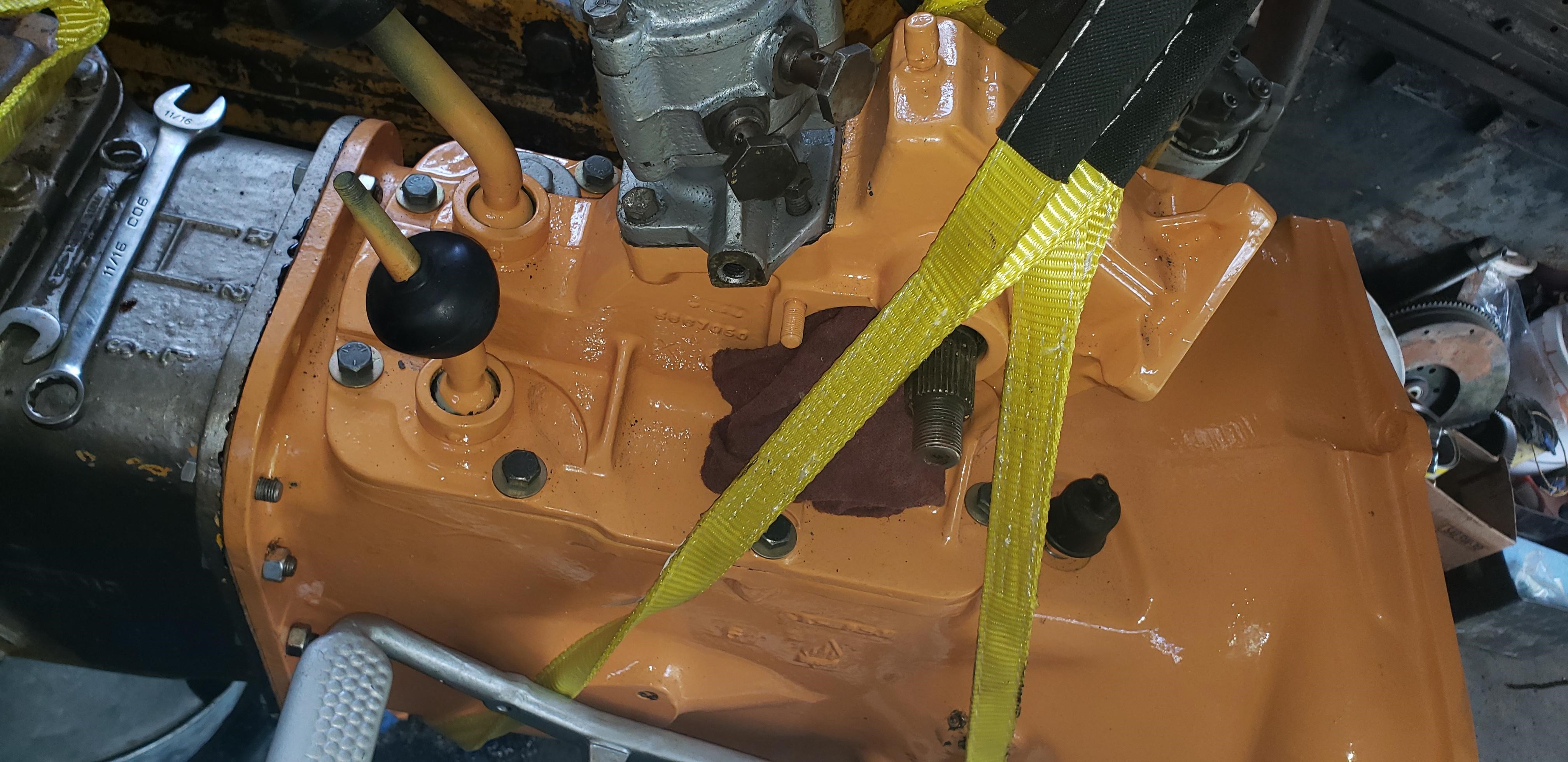

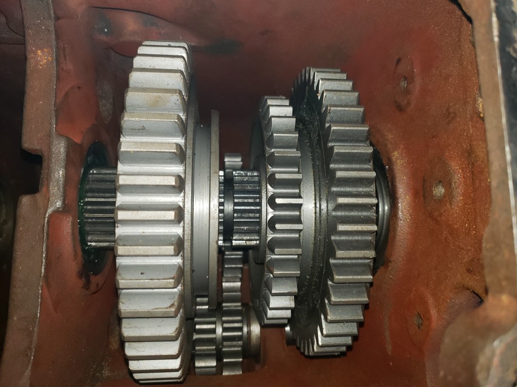

I also rebuilt the transmission. All new gears and bearings. It was on the edge of failure. bearings loose and ground gears.

The set screw on the fork for the throw out bearing was sheared. It appears they may have replaced the clutch but that didn't fix it so they just ground gears.
I spent about $650 on the trans.
From the seat forward there isn't anything that isn't new or rebuilt. Accept starter and alternator.
I'm going to replace bushings and hoses as needed on the backhoe and loader frame. New spindles on the steering
It went from a $3,700 purchase to $6,000. Ill know what I have. I'm getting anxious to use it.
The rear end seems smooth and quite. Planitaries have clean oil.
