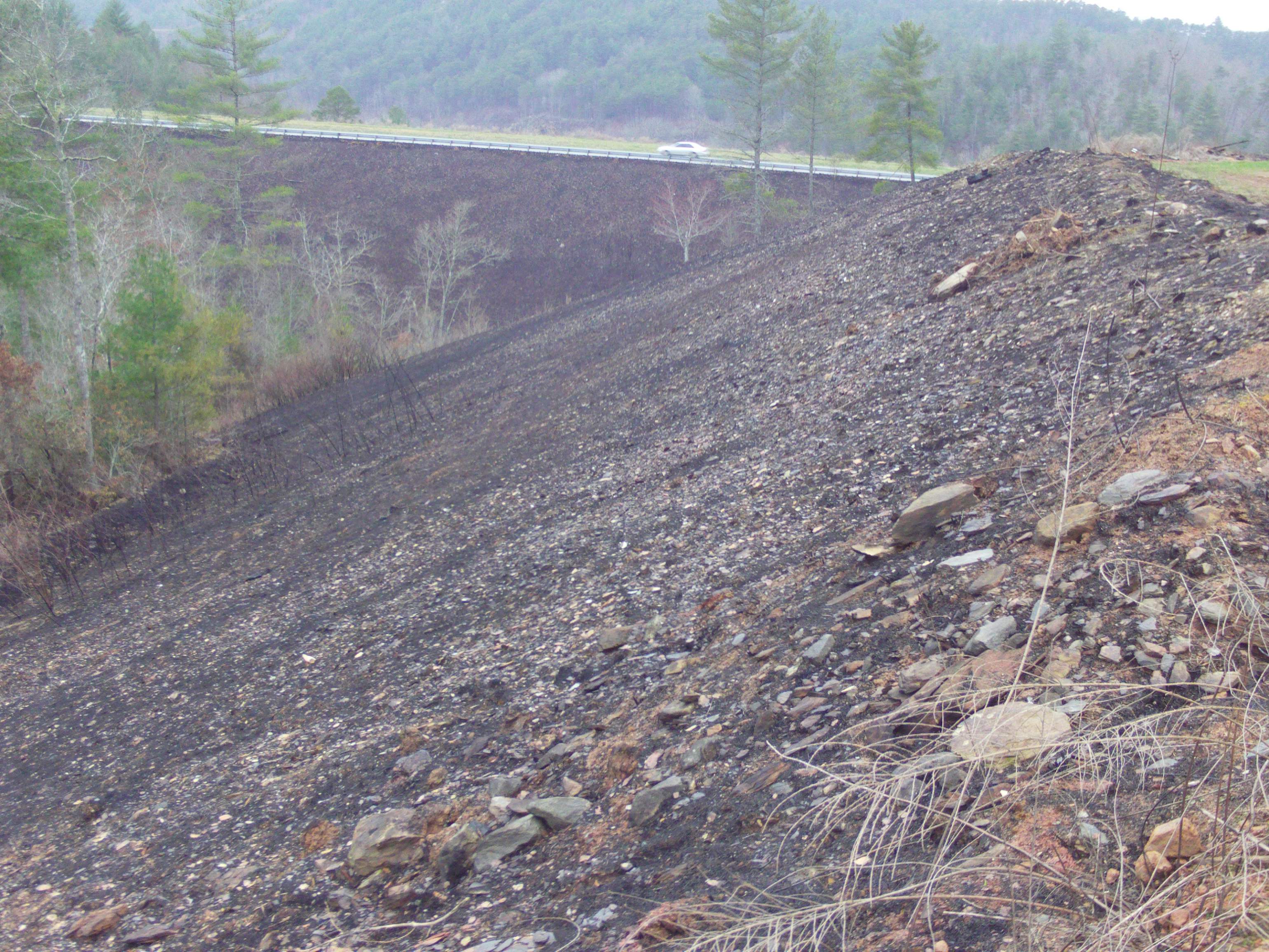

Mudstopper - I'm curious what the scenery is in the right background of your photo - looks man-made and pretty steep?
Jim
   / My 3rd and hopefully last log splitter #86
Jim
New highway. 90ft of fill for the road to set on. FILE0276.jpg and what it looked like last spring when it caught on fire

Mudd - 90' of fill??? there must be some other place looking pretty empty!
