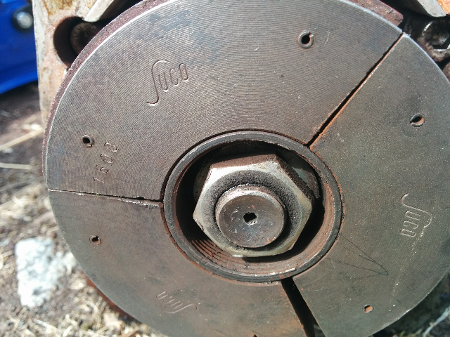

Thats plan B if my clutch on the old engine fails. Now I'm searching for a puller to get the clutch of the shaft.

This clutch looks better:

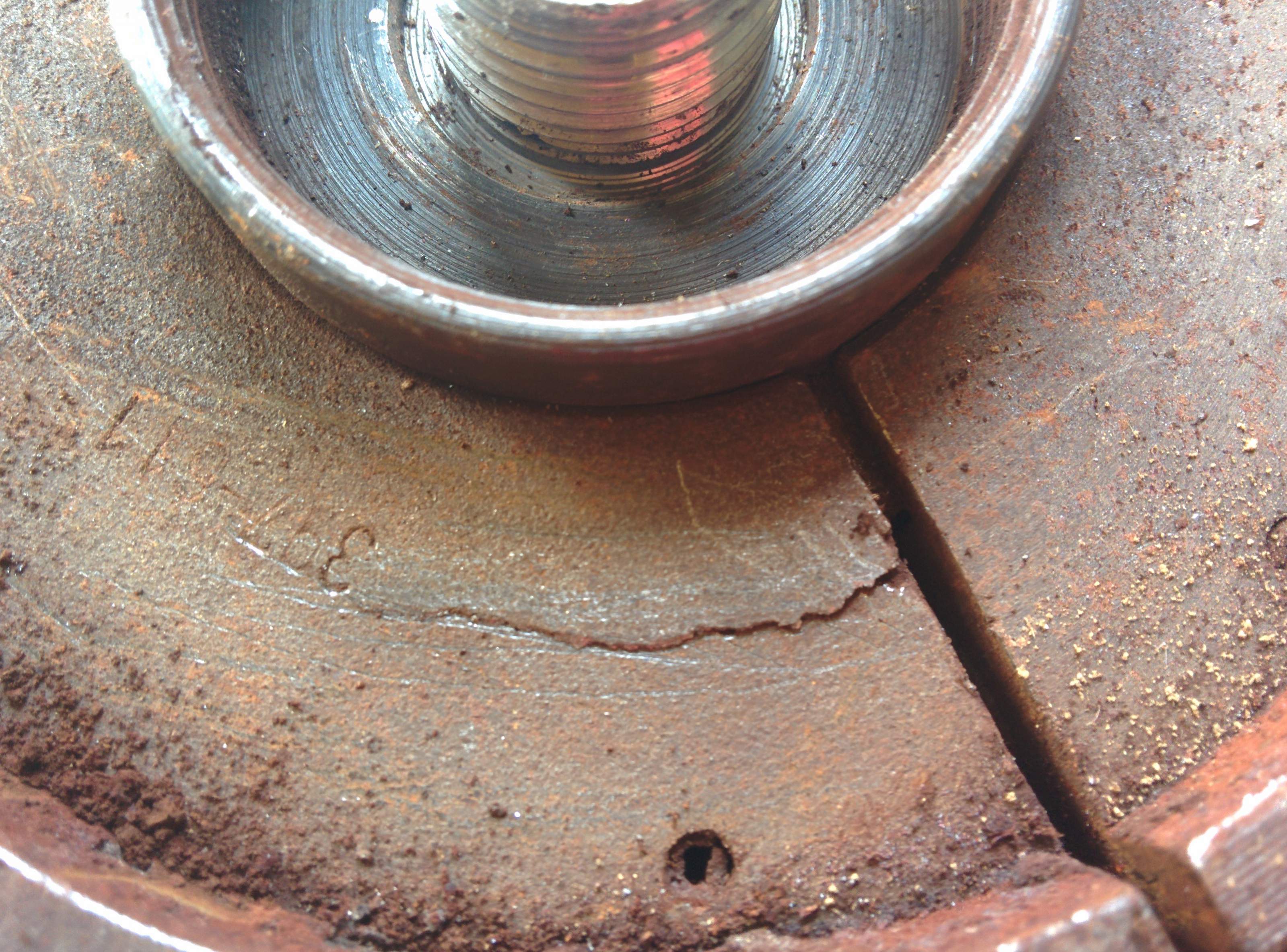

Might be able to weld it, but I think I'm going to rebuild the newest clutch disk.
   / My AEBI AM10 project #28
Bummer, well might as well do it so you don't need to mess with it in the near future.

It cost 200$ to rebuild the clutch with new linings.
   / My AEBI AM10 project #30
I hear you,, good stuff is never cheap. I had to replace one of the planetary assemblies in my Gravely walkbehind it was over 500 for a new one, good used was 100 but I had to wait for one to come up for sale but I have other machines to take up the slack while it was down.
