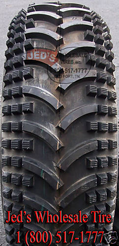

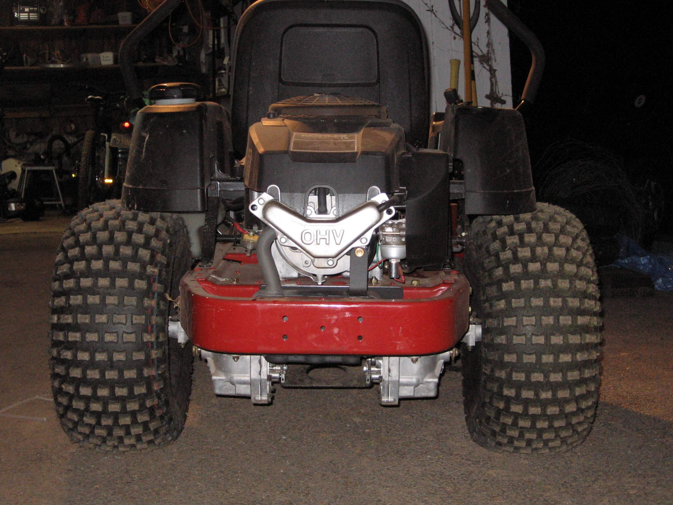

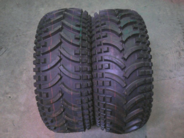

So check this out:
Ive got 8 acres of land with a stream running right down the middle, and last year in PA we had some serious flooding. Places I used to be able to mow safely are now steeply inclined with 3-5 foot drop offs into the creek bed. I dumped my Toro Timecutter into the water when the tires mudded up and slid down the hill. Luckily I was able to jump off in time to avoid a rollover, but that was enough to scare me into modification.
This will help explain how I got to the point I am: I am an avid offroad guy, and an avid VW enthusiest.
Ive used turf saving tires in commercial landscaping, but most jobs dont have creeks in the middle. Im sure you guys know that when a zero starts sliding theres no stopping it. So Im looking at my 84 Honda ATC, and the answer came to me; Big Red has 8" rims. My Toro has 8" rims. Big Red never slides or gets stuck...
So I spoon on some new 22X11X8 tires onto the Timecutter. But until I put it all together I didnt consider the clearence... stupid me. The knobbies bite on the frame and deck linkage. So I measure the lug offset...4X100. Standard VW size.
So Ebay finds me some 1 1/4" wheel spacers, plus a universal 1/4" spacer to move the rubber out, and luckily the wheels were offset to begin with, so I fliped around the wheels and bolted it all together!
Now I can turn on the side of hills, come to a full stop going downhill and reverse back up it! The little Toro even wheelies up hills if I ask it! This wasnt a cheap modification, but it works wonders, and best of all Im not going to get killed trying to keep the weeds down.
Let me know what you think; I think it looks mean as ****!

That's the same model Toro I have. But I don't have much slopes to contend with. And I bought mine because it will fit through a 3' gate and I don't think your new tires would make it.:laughing: But otherwise, yep, sure looks nice.
   / My all terrain Toro! #4
You might have a bit of trouble with the rear axles/bearings because of the extra distance the tires are offset compared to the originals, but I doubt it and I think the safety factor outweighs that concern by a wide margin. :thumbsup:
That thought was not lost on me, but bearings are cheap and the hydro pumps dont cry at all when running it, so Im convinced its as reliable as factory. The low running pressure of those tires act like suspension as well, so I think in the long run it may be better for the transaxles to take up alot of the bumps and hits they would otherwise take with higher pressure tires.
