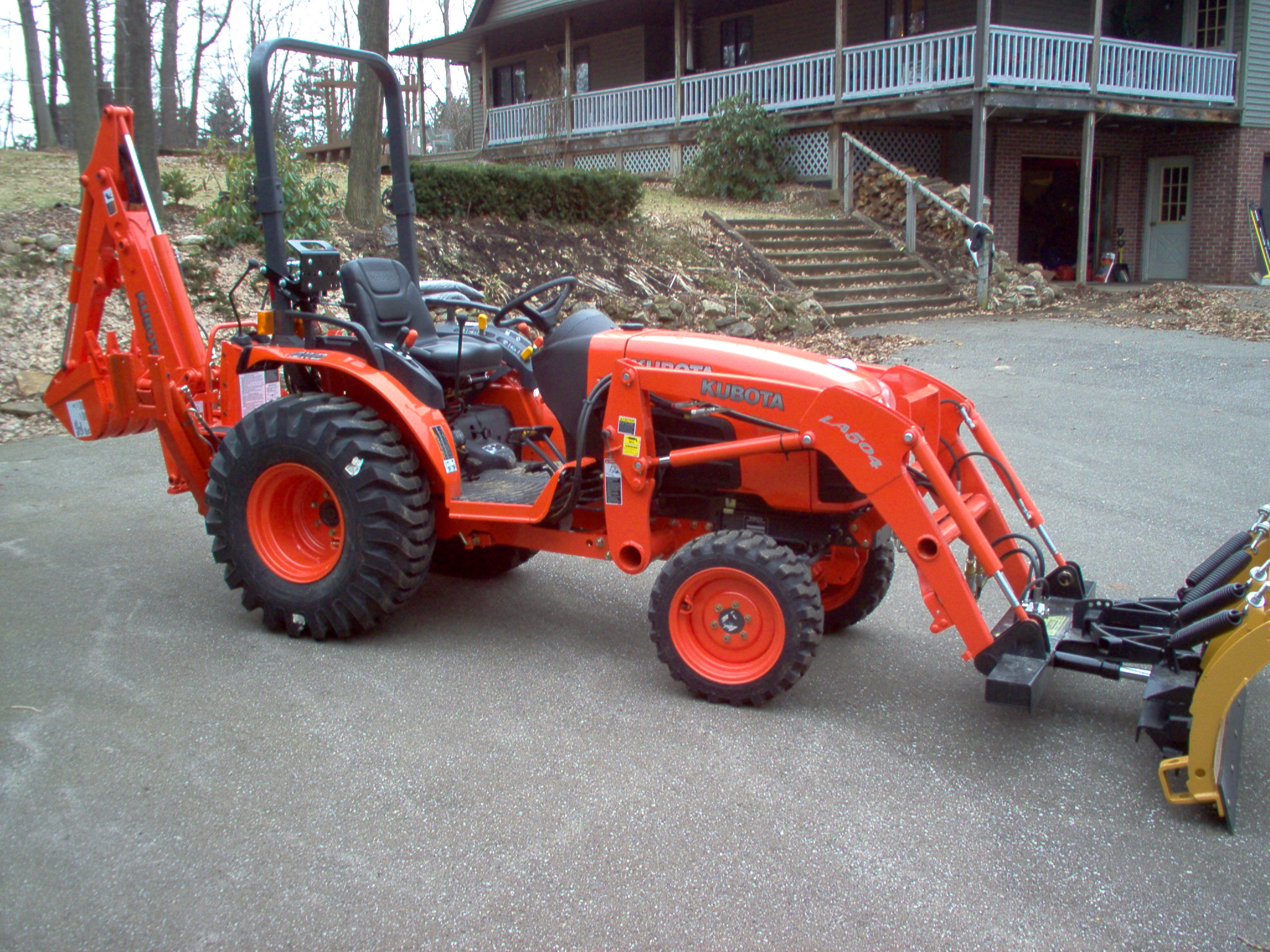

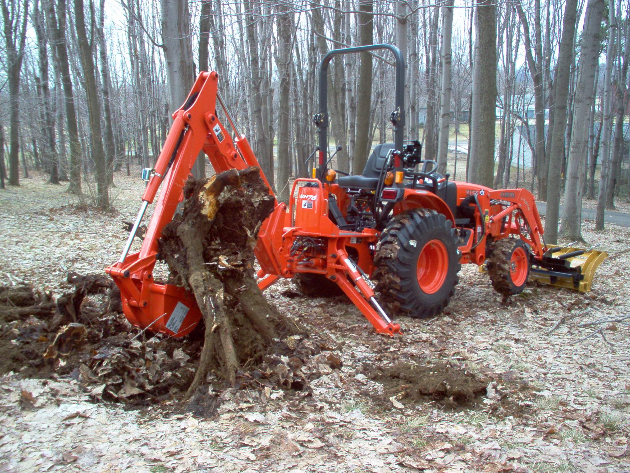

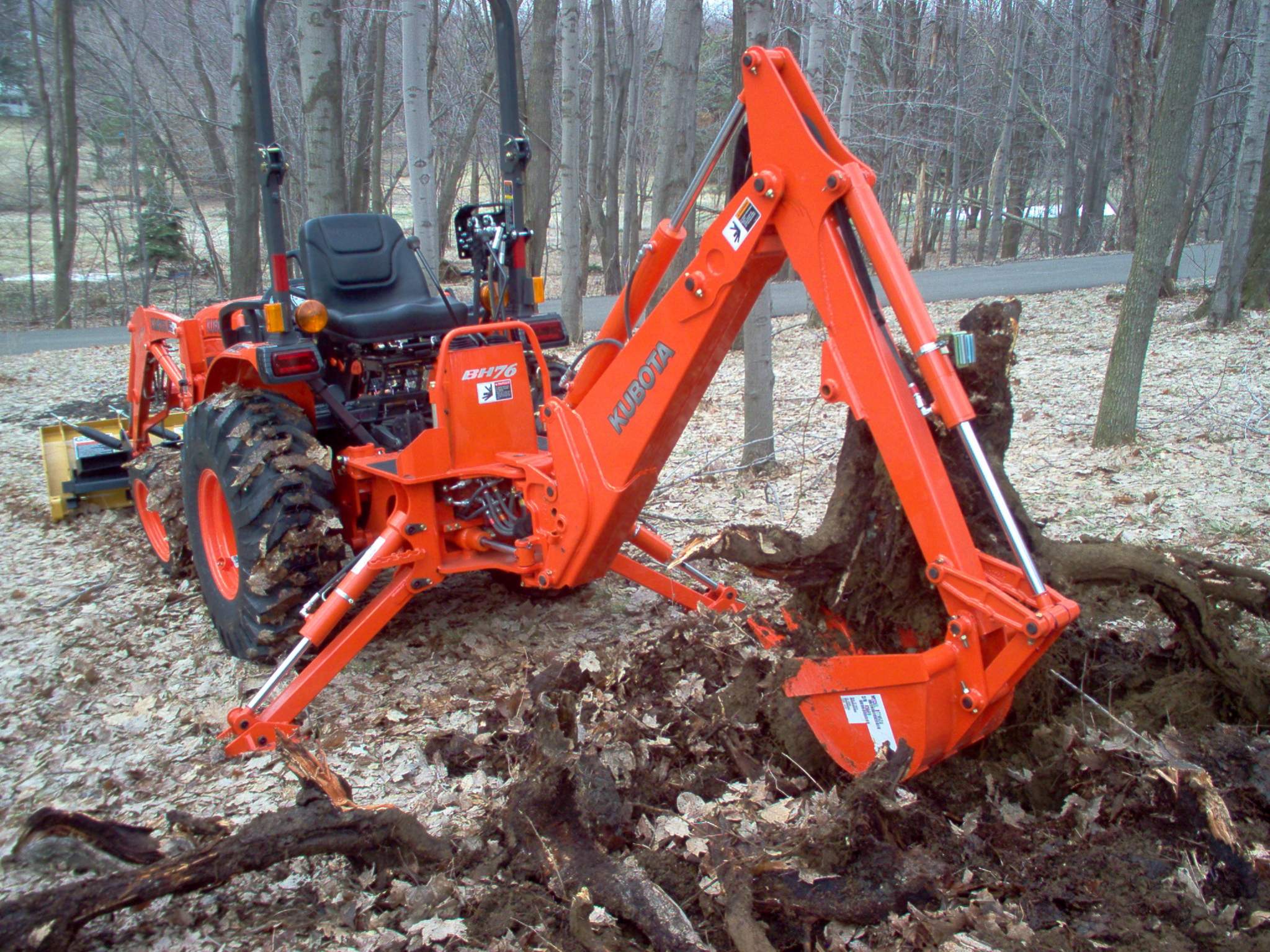

The dealer got the back ordered hydrolics for the curtis plow blade installed today, and I had them install a bh76 with the swivel seat. The seat is easer to deal with than I would have guessed.
I added pictured for your viewing pleasure.

Nice looking machine. You have to get more dirt and mud on it though to show its worth the money. Wish I had a Hoe on mine... Looks nice. Enjoy it.:)
   / My b3200 new prosthesis #6
That stump jumped out of the earth in FEAR :cool: What a great looking setup.

Now why did you have to go and post pics :mad: Here I am, in my mind, all set to upgrade to a smaller B and you go do a foolish thing like that. I have been drooling all night :). Your set up looks auesome - you are sure to have a lot of smiles per mile for many years to come.
BTW - I see you have remotes - does it interfere with your seat or yourself when you use the BH?

Its a 16" bucket, still looks a little small to me, but works well,
I'm not all that happy with the hydrolic setup for the plow, I expected a small toggle switch like a plow truck, if I want to take the fel off I have to remove all the lines out from under the tractor, and I can't use the hydrolics for the plow with the bh attached. Plus I wasn't expecting the large hydrolic control on the ROPS.
To answer jambx's question, yes it gets in the way of the seat when I turn it in one direction but not the other.
If any body that needs pics of any part of the b3200 let me know.
PS, I'm very happy with the b3200 and the bh76.

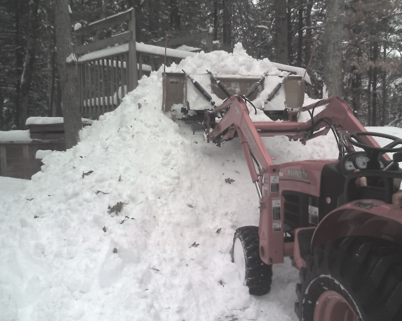

I have a power angle Curtis blade on my B3030. I have the Kubota quick attach which allows me to switch between the bucket and plow in only a few minutes. I connected the power angle to the rear remote. The hoses are tywraped in place with quick disconnets by the cross tube brace of the loader in the front. When I need the rear remote I leave the hoses in place and just disconnect the couplings at the rear remote. I don't know much about the B3200 but you may be able to do something similar. The backhoe is always operational.

Thanks for the input, the hydrolic supply for the bh is the same for the plow, so I have to unhook one to use the other. I assumed that I couldn't change the lines with the bh attached but I may be wrong, I will give it a try.
also, since I plan on removing the fel in the summer when I start mowing I will have to remove the full lengh line, I can do it but there seems to me there should be a simpler way, like a small electric pump attached to the plow like on a pickup.
