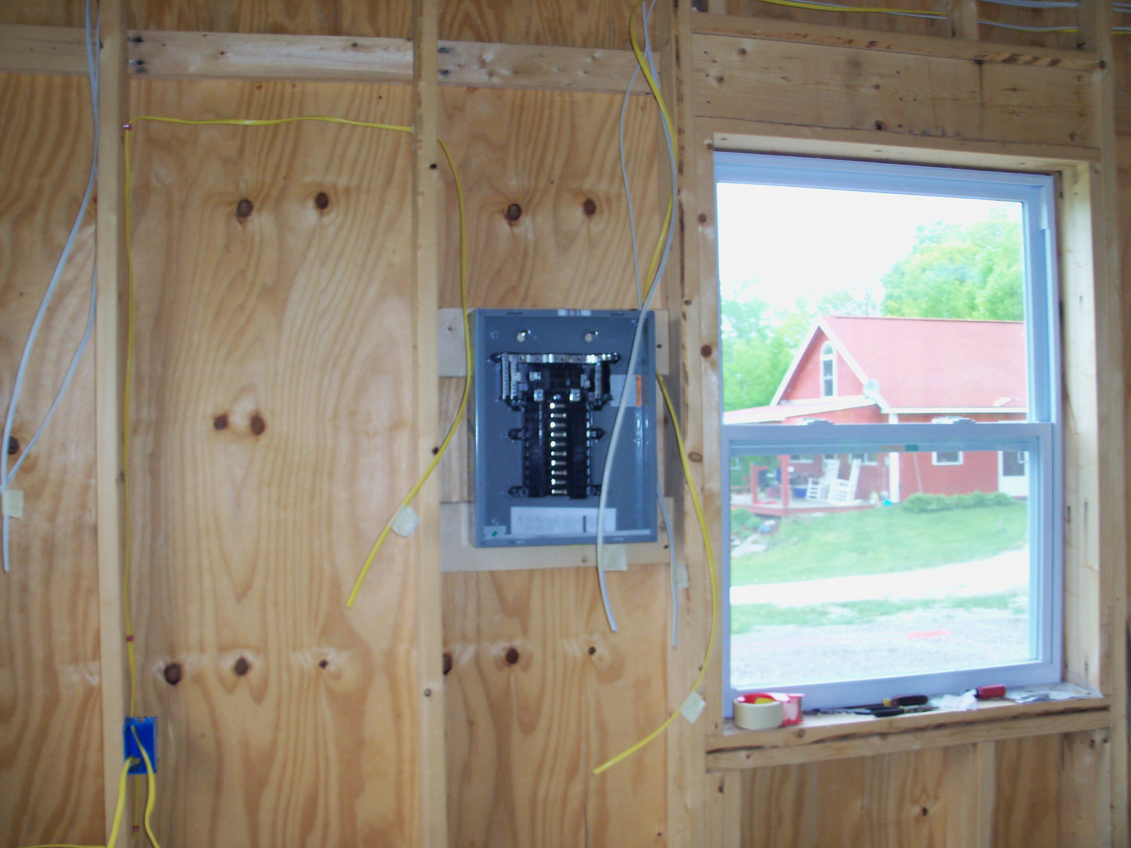

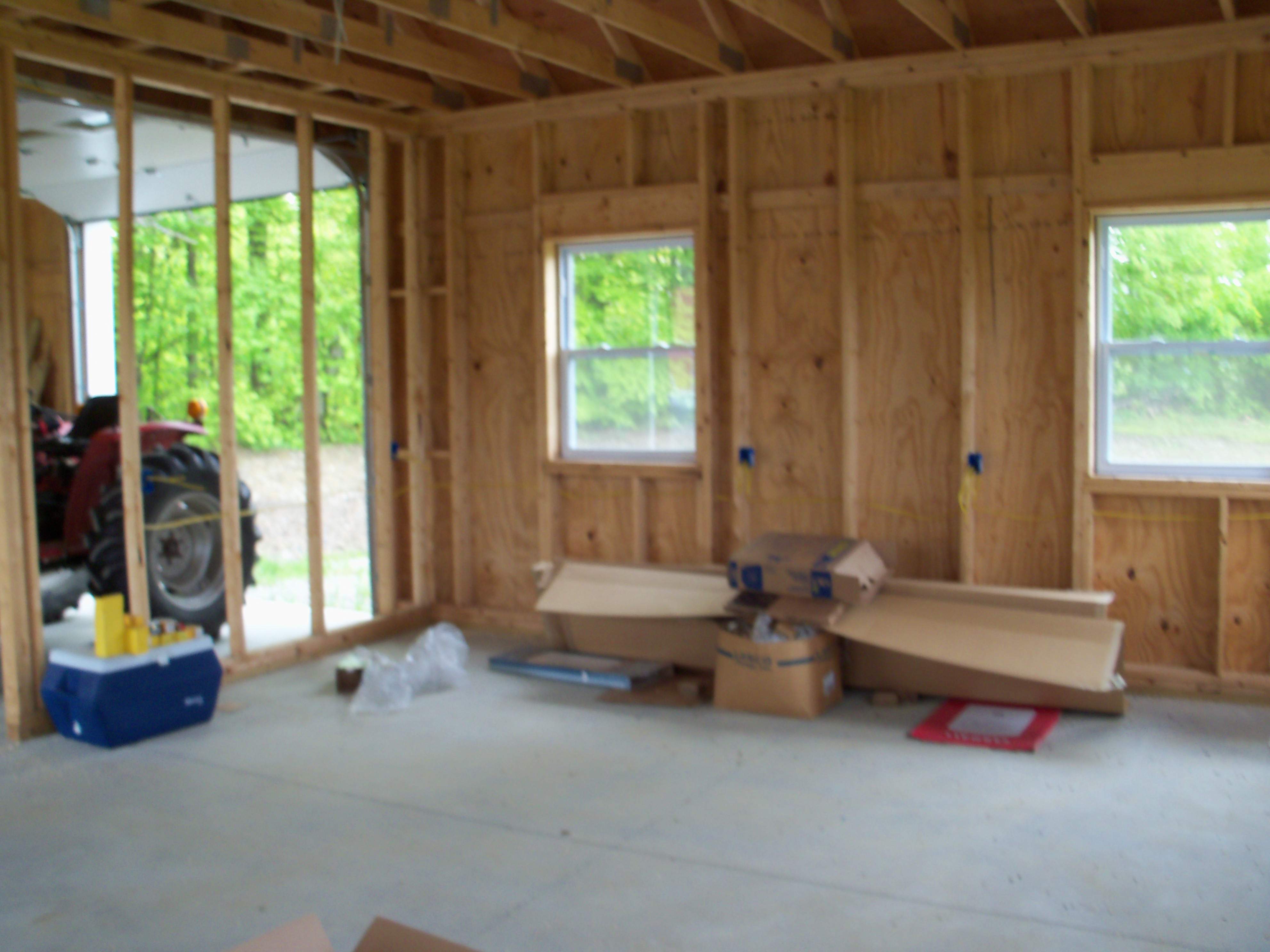

Ive finally got some time to devote to this project, so we are trying to tackle the electrical rough in, boxes, runnin the wire and placing lights and switches etc...
The last few days we mounted the 100 amp sub panel and began running wires. I bought 500 ft of 12/2 and 500 ft of 14/2. Thought that would cover my outlet and lighting requirements for this size building.
I ran 12/2 for my 120 v shop outlets, and the same in the garage section on its own circuit.

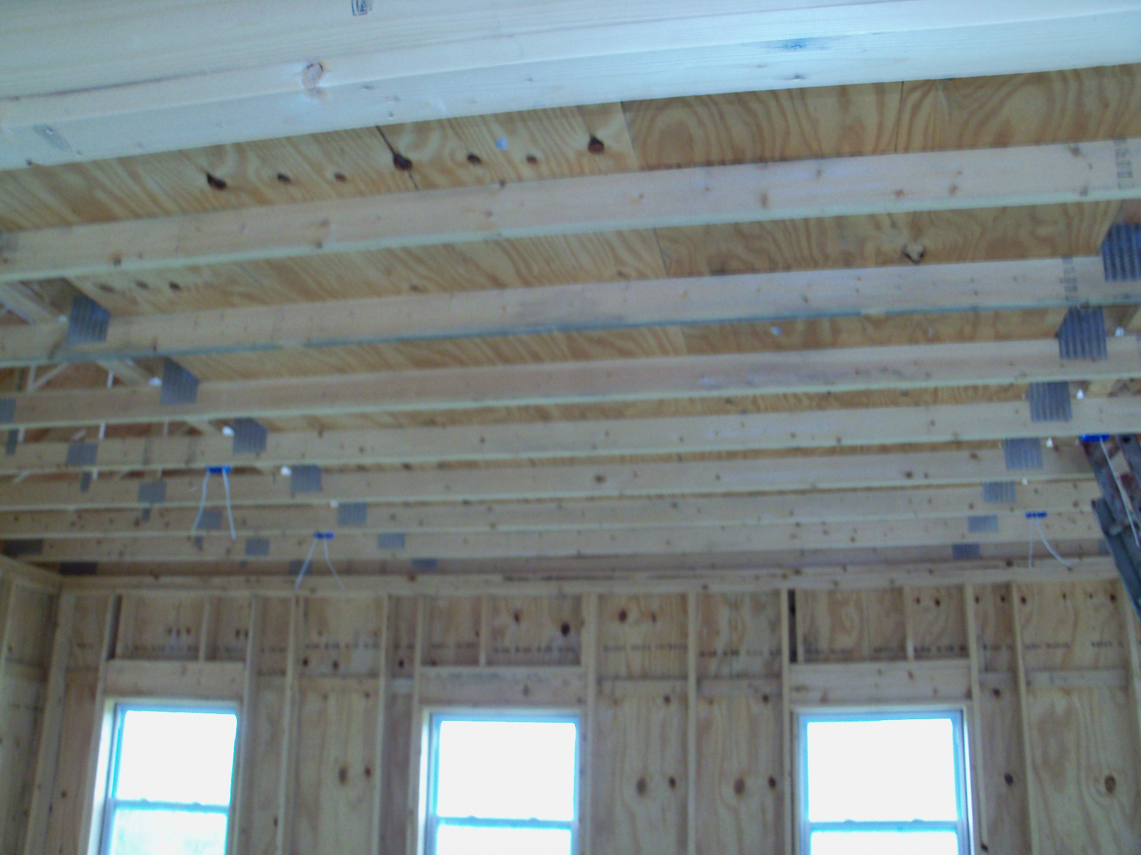

For the shop lighting, I ran the 12/2 to 6 ceiling mounted boxes, which will power 12 flourescent fixtures. In the garage I will do the same but wont use that many lights.
As you walk in the shop door, there will be a 3 gang switch box, one for shop lighting, one for the exterior lights, and another for the garage section.

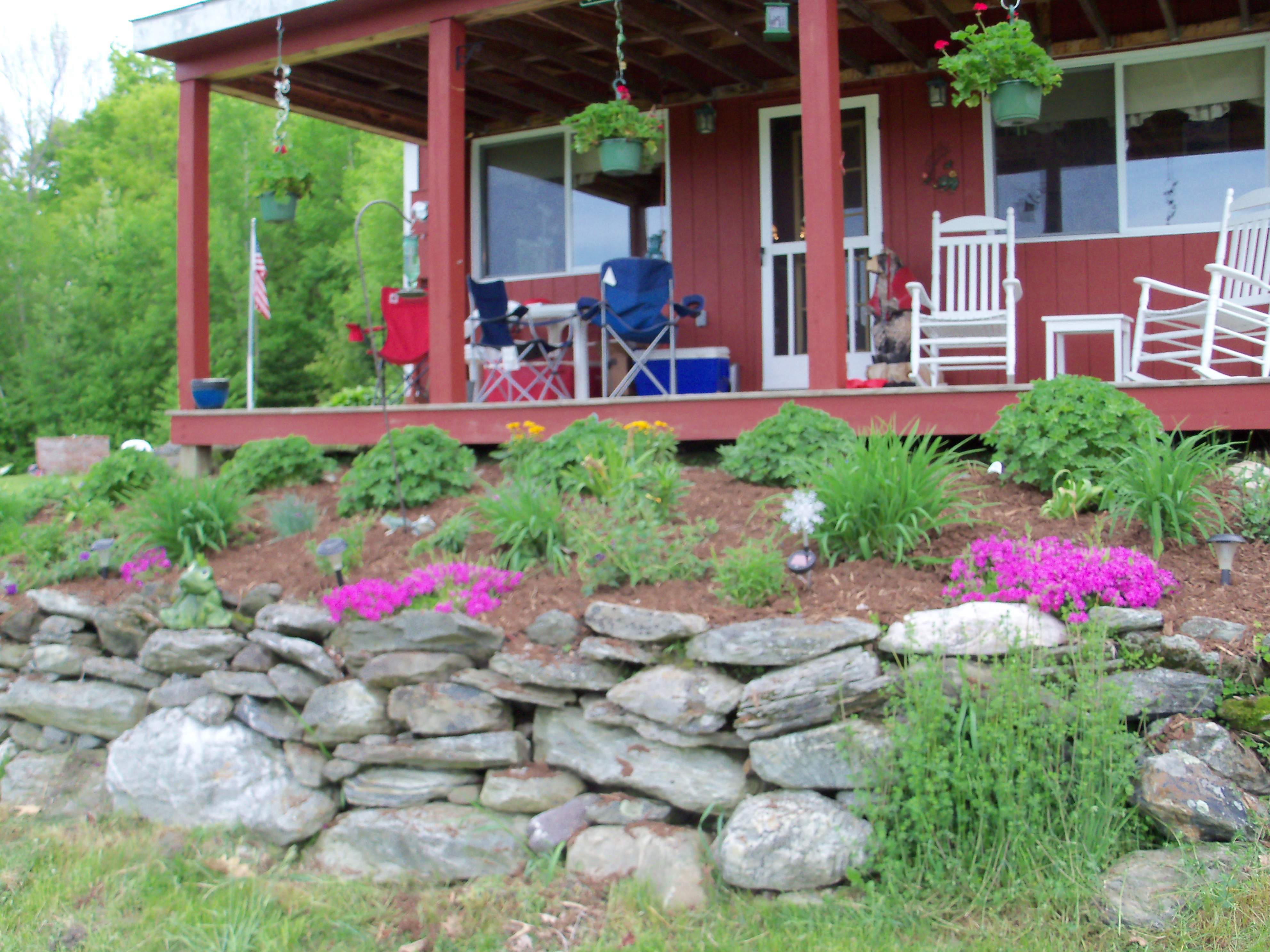

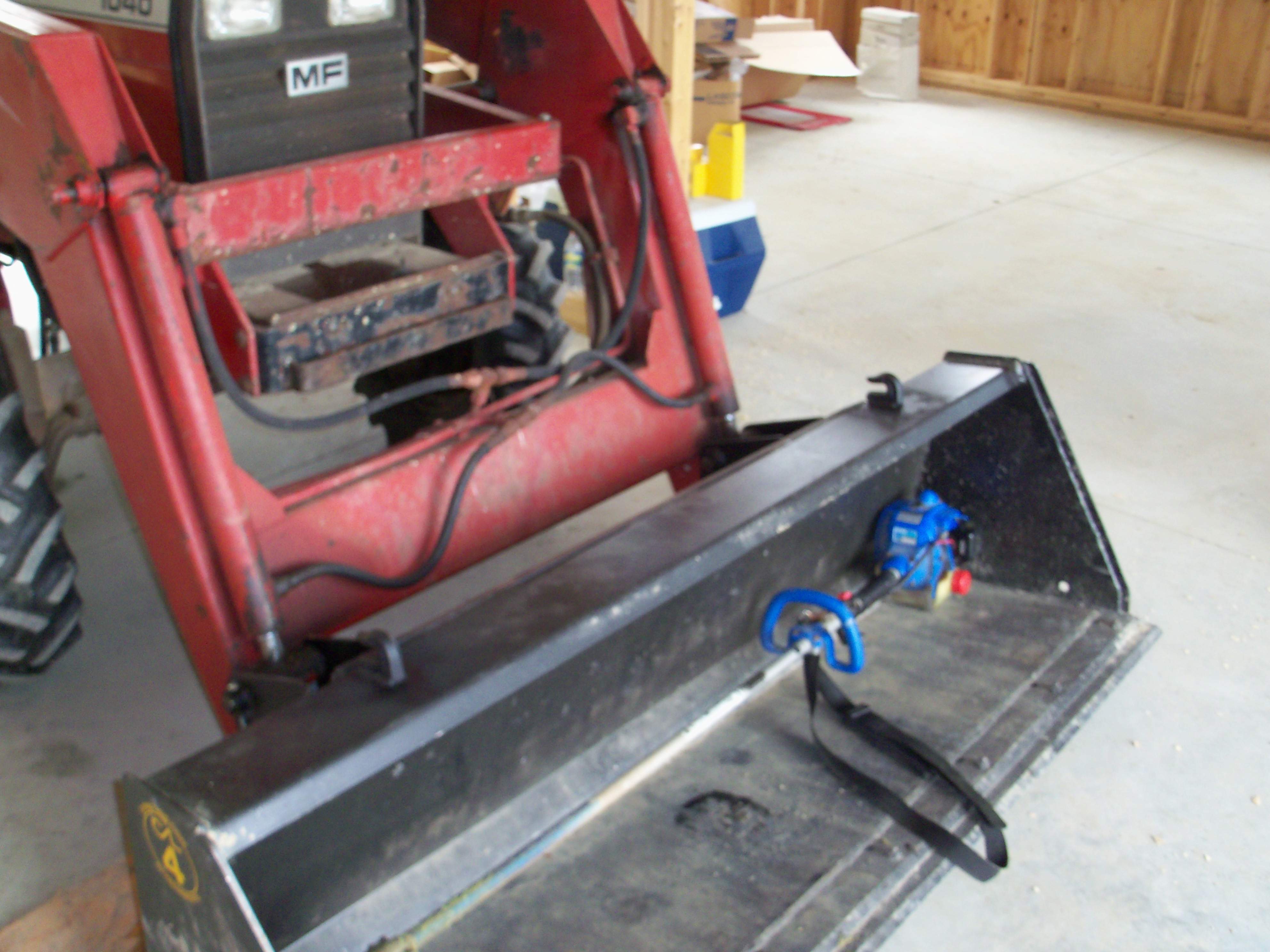

My neighbor was also nice enough to weld some hooks on my new bucket, and there is a bonus shot of Kathleens perennial garden just getting started. :)
