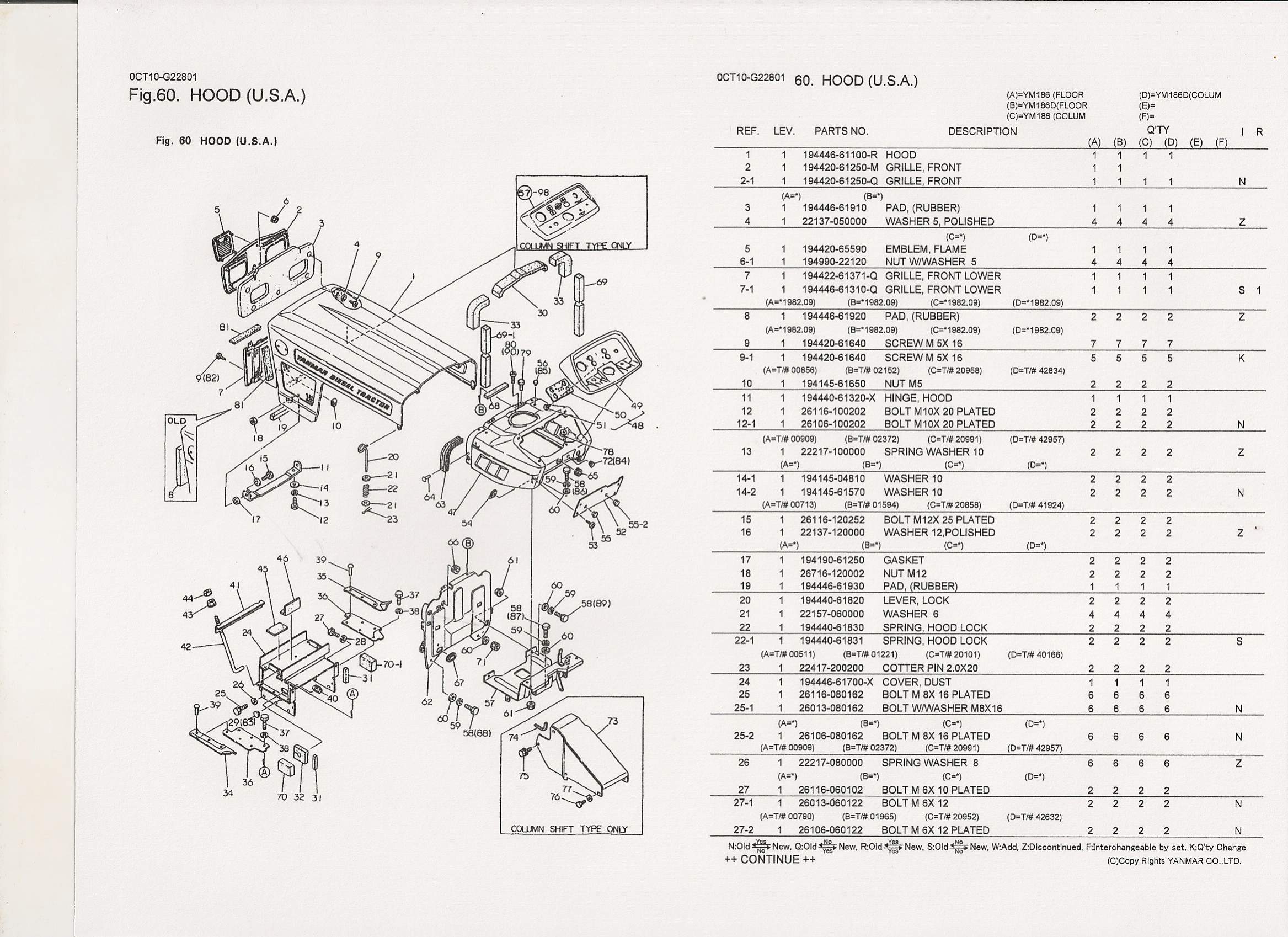

I think that I located the module bolted into the under side of the dash. But can't seem to find an easy way to get at it. Do I have to pull the dash out, and how?
   / My blinker module died on my 186d. #2
Looking at the 186 parts manual it shows to have a metal cover (#52 on Figure 60) right under the steering wheel that would come off and allow access. Just looks that way, maybe not in reality. :D
I removed #52 on my 276D to replace the ignition switch. It's easy. I have no idea if it will allow access to the blinker, tho.

I removed #52 [dash lower panel] on my 276D to replace the ignition switch. It's easy. I have no idea if it will allow access to the blinker, tho.
The removable panel allows access to the ignition switch. I pulled the switch on my second YM186D after I bought it, as part of tracing why it has horn but no headlights. Likewise that panel makes the headlight switch accessible. But the flasher module is attached to a tab that will be difficult to reach. If this Yanmar has the shifter down on the transmission instead of through the dash next to the flasher then it may be easier to reach.
